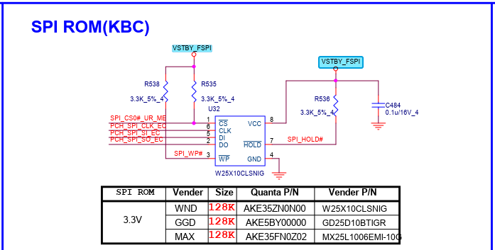

is it normal to have this bios voltage? Board : DA0Z8GMB8F0 REV :F
  • kalilinux25
    • Mar 2018
    • 2093
    • ZAMBOANGA SIBUGAY
    Hi I have a board with no display I encountered that I only have a 1.7v on the pin 8 of the bios chip . Is it normal? Hope someone can clarify it , thanks ..
  • mon2
    • Dec 2019
    • 14713
    Re: is it normal to have this bios voltage?
    I think that you are confusing the MAIN bios with the KBC bios.
    KBC bios serves a different purpose with its firmware and services your keyboard, etc.
    The bios in the schematic is a 3v3 device but you are measuring a different bios on the logic board.
    The main bios may be a 1v8 device as you have measured and this is ok.
      Thanks for the clarrification sir ,
