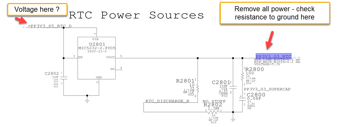

    A little questionne , i found PP3V3_G3_RTC lower than 3.3 its 2.7v ,
    since i readed that is requireed for PM_SLP_S4_L
    just for information the other misuration :
    C7771 Pin 1=1.08v
    PPBus_G3H 12.6
    PP3V42_G3H 3.4v
    3V3_S5 present

    See attached.
    Check the voltage IN to the load switch for the PP3V3_G3_RTC rail.
    Then remove all power and check the resistance to ground of PP3V3_G3_RTC .
    Post all readings.

      Re: a1286 820-2330 no power
      Voltage in 3.4
      resistance 12mega
      diode mode on pin 5 0.516

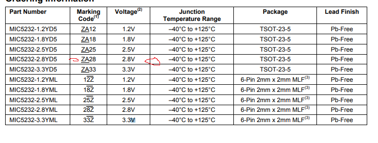

        this is the datasheet seems to be the correct voltage at vout 2.8v
        • mon2
          • Dec 2019
          • 14085
          Good job on the clarification. The part number of the ldo is in the data sheet but the text is showing as 3v3 output so assumed incorrectly that this was a load switch =like a relay.
