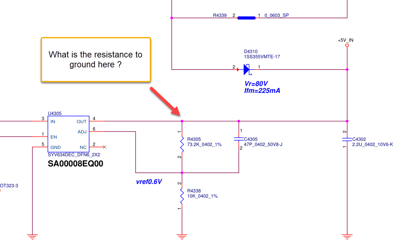

                    • mon2
                      • Dec 2019
                      • 14672
                      Re: Fe490/Fe590/FE480 NM-B911not charging
                      Good that the USB C meter is working.
                      See attached on the same U4305 LDO.
                      What is the resistance to ground for the output of this LDO ? (remove all power; meter in resistance mode)
                      When you injected 5-10v to the INPUT of this LDO, does the logic board boot normally ?
                      You have to be careful on the INPUT voltage as we do not know what is the max voltage for this Silergy part. So far, unable to locate a datasheet for this component. For this reason, keep the INPUT @ ~6V max and the buck LDO should spit out +5v if enabled.
                      Note that this LDO has an ENABLE function @ pin #1 to turn ON. The 100k on Vin should support this turn ON feature.
                      • Dinneke
                        • Apr 2014
                        • 154
