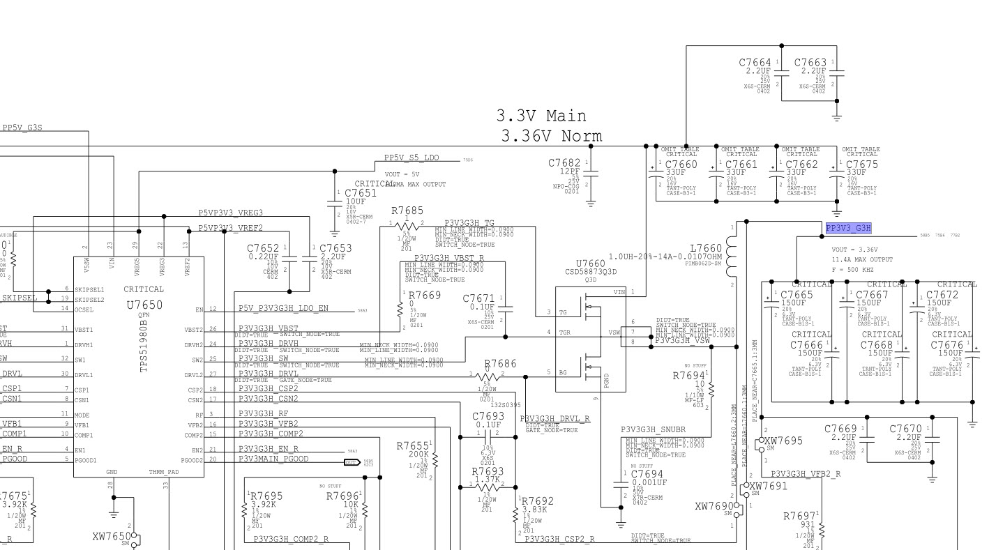

    Hello, I have an 820-01949 Macbook Pro that has MAJOR liquid damage. Luckily, the CPU and T2 seemed to have dodged it somehow. Initially, it only got 5v on the charger but I replaced U7000 and now I get 20v but not consistently, though generally if I just let it sit for a few minutes it goes to 20v. Still going through and fixing pads so it could just be a poor connection somewhere. I don't have much experience with T2 models but luckily it seems they are basically the same as non-T2 USB-C model. I ran it through my ultrasonic cleaner to help clean up the board.
    Input: 20v 0.00-0.01 (completely dead)
    PPBUS: 12.35v
    PP3v3_G3H: 0.98v (not sure how CD3217 is negotiating 20v, runs off PP3v3_G3S maybe?)
    PP3v3_G3S: 3.4v
    PP5v_g3s: 0v
    I have already replaced:
    U7000
    U7650
    U6903
    U7660 (gets 12v but only outputs 0.98v even after replacement)
    Not sure where I should go on this one, luckily it's a personal board for learning more about T2 models so its not a rush.
    Thanks for any help!

        PP3v3_G3H: 0.98v
        Remove all power. Meter in resistance scale.
        Measure the resistance to ground of L7660, pin # 1.

              Re: A2251 820-01949 No Power
              Resistance is ok.
              Do the LDO rails work ok for U7650 ?
              PP5V_S5_LDO
              P5VP3V3_VREG3
              Voltage of P3V3G3H_EN_R ?
                      Well, I made a mistake. I rebuilt the whole U7000 area as it was totaled from corrosion and when I put new resistors on for R7015 I had it positioned the wrong way. CHGR_AUX_DET wasn't getting PPDCIN_G3H and was just connecting back to itself and only just noticed that when looking at the boardview and schematics.
                      Fixed that and now the charger is going nearly instantly to 20v 0.00a 100% of the time.
                      Current readings:
                      PPBUS_G3H: 12.35v
                      PP3v3_G3H: 0.98v
                      PP3v3_G3H_RTC: 3.4v
                      Now for what you asked for earlier:
                      PP5v_S5_LDO: 0v
                      P5VP3V3_VREG3: 3.3v
                      P3V3G3H_EN_R: 0v
                      Extra Readings From U7650
                      P5V_P3v3G3H_LDO_EN: 0v
                      PPVIN_G3H_P3v3G3H: 12.35v
                      I'll keep messing around with it tomorrow, I hope this isn't an issue with a broken T2
                      • LugNuts
                        • Sep 2020
                        • 9
                        Got it to start powering up!
                        I was looking through the schematics and boardview, found a resistor "R8050" that delivers PPBUS_G3H to PMU_VDD_HI. From what I understand now that I got it working (almost) is that T2 has something to do with creating PP3v3_G3H, not like the old non T2 boards that had a dedicated IC for that.
                        New Readings:
                        PPBUS_G3H: 12.6v (was 12.3 due to bad resistor "R8050" and T2 boosted PPBUS to 12.6v)
                        PP3v3_G3H: 3.4v (I was trying to find this source for so long when it was stuck 1v)
                        Now the board gets 20v and starts some sort of boot process, T2 turns on, smaller die on CPU warms up (no noticeable heat, seen through thermal cam)
                        Goes 20v 0.06a then climbs to 20v 0.35-0.40a while T2 and CPU do something then it drops back down to 20v 0.06a. Maybe SSD rail isn't working or another rail is having issues on start. I am just glad to have some sort of progress on this and wanted to post an update for anyone who may have a similar issue in the future.
