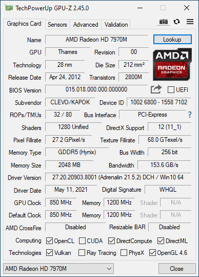

    amd 7970m - error 43
    laptop - p170em with modded prema bios.
    gpu also was bios modded with higher clocks, i flashed with "stock" from techpowerup, but didn't helped.
    I don't get this error with old drivers: v14-4. v12.
    Could be toast gpu?
    should i flash to stock bios, since i dont see any advance options in laptop bios. Also stock bios could fix the problem?

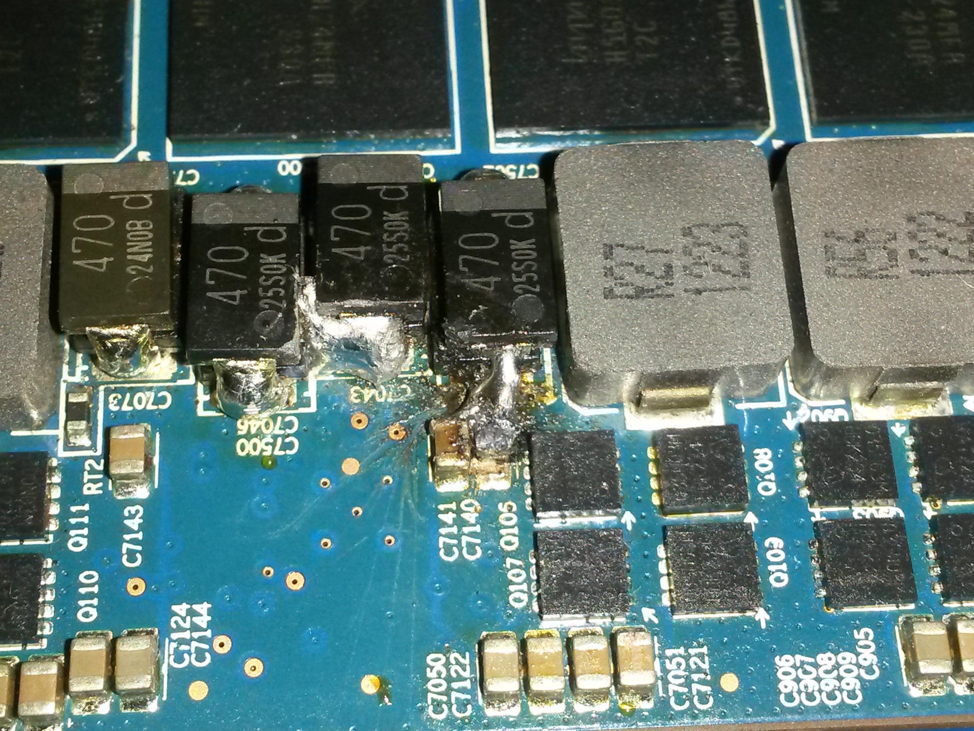

    found something:
    atm card is not working properly, i get bsod. I'm suprised that the card was running with such damage.
    This is the 1.2 version of the 7970m, it explains beautiful capacitor layout.
    Is there any schematics for this card?

      Ok c7141, C7140 get 14V. I need a tip for a capacitor to use.
      Under w10 card driver install freezed mid install, but after restart, card is fully operational. Furmark, OCCT (3D, RAM test), furmark, games: pubg, etc. runs with no problems.
      But when booting cold start i get bsod: driver IRQ NOR less or equal, system and shows AMD driver. restarts and second time boots fine. Strange.
