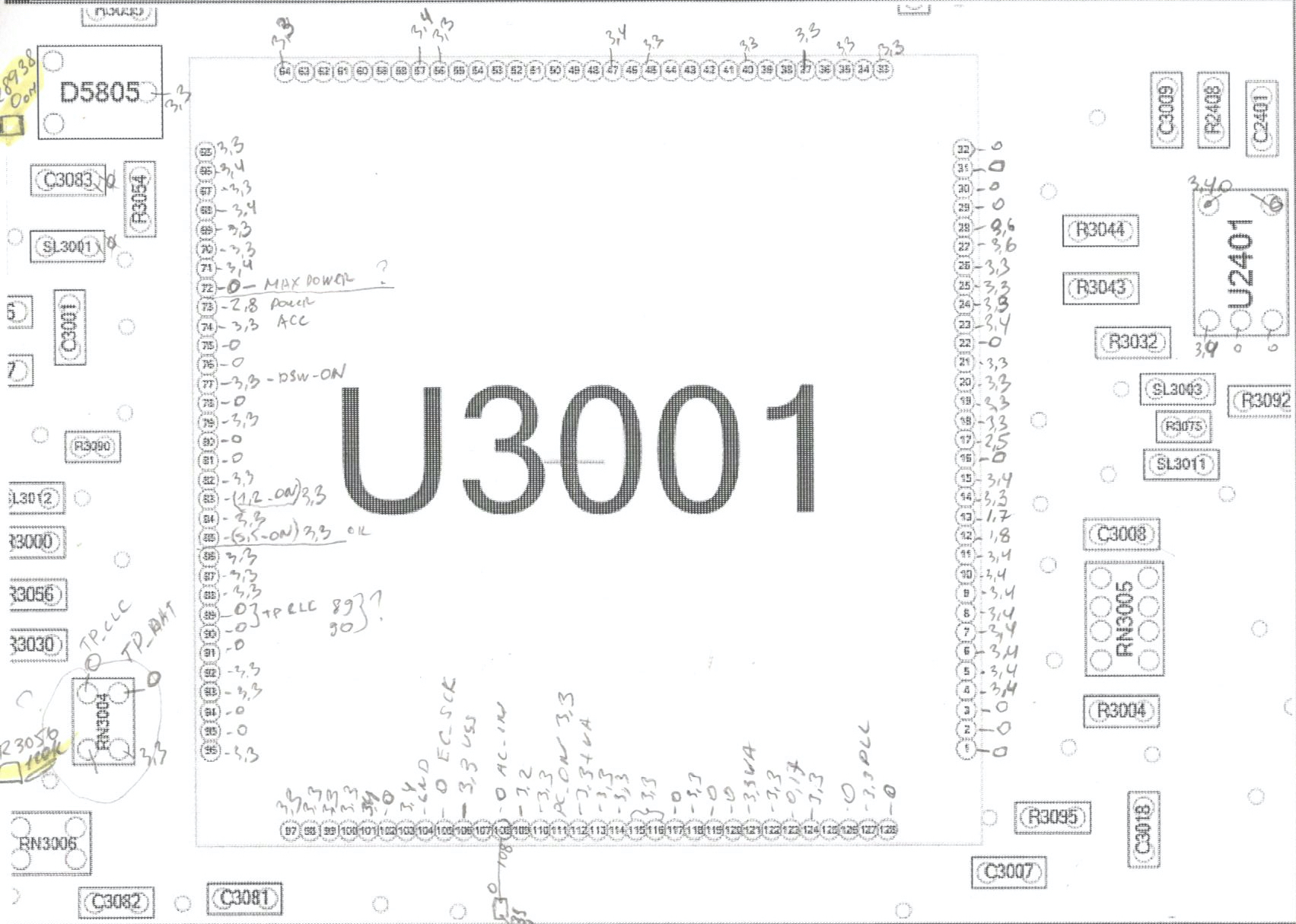

    Good evening!
    ASUS X550VX
    First of all was possible to start with start button, but at the same time, the main voltages on the processor were absent. There was no start.
    There is voltage on the SPI and DDR memory.
    The multicontroller IT 8995 is powered.
    I decided to replace the firmware with SPI. I tried all the firmware that I could find on the forums.
    Now, when power is applied, four LEDs are lit, but it does not go any further. There is no more reaction to the start button.
    I returned the original SPI firmware, but nothing has changed.
    I don't have a programmer for the multicontroller IT 8995
    Please help, what steps can I take? Could this be a problem with the multicontroller?

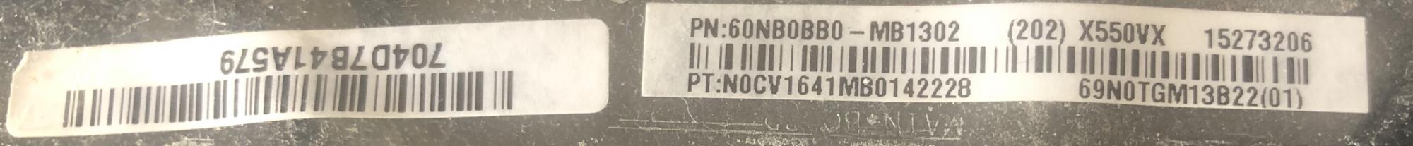

    Shield with model's number was missing.
    Thank you!

    Please start by asking for bios at this section : https://www.badcaps.net/forum/forumdisplay.php?f=40

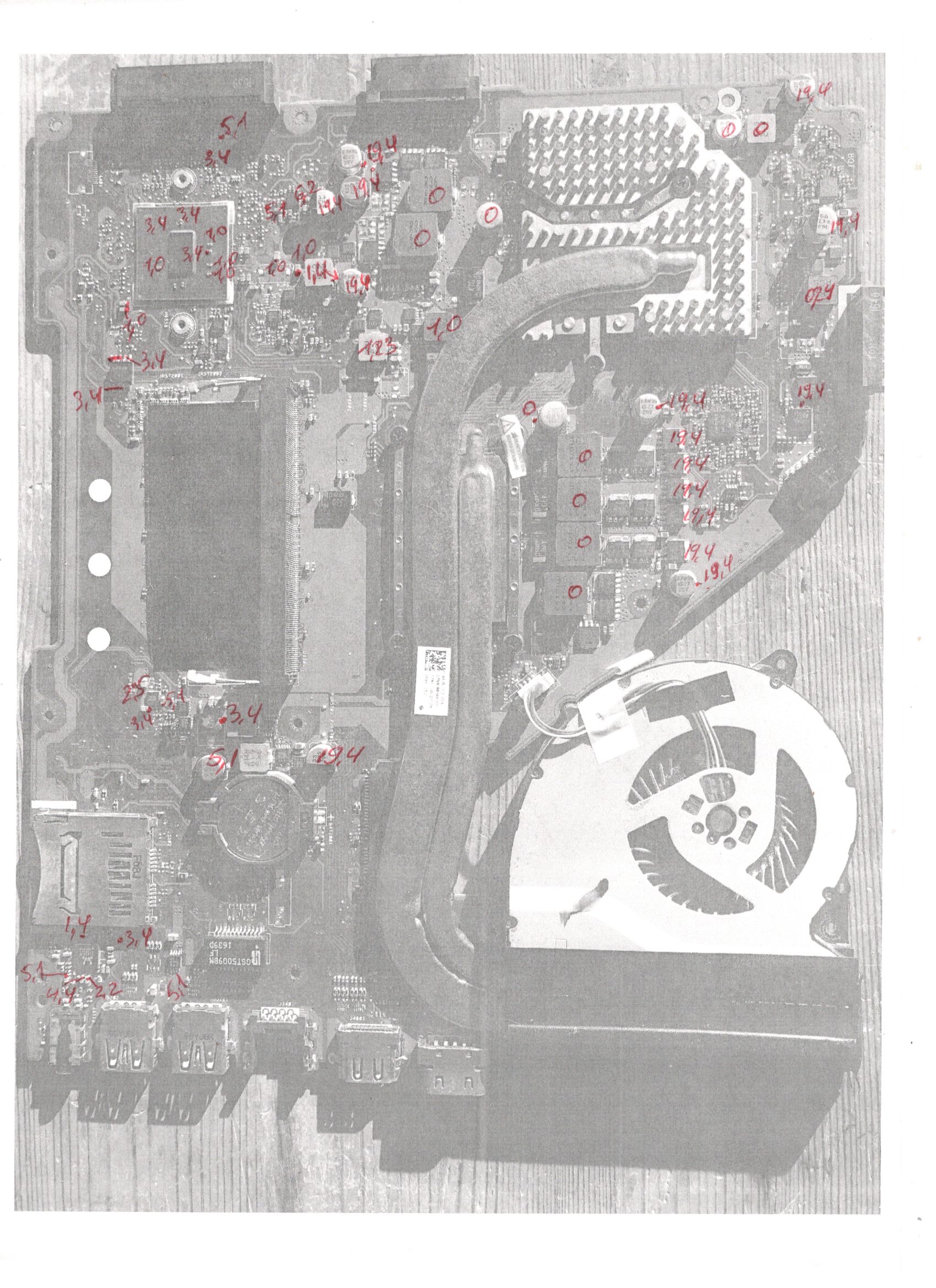

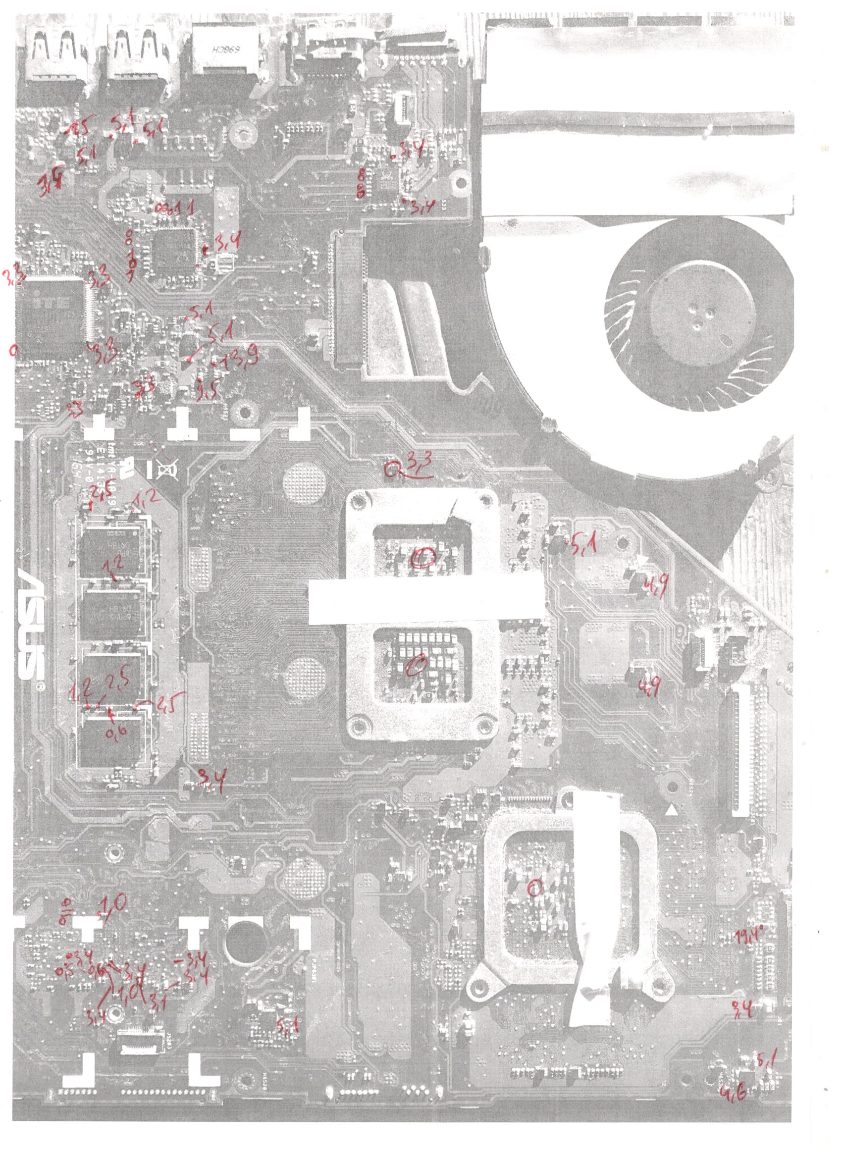

    You must give us all the voltages found when popwer button is trigger .
    Before changing IO you must see if his requirements are present or no .
    With diode mode -no power no battery - give us all the measurements taken from all grey coil.

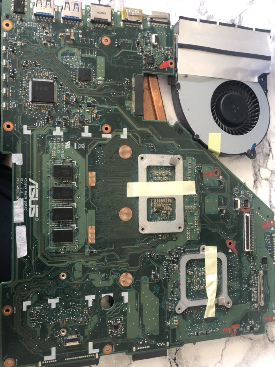

    Post the boarderview if you got it

      Sorry, of course, I had to attach voltage map.
      Yes, I have boarderview. All voltages correspond to the boarderview.

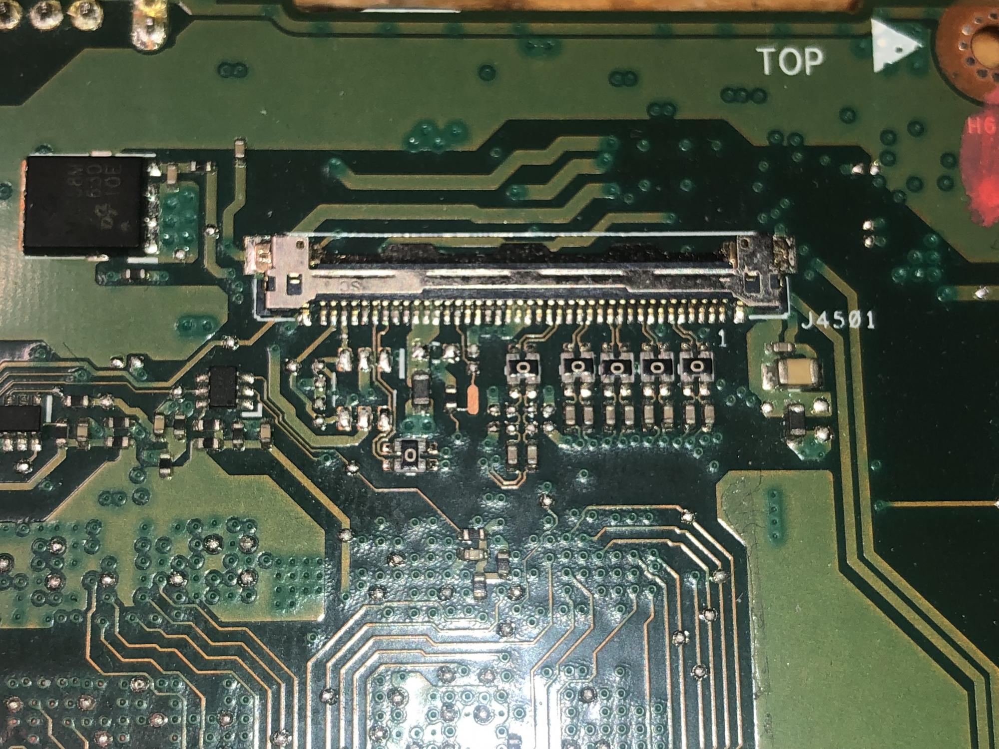

          I need a photo of where the screen flex cable is on this motherboard, is it possible?

            I performed voltage measurements on the multicontroller. In my opinion, he has no problems. Here is the voltage on the controller.

              • hulk0071

                close up photo of screen flex cable part on motherboard

                  I need a photo of the socket where the screen flex cable is on the motherboard, the drec capacitor there is burnt

                    Re: ASUS X550VX need help to repair
                    This one:

                      model's number PN:60NB0BB0-MB1302 (202) X550VX.
