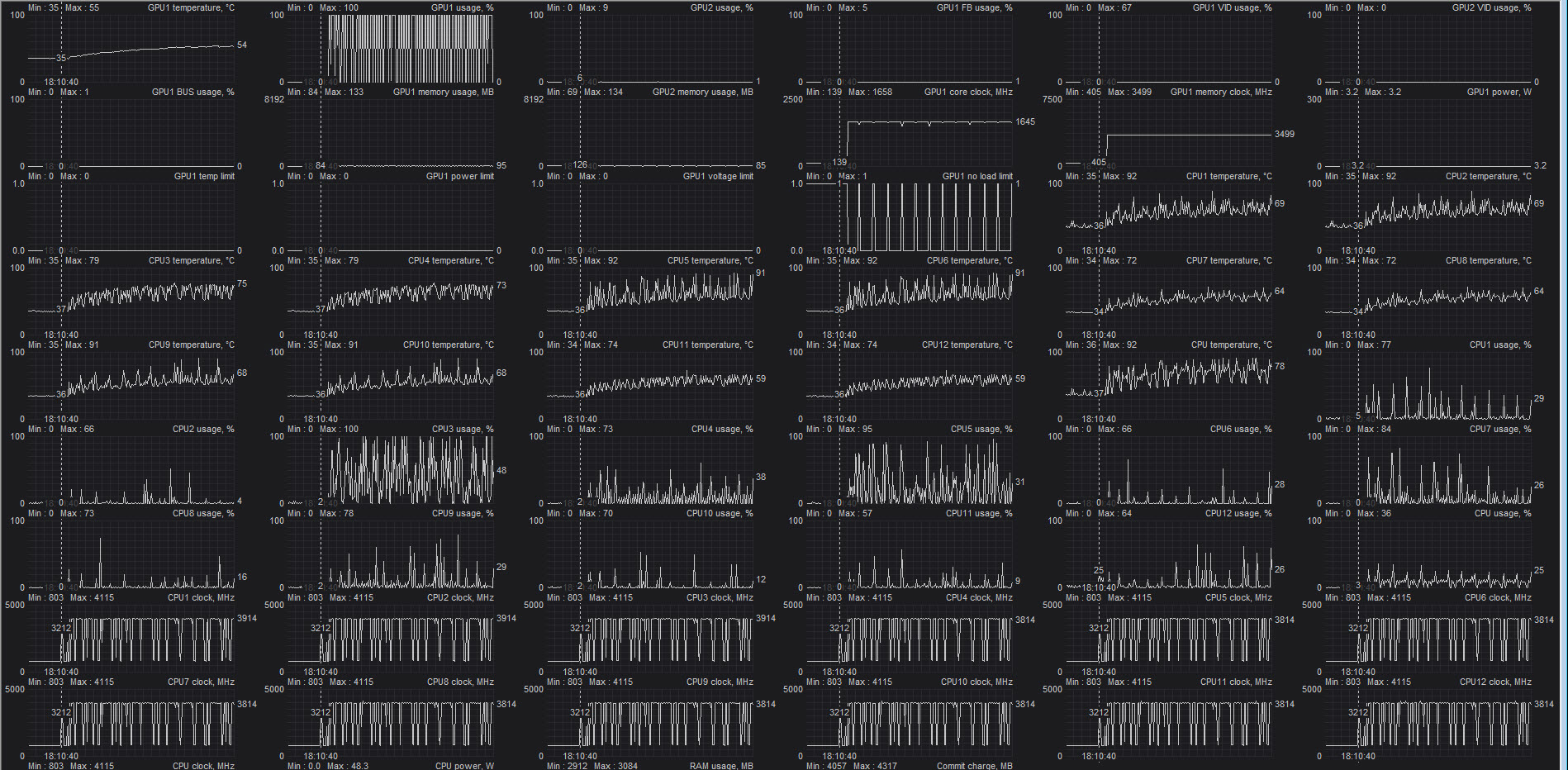

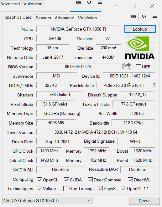

    I have a P65 8RD Creator with a dedicated Nvidia GTX 1050Ti GPU.
    The 1050Ti GPU doesn't work to work at all. Connecting the HDMI just causes hanging and constant switching between the integrated Intel GPU and back to the 1050Ti.
    I have tried with a new 180w charger for this laptop and have tried with a 20v 260 watt charger for the GE75 as well and it doesn't remedy it.
    I include the screen shots and monitoring hml file from afterburner and GPU-Z.
    Have done a bunch of stuff (reflash original vBIOS, update BIOS and EC firmware, reinstall windows, change driver, change RAM, underclock, replace thermal paste for CPU and GPU but left existing thermal pads on other components).
    Wondering what troubleshooting to do next. Can't see any visibly damaged components on the board.

                    Regarding HDMI, the dGPU is not accessible to applications (and doesn't appear to work at all) even when HDMI is not connected. Running GPU-Z's performance tests on the dGPU when the HDMI is not connected produces similar monitoring data.
