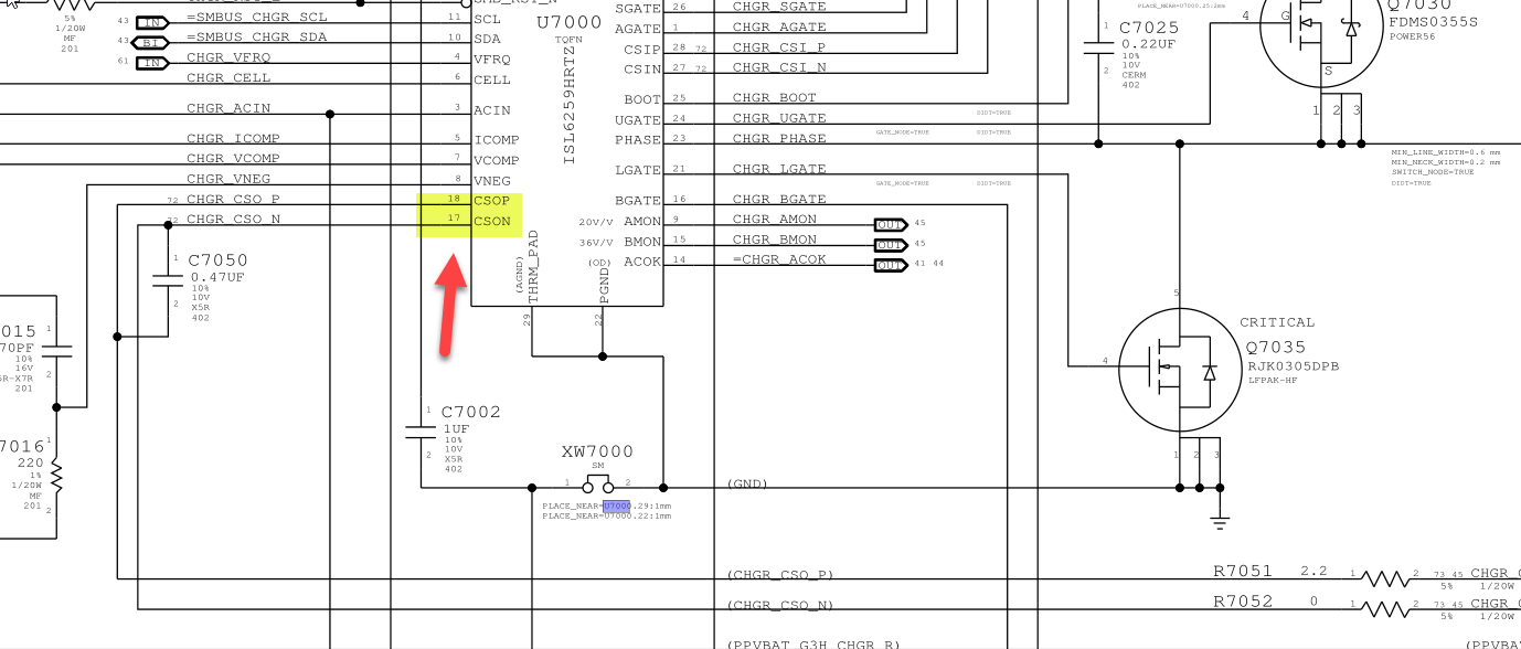

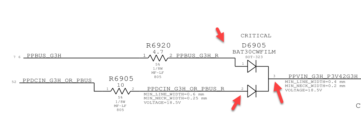

                        After posting the logic board # 820-xxxx number,
                        < the following are referenced to the 820-3024 schematic >
                        1) using only the battery, post the voltage of:
                        D6905 - pins # 1, 2, 3
                        (see attached)
                        2) voltage of PP3V42_G3H_REG (measure @ L6995, pin # 2).
                        3) R7051 - pin # 1
                        4) R7052 - pin # 1
                        5) Pin # 18 (CSOP) of U7000
                        6) Pin # 17 (CSON) of U7000

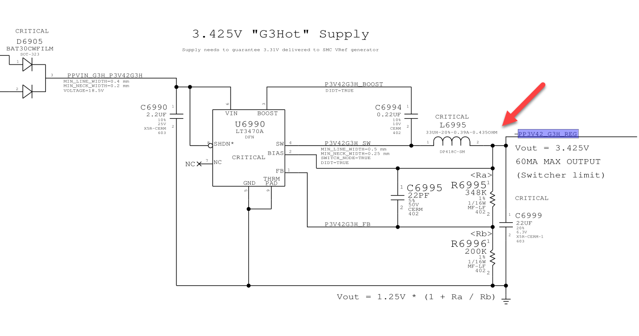

                            Re: MacBook Air A1370 charging issue
                            Ok - I think your PP3V42_G3H_REG is low.
                            Can you confirm this voltage first ? It should be 3v42 if ok.
                            Check @ L6995, pin # 2.
                            If you do not see this voltage, remove all power, meter in resistance mode.
                            Check the resistance to ground of L6995, pin # 2.
                            Post the readings.

                                • 74kieran
                                  • Dec 2021
                                  • 33
                                  • Uk
                                  L6995 is 3.42v
                                  • 74kieran
                                    • Dec 2021
                                    • 33
                                    • Uk
                                    D6905 - pin 1- 7.58v pin 2- 7.13v pin 3- 7.33v
                                    R7051 - pin # 1 - 7.36v
                                    R7052 - pin # 1- 7.36v
                                    Pin # 18 (CSOP) of U7000 - 0.10v
                                    Pin # 17 (CSON) of U7000- 0.10v
                                    • mon2
                                      • Dec 2019
                                      • 14667
                                      The PP3V42_G3H_REG voltage @ 3v42 is perfect.
                                      Can you confirm these readings again ? These are not correct.
                                      Be sure that you are selecting the proper pins on this square device (QFN package).
                                      Expecting the same voltage readings as you have posted for R7051 & R7052 to be reaching these pins on the U7000 IC.
                                      If indeed you are confident that you are reading these voltages, then power down. Meter in resistance mode (lowest scale).
                                      Measure the resistance from R7051, pin # 1 to pin #18 of U7000. This resistance value should be ~ 0 ohms since this is a direct PCB trace = wire.
                                      Measure the resistance from R7052, pin # 1 to pin #17 of U7000. This resistance value should be ~ 0 ohms since this is a direct PCB trace = wire.
                                      If indeed the resistance is high, this is a fault - the charger IC needs to see the same voltage readings through these pins as you have posted from the above resistors. This means the traces are broken between the resistor legs and U7000. Look for any visual damage - corrosion ??
                                      With the low voltage readings, the charger IC will shut OFF due to the device thinking that too much of a load on the charger legs since the voltage is close to 0 v.
                                      Take your time and care to measure on the pins of U7000. The boardview should help to locate the proper pin numbers.
                                        It seems to still be no voltage. I am going to have to get a better microscope as the magnifying tool I have isn't great.
                                        However, I have tried continuity on chip C7050. Would this cause me issues with seeing the voltage? If I check the resistance, I am getting zero from the the U7000 to the R7051 and R7052 chip.
