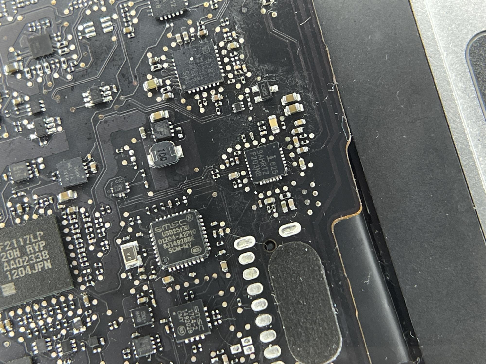

    With meter in voltage mode, place red meter probe on c7050 on one side. Black meter probe to ground.
    What is voltage when the battery is connected?
    Then repeat with red meter probe on other side of c7050.
    Expecting to see the same voltage as on the series resistors on these traces.
    Can you post pics of the logic board for this area?
    • 74kieran
      • Dec 2021
      • 33
      • Uk
      Re: MacBook Air A1370 charging issue
      0v each side. And attached a image

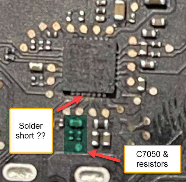

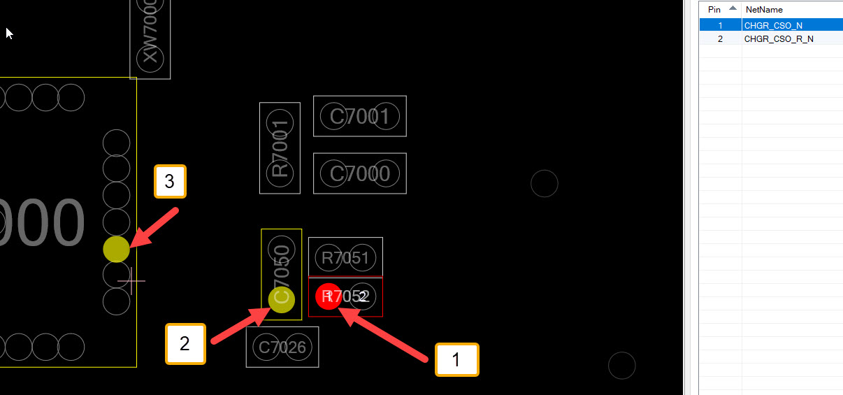

          Based on the post # 22 (0 volts on both sides of C7050) - it appears that you have broken traces.
          See attached.
          Remove all power. Meter in lowest resistance mode scale.
          Check the resistance between pads # 1 and #2. It should be about 0 ohms since this is a direct PCB trace (unless the trace is damaged).
          Confirm it.
          Then check the resistance between pad # 1 and # 3 (at the IC). Again, as a direct PCB trace, the resistance should be ~0 ohms.
          Confirm it.
          Then repeat for the other side of the cap @ C7050.
          If you see other resistance values, the PCB traces are damaged and can be repaired easily but first need to see these readings.
          Also, do test the resistance between pad # 2 & # 3 for the top of C7050.
          Then again for pad # 2 & # 3 for the bottom of C7050.
          This is to confirm which trace(s) are damaged.
          Update - from the posted pic - is there a solder short on the IC ??
          Apply flux on these IC pads -> hot air till the pads are no longer looking like they are shorted. Use low air pressure but high heat to allow the solder to melt and wick up under the IC.
          The pads look like they are shorting.
            I agree it does look like there is a solder short. Going to order a better microscope now which hopefully comes tomorrow so can double check. It seems i get 0.03ohms on R7051 and 0.01ohms on R7052.
            When it comes tomorrow I will double check and update the thread.
            Thanks for your help

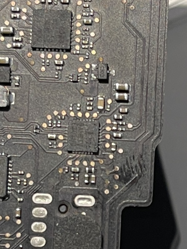

              I don’t think they are touching. I have included a photo. It’s strange as I had no continuity before plugging it in. Soon as I plug a charger in and unplug it. There is no continuity. I’m get 0.03-0.04 ohms. Would this be a faulty IC chip do you recon?
