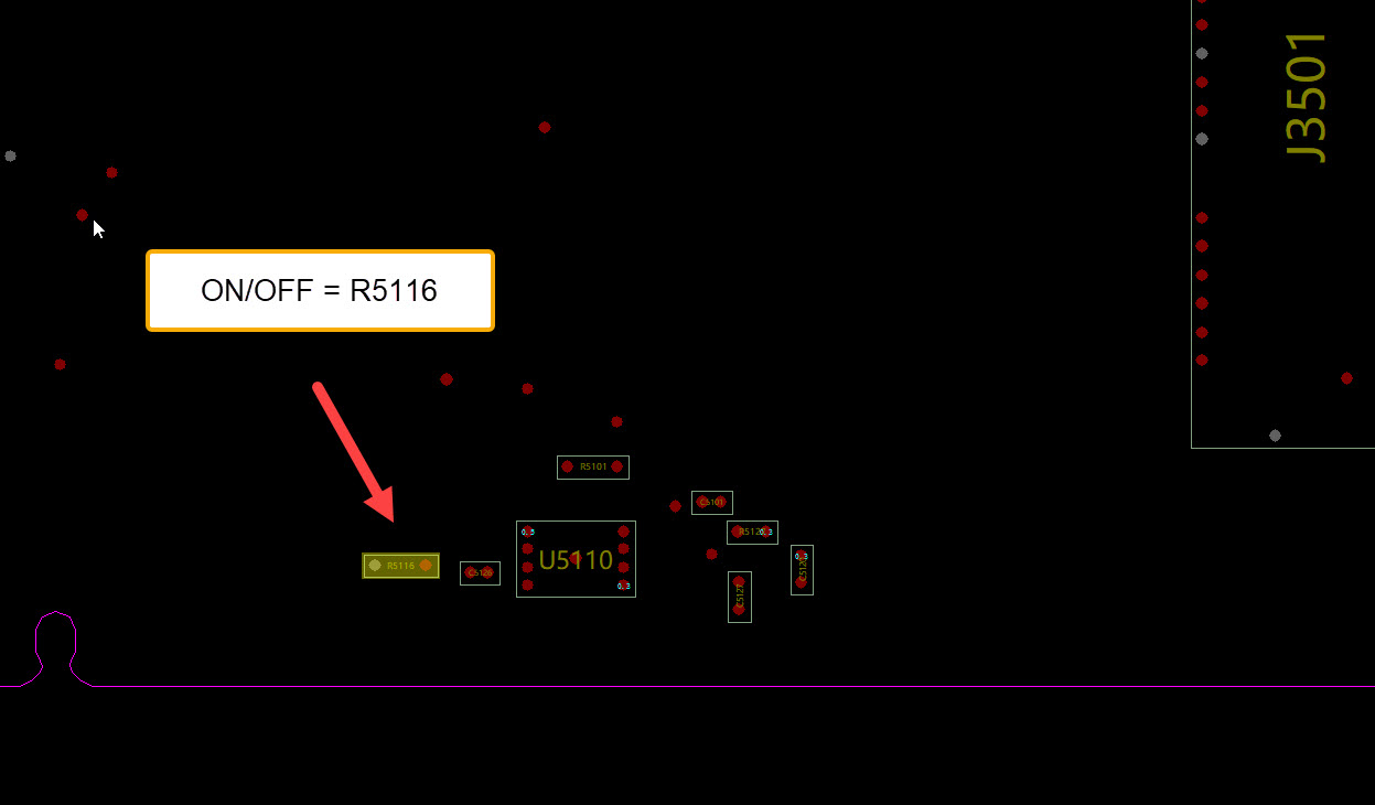

    See attached.

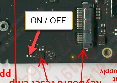

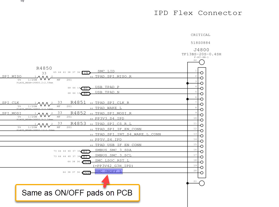

    The ON/OFF of the logic board has numerous feeds including the SMD pads you are shorting with the tweezers.
    Then there is the keyboard ON/OFF. I recall a few cases like yours on this forum where the keyboard (maybe due to liquid damage??) was flaky for the ON/OFF function.
    To confirm, test with the keyboard again. If the results are not 100% everytime to turn the macbook ON/OFF, then you will need to monitor the voltage on
    pin # 20 of connector J4800.
    You should see a logic high (~3v4) when the key is not pressed
    and then logic LOW (~0 volts) when the key is pressed. If this status is not low enough, the logic board will not turn on.
    Confirm this detail with the multimeter.
    Post the measurements to move forward.

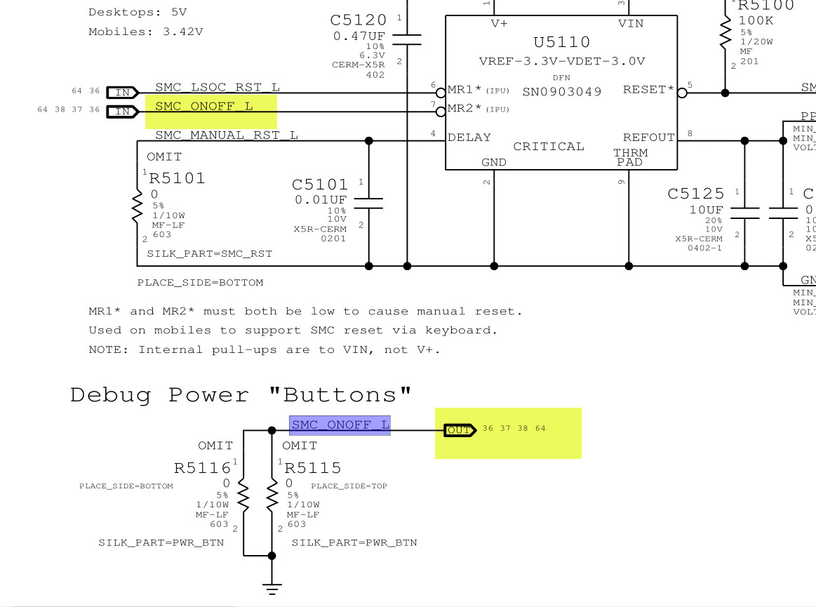

            Re: Need help with 820-00165
            Remove all power.
            Disconnect the trackpad and test again with the ON/OFF using tweezers. Is it faster?
            With the logic board mounted, you must use R5116 for the ON/OFF function.
            See attached.
            Test this multiple times (without trackpad attached).

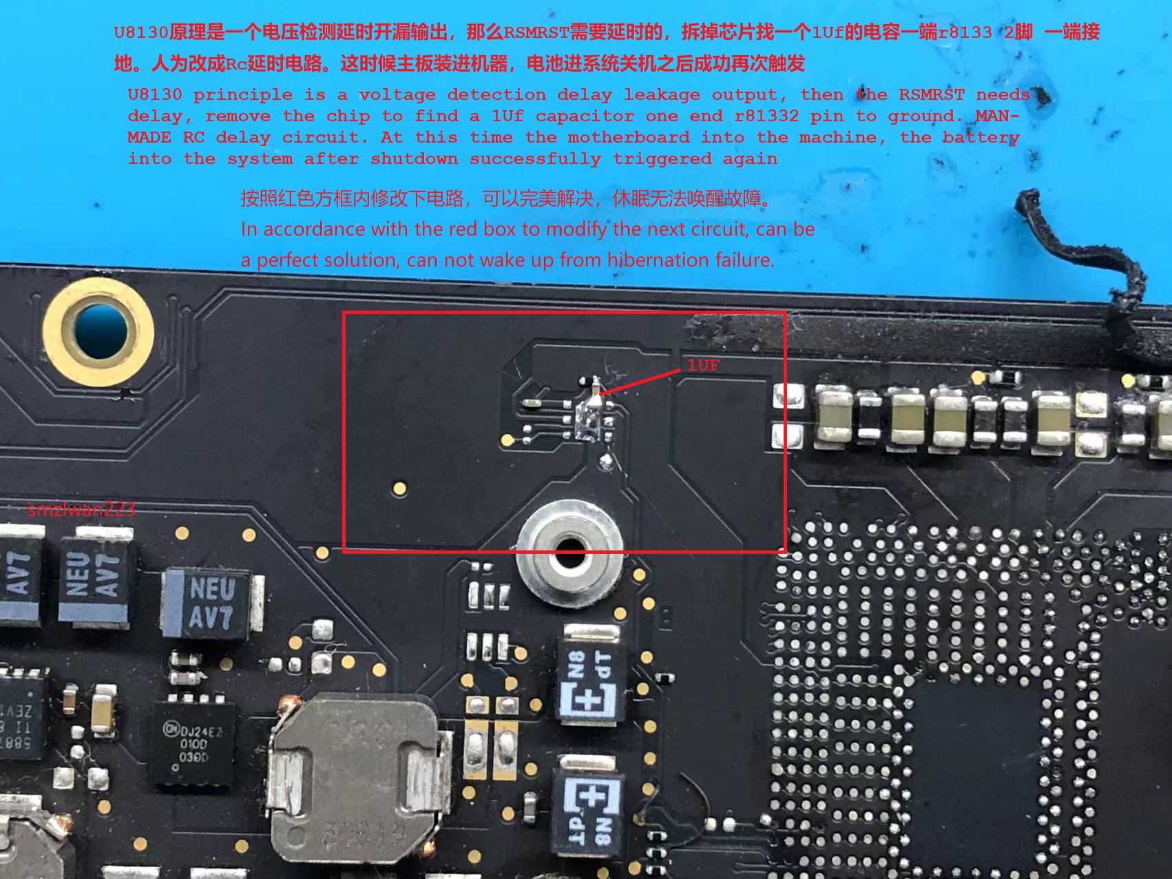

                          It's a problem I've had a lot of trouble with in the past, and I've been working on it, and I hope it helps. This is a rough sketch I made for you. I hope you can understand it. My English is not very good, can only use the translation software to communicate with you.
                          • mon2
                            • Dec 2019
                            • 13880
                            #33
                            @smzlwan223 - many thanks for your great feedback.
                            So you are replacing the reset supervisor IC (Texas Instruments) with a RC circuit ?
                            Was U8130 (TPS3808G33) defective on your logic board ?
                            Will review with the OP.
                            @goksi75 - measure and post the voltage of PM_RSMRST_L.
                            Interested in the voltage when the logic board is NOT waking up.
                            The resistor @ R8133 is required. Confirm it.

                                    It is ironic - for our product designs, we use similar reset supervisor devices so that we can guarantee that the reset line is released after a known period of time. The supervisor ICs are more robust than RC circuits but of course, try the idea.
                                    @smzlwan223 has proven it worked for him.
                                    I believe what may be the fault here is that the IC has a threshold value to monitor = PP3V3_SUS. When that rail is within the specified voltage range, the RESET output is high impedance and the pull-up resistor does the job to make this pin HIGH = all is good.
                                    That is, the PP3V3_SUS may be perhaps too low so RESET remains LOW. In general, the reset supervisor threshold should have been a lower detect value like 2v8-3v0.
