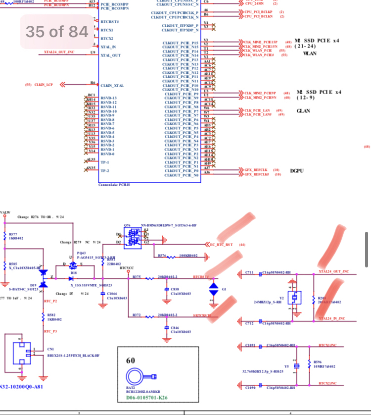

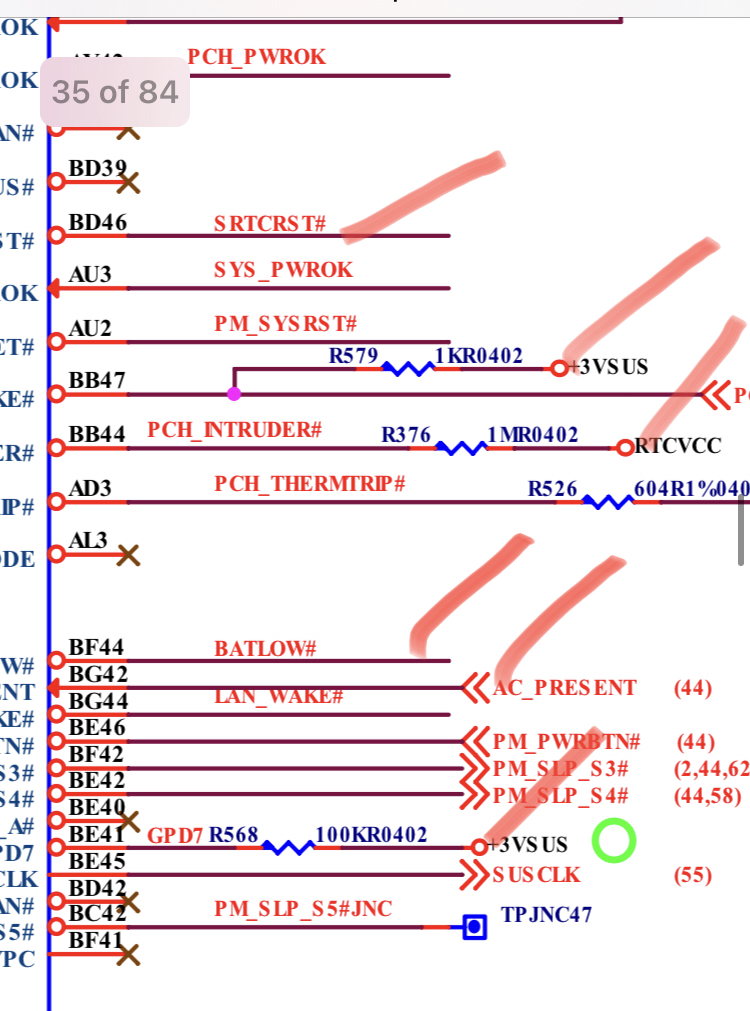

                    Re: MSI MS-16P51 No power
                    Ok, i tried my best to measure this.
                    I have +3VSUS on c1063 near the PCH when I press the power button.
                    SRTCRST# = 2,75V -> 2,50V when button pressed
                    BB47 R579 = 0V -> 3,3V when button pressed
                    PCH_INTRUDER# = 2,75V -> 2,50V when button pressed
                    BATLOW# = 3,3V
                    AC_PRESENT = 3,3V
                    BE41 R568 = 3,3V
                    EC_RTC_RST = 0V -> 3,3V when button pressed
                    RTC_RST = 2,75V -> 2,50V when button pressed
                    SRTC_RST = 2,75V -> 2,50V when button pressed
                    XTAL24_OUT_JNC = 0V
                    XTAL24_IN_JNC = 0V
