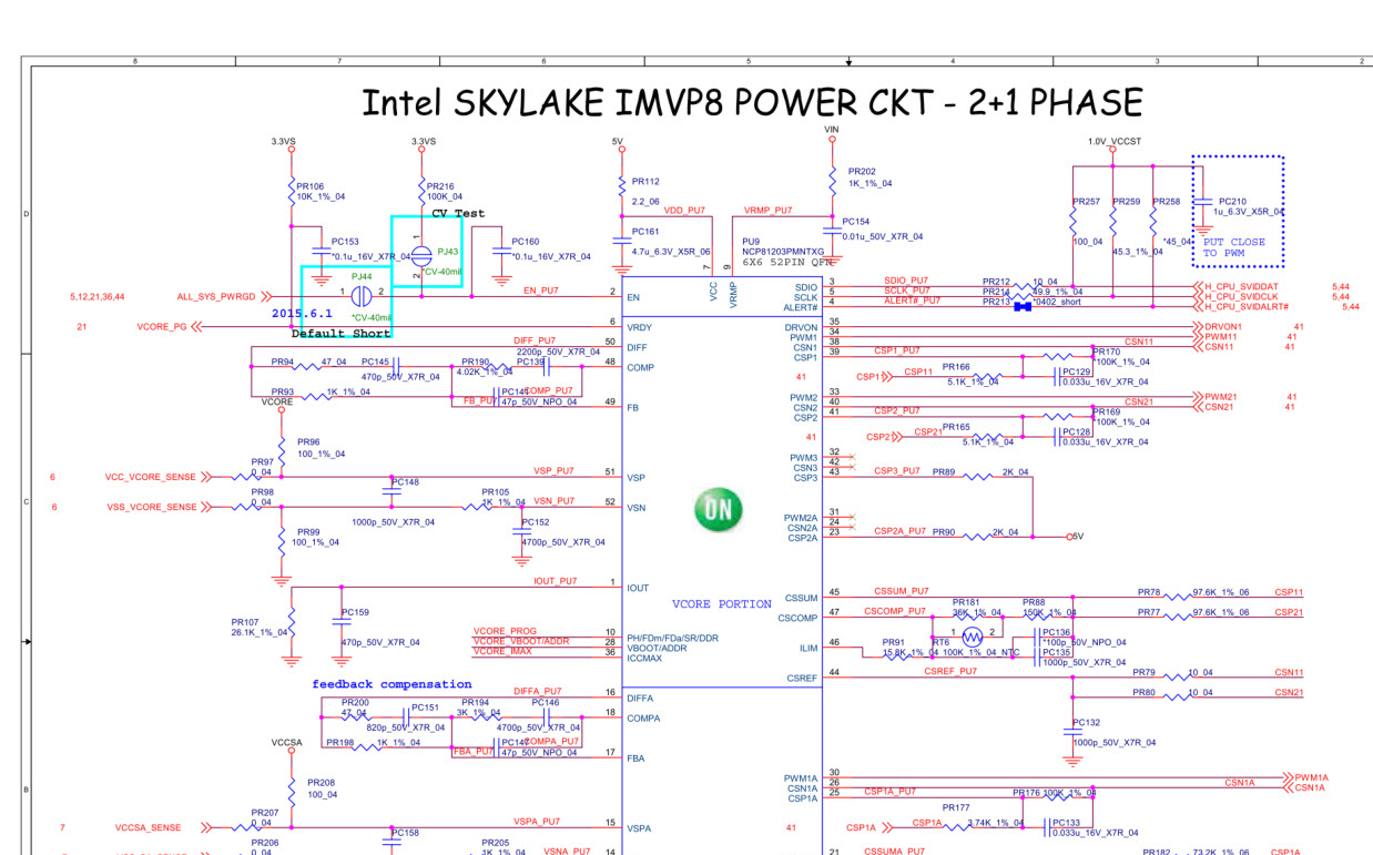

Custom laptop Ncp81203 voltage controller pinout
  • ss45
    • Jun 2019
    • 119
    • Brazil
    Laptop is custom, I believe made by some OEM like MSI, pegasus, or gigabyte
    There is this ncp81203 that I suspect is damaged, but can't confirm due to no datasheet available.
    Help appreciate d

    Is there a serial or model number on the case. Are there any part numbers on the motherboard

      Re: Custom laptop Ncp81203 voltage controller pinout

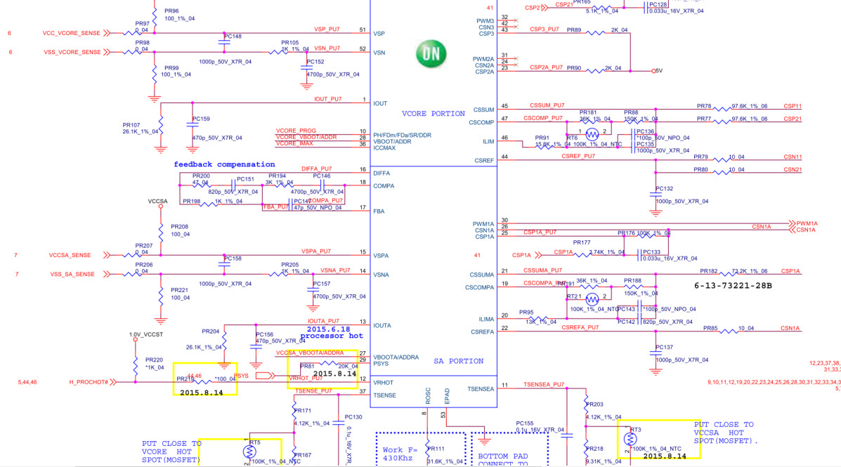

      See attached.
        Thank you guys for the replies..
        Preliminary probing result, the layout seems to be similar with ncp's other product, ncp81243
        And this chip also connects to several drivers with a3* marking, online search gave me ncp81151
        About the board part number, maybe this is the right one, I hope .....
        6-77-P750DM2A-N03-2 (I am not sure whether 0 is zero or O (o alphabet) )
        Edit oh yes it is Clevo product

          You can find a service manual/schematic here: https://repo.palkeo.com/clevo-mirror/P7xxDM23G/ Log in using Username: repo ,password: repo ,download P775DM2_ESM.zip

            Oh wow I didn't know there is such repo.
            This is heaven sent !!
            Thanks so much
