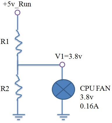

    Dear Forum members,
    I need to create a custom voltage of 3.8v in a laptop to drive the CPU fan.
    It is not available in laptops and I have to create it. I can think of a simple voltage divider depicted in the photo.
    but I have doubt that the voltage divider may consume extra power from the +5v_Run rail and make this rail burn after a while.
    the fan consumes 0.16A when the input voltage is 3.8v.
    the laptop is an ordinary 90W laptop called Dell Inspiron 1564.
    the fan has no PWM input and the original FAN Driving Circuit on the mainboard is defective.
    So I have got the questions that:
    - Is it possible that this voltage divider damage something on the mainboard?
    - Is such voltage divider suitable to create a custom voltage in a laptop?
    - If not so, what kind of circuit does suite this purpose such that it can be easily made on the mainboard?
    - What values should be selected for R1 and R2 such the voltage divider consumes very low power?

    Unfortunaltey a voltage divider will not work in this case. You're trying to drive an inductive load that'll be drawing a fair amount of current especially at startup.
    If you only want a constant voltage with no control over it (which isn't really the best idea for a laptop fan), you can simply use a voltage regulator. An LDO (like an 1117) can do the job, it'll also require a couple of capacitors and a resistor or 2 to set the output voltage.
    You could also connect it directly to the 3.3V rail, it'll run a bit slower.
    Anyway, you're better off fixing the fan circuit on the motherboard.

        • caspian
          • Oct 2015
          • 1591
          • Laptop
          Re: Custom Voltage in a Laptop
          Dear ktmmotocross,
          I have tested 3.3v, but the fan spins at a low rate using 3.3v.
          Dear peste,
          the buck converter modules are really interesting to use in sensitive parts of mainboards. Since it is just a FAN, I thought a simple voltage regulator might be enough.
          If I use high resistance values for R1 and R2 in the kilo ohm range, does this voltage regulator burn the +5v_Run rail?

                • ala_borbe
                  aka Donald
                  • 1625
                  • Malta
                  take 5v from usb and put two zener diodes in series (or three if it spins to fast)... every diode makes ~0.7v voltage drop
                  works like a charm... done 500 times at least

                              I discovered that the circuit of Post#1 is not correct.
                              How should the two serial Zener diodes be used so that the output voltage does not depend on R_load?
                              • peste
                                • Dec 2016
                                • 13581
                                • ROMANIA
                                Do not complicate yourself, what ala_borbe said in post # 9, is the simplest.
                                • caspian
                                  • Oct 2015
                                  • 1591
                                  • Laptop
                                  That is right. Thank you.
