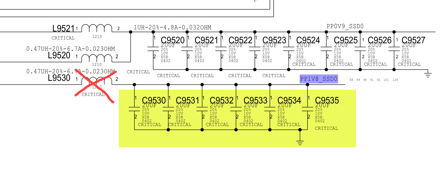

        • mon2
          • Dec 2019
          • 13897
          Re: Macbook A2141 / 820-01700-A / Nand burned

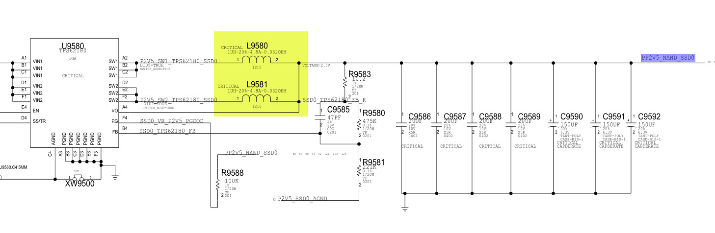

          See attached.
          Lift up one leg of the highlighted inductors so we can isolate the PP2V5_NAND_SSD0 power supply rail.
          After doing this, check the resistance to ground on both sides of the inductor.
          Remove all power to the logic board.
          What is the resistance to ground in ohms for both measurements ?
          Also post the meter scale used for the test.
          DO NOT power with the coils lifted.

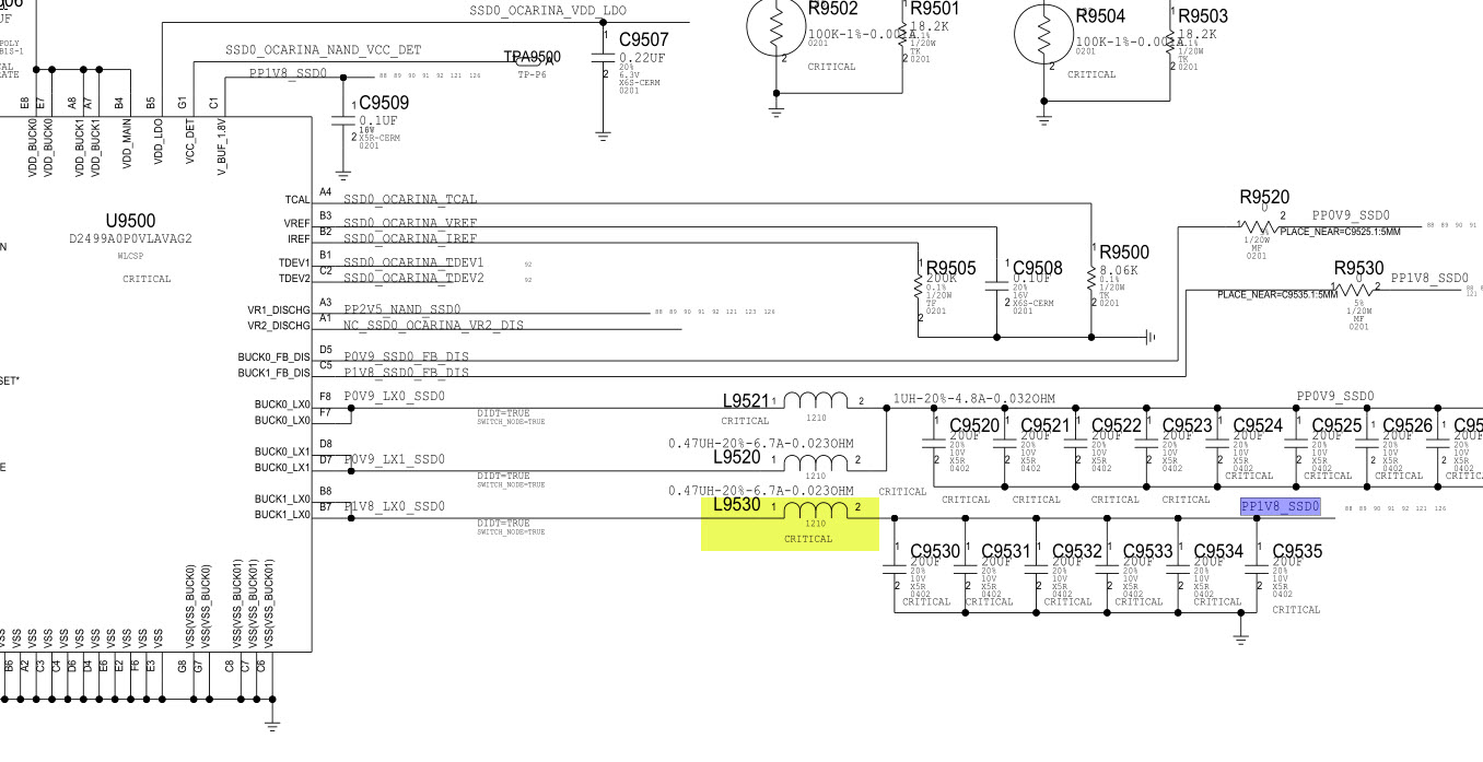

          What is the other rail that is shorting ? Is it PP1V8_SSD0 ? Unable to locate the rail (net name) you posted.
          See next attachment - lift up one leg of L9530.
          Perform the same resistance to ground testing.
          We need to know if the PRODUCER (regulator) side or the CONSUMER side (load / downstream) has the shorted component for each power rail.
            i lifted both the inductors L5930 & L9580, inductor L9530 consumer side resistance value to ground is 01.1ohms & inductor L9580 consumer side resistance value to ground is 02.2ohms.
            inductor L9581 both side is short to ground , regulator side 0.8ohms & consumer side 02.2ohms .
            what can we do next?

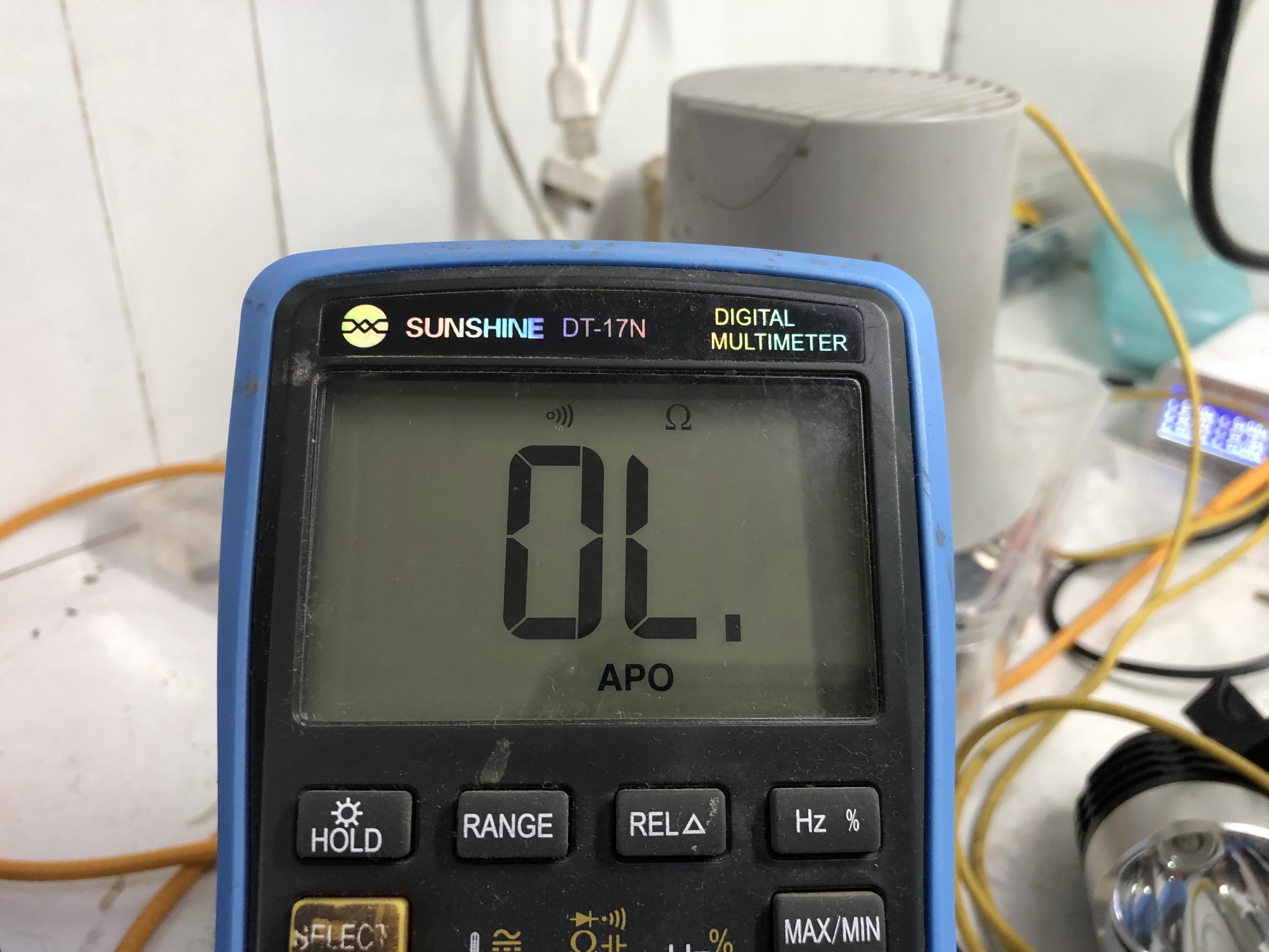

              What was the setting on your meter during these measurements?
              • Nitinrajkumar
                • Jul 2022
                • 8
                • India
                meter setting

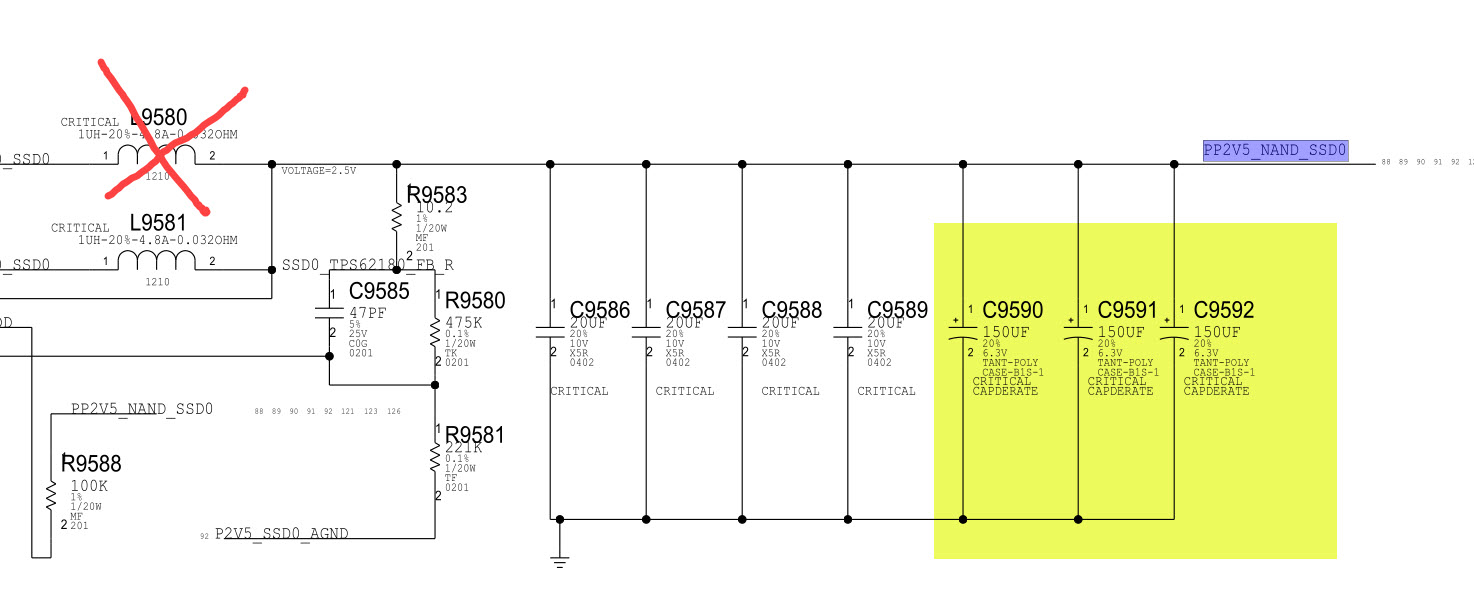

                  See attached.
                  Each of these rails has downstream caps to filter the power supply lines before it reaches the target memory ICs.
                  Often, it is the caps that go bad and cause this shorting event.
                  For this reason, consider to review L9580 downstream cap cluster which are highlighted. These are the bulk tantalum caps and tantalum caps in general are just crap (tutti).
                  Flux each such cap and lift up carefully onto one leg. After you do this, check the resistance to ground again for the downstream side of L9580 inductor. We are trying to locate the shorted cap on this consumer side of the circuit.
                  For now, just work on the L9580 rail = PP2V5_NAND_SSD0
                  So lift up one leg of C9590 -> C9591 -> C9592. You could measure the resistance to ground after each cap is lifted on one leg. Hope it is inside this cluster of 3 caps.
                    i measure the gnd resistance value on all three caps after lifting it. still this rail is short to ground.
                    before your last reply i already lifted 2 nand from the logicboard, i found more heating in thermal camera after ejecting the 2V5 volt from DC supply.
                    from reference of boardview i measure pad value of nand, i found 1V8 & 2V5 both volt line is short to ground in nand itself. both nand are showing short
                    i am confuse is this ok?

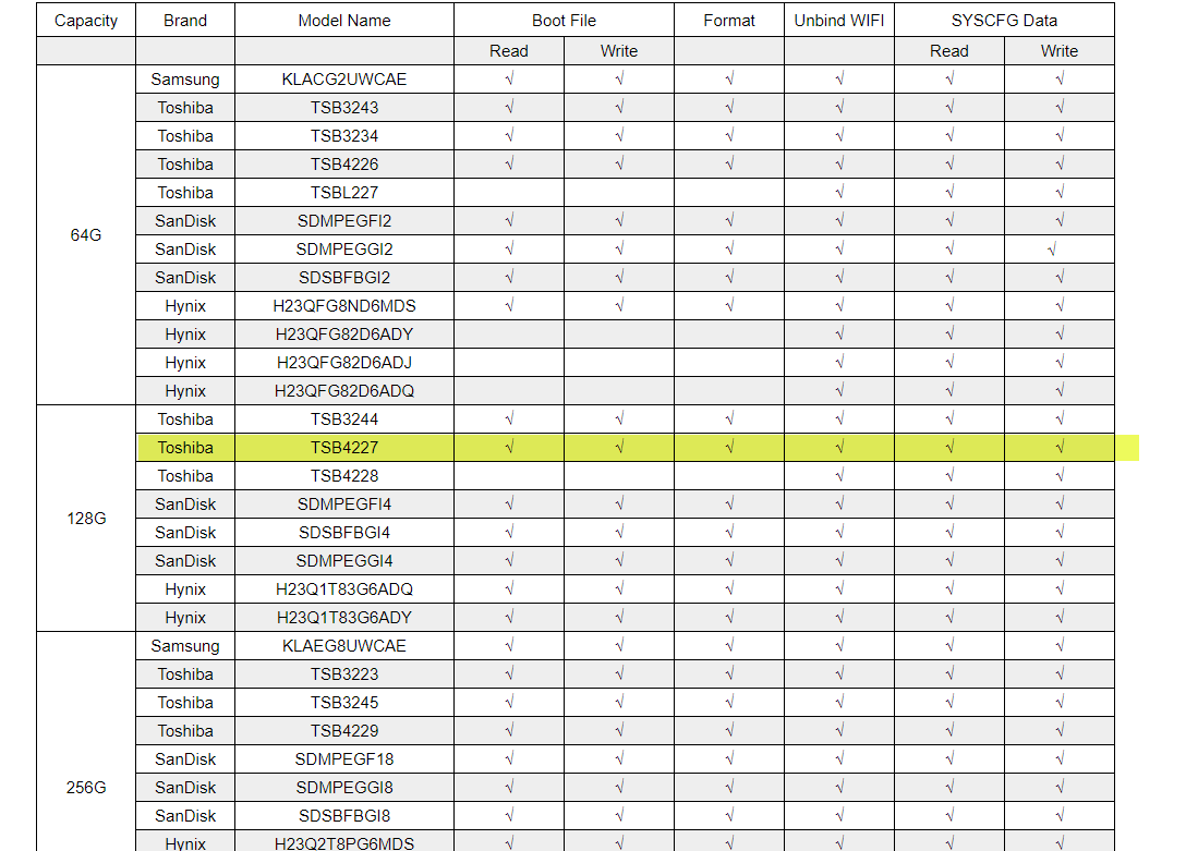

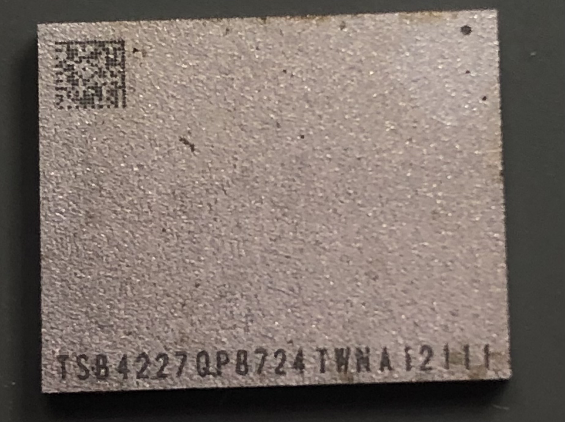

                                  Is there is any data to understand the storage of the nand through alfa-numeric letters printed on it?
                                  I used JC BGA110 to check this nand, it's showing 64GB .
                                  • mon2
                                    • Dec 2019
                                    • 13897
                                    From where did you source this NAND flash chip ? Do you have details of the logic board ?
                                    As per note from @Piernov, the flash chip(s) should be from a donor board. Being SSD, the format, organization and other timing parameters need to match the original specifications.
                                    You can also compare the bottom side of the flash chip and there may be footprint differences like the # of balls, etc.
                                    See attached.
