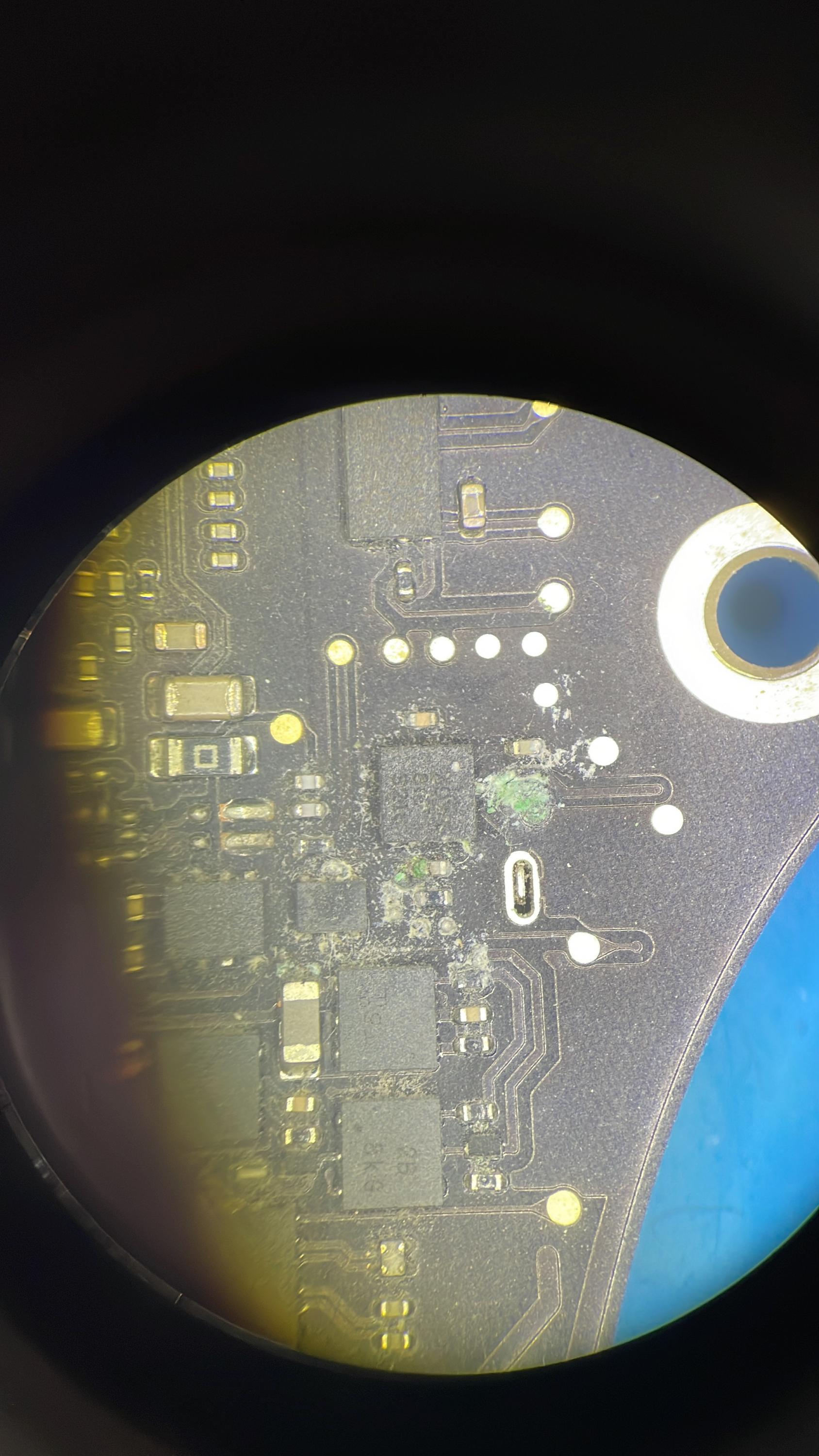

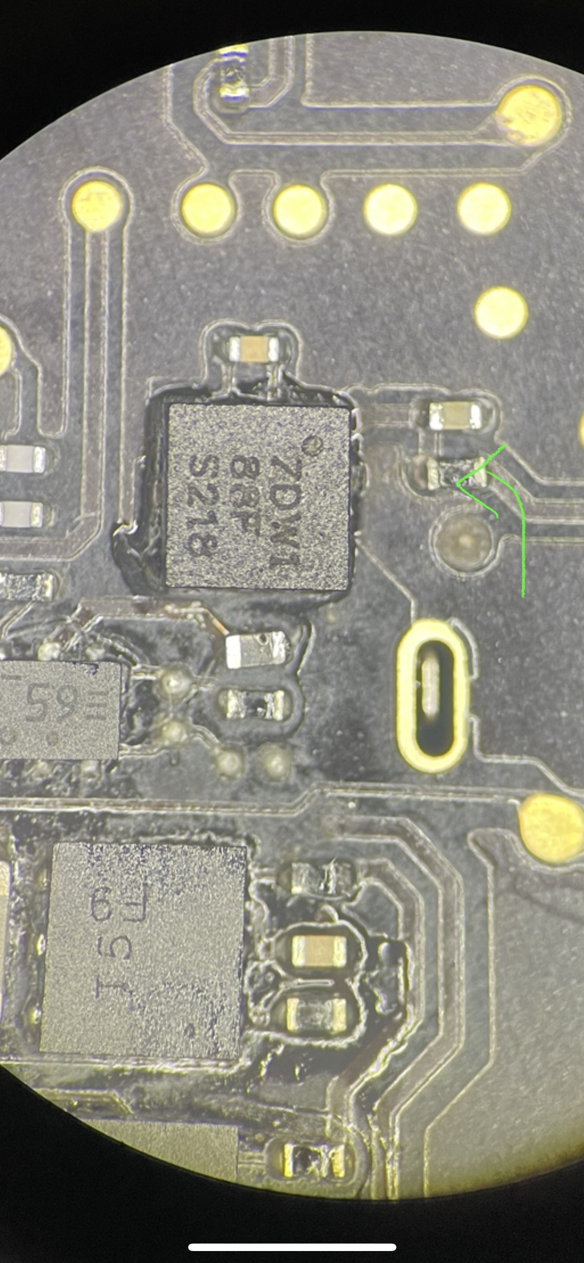

a1990 820-01041-A running very slow and high fanspin
  • Harryrepair
    • Jul 2016
    • 82
    I got this board for practice.
    It had a liquid damage around U5850.
    Cleaned it, ran a jumper and put back one missing resistor (R5850,47ohm) and cap C8286 (1UF).
    Fans are still spinning on maximum and machine is running very slow.
    I found PP1V8_S5 not present and CPUVR_PGOOD not present.
    Appreciate all help.
