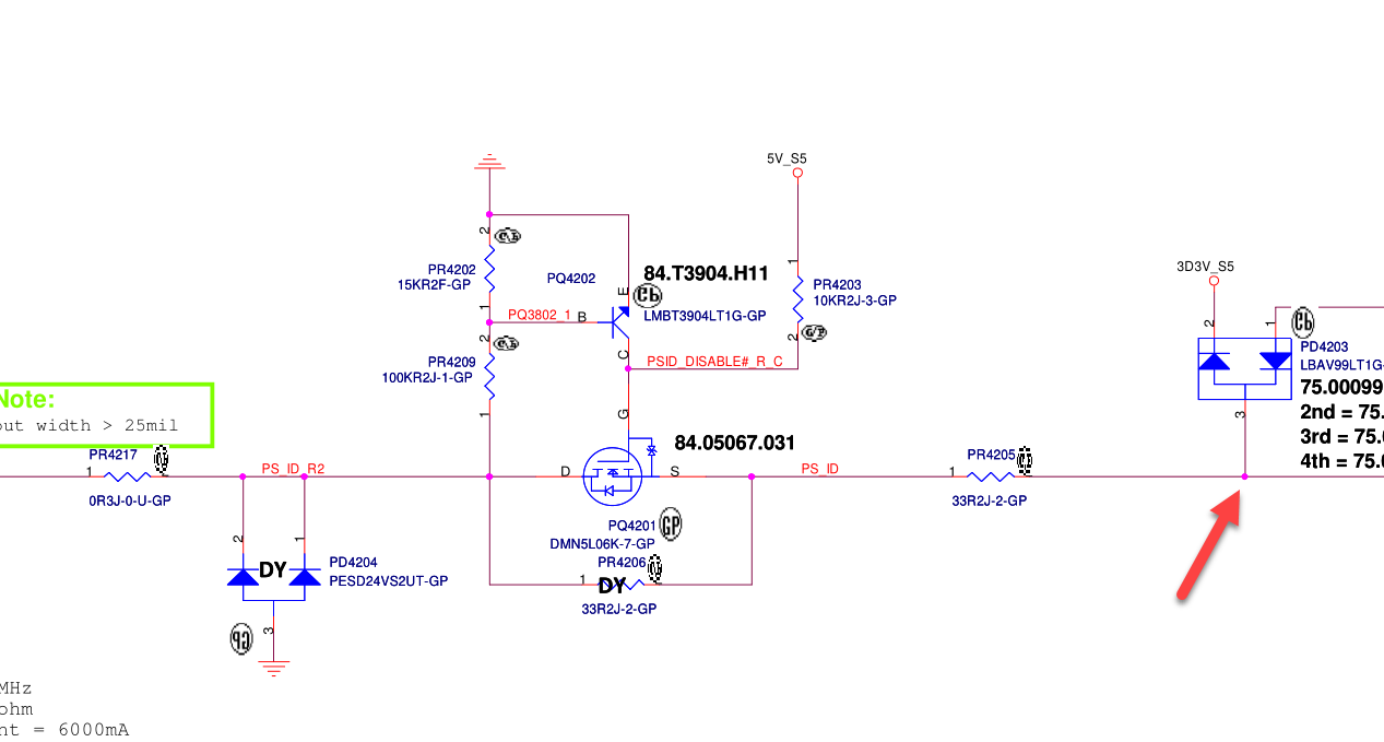

help me pls dell cedar _intel -mb 13269-1 fx3mc rev:a00 uma
  • Nurshad
    • Oct 2019
    • 75
    • bangladesh
    Problem-Plug in not charging Ac Adapter type -Unknown
  • mon2
    • Dec 2019
    • 14021
    Re: help me pls dell cedar _intel -mb 13269-1 fx3mc rev:a00 uma

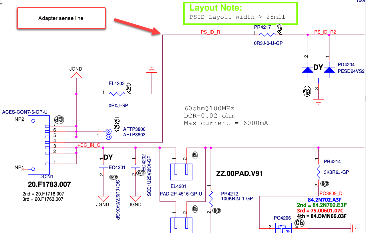

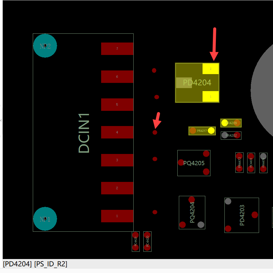

    Hi.
    See attached.
    Post the voltage reading for pin # 4 of the adapter connector.
    You can measure @ PD4204 (red meter probe) & ground (black meter probe on shield).

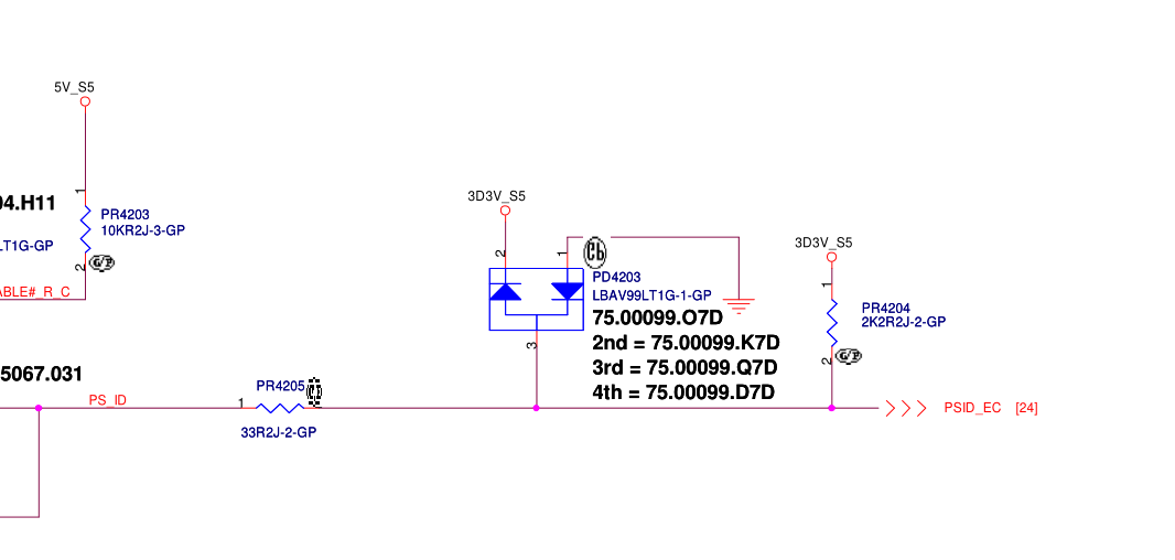

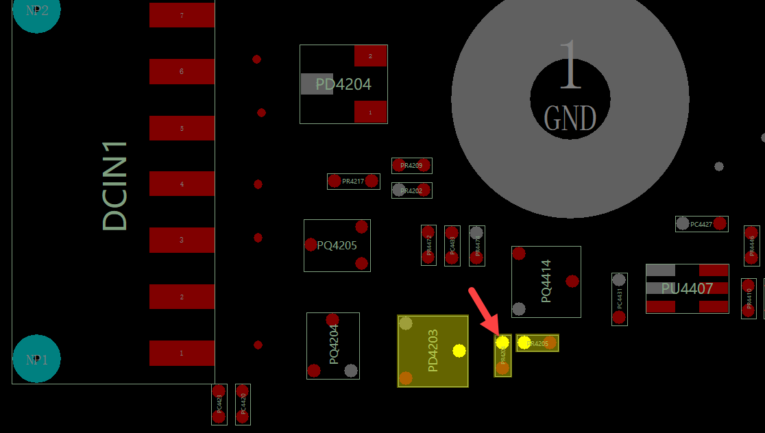

    voltage reading @ PD4203 ?
