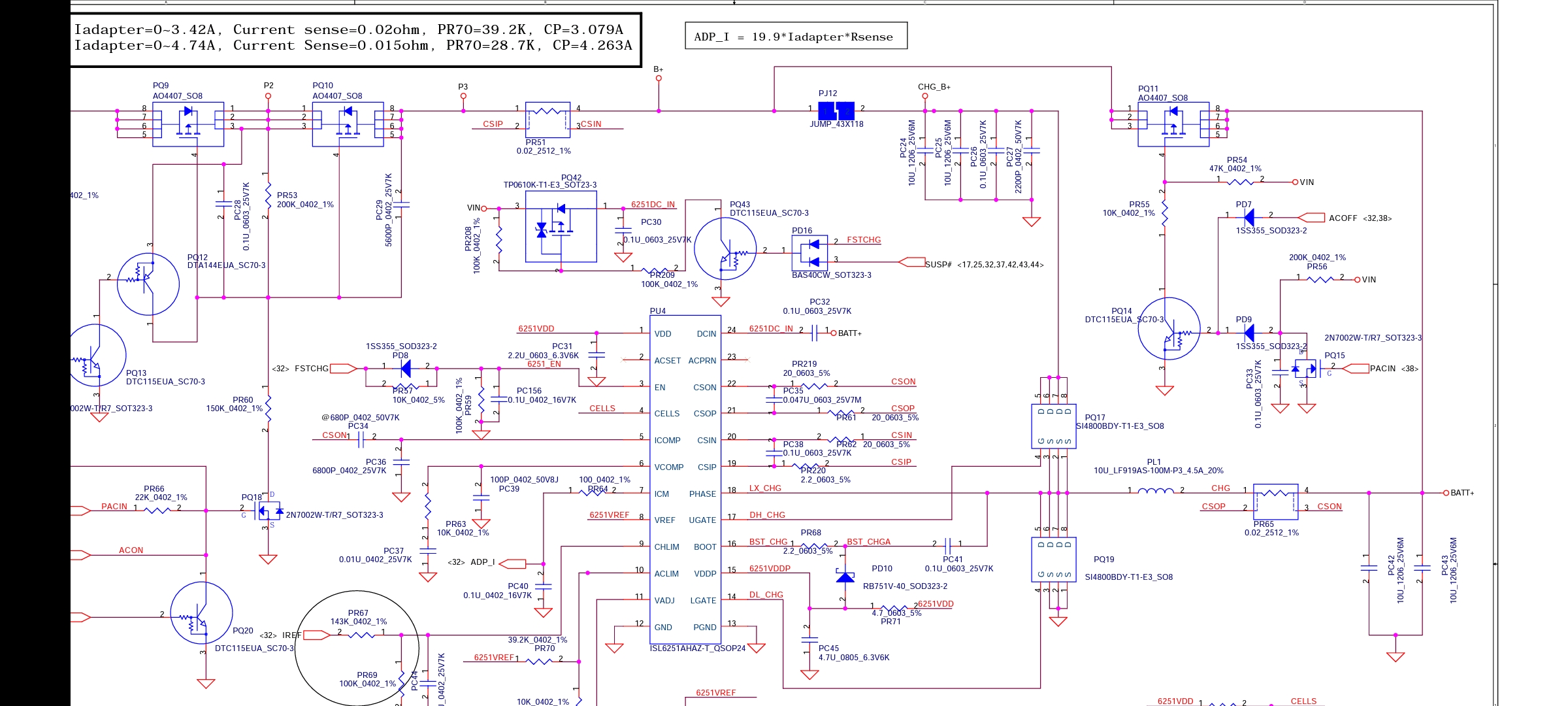

    La-3691p battery charging isu
    Laptop come for battery replace I buy new battery after installed new battery laptop power on new battery that was 33℅ charged but when I connect adupter it's shows plug in charging but it won't charge. So i opened laptop found some repair worked on charging section but it was strange for me when I checked battery charging MOSFET with battery connect it was 18 v on drain 18v on gate and 11.1 v on so

    Re: La-3691p battery charging isu
    Can you post the schematic ? The thread on this forum with a schematic for this logic board seems to be corrupt and does not load for me.
    Update - ignore - had a local Adobe reader issue. Have 800,000 windows open...
