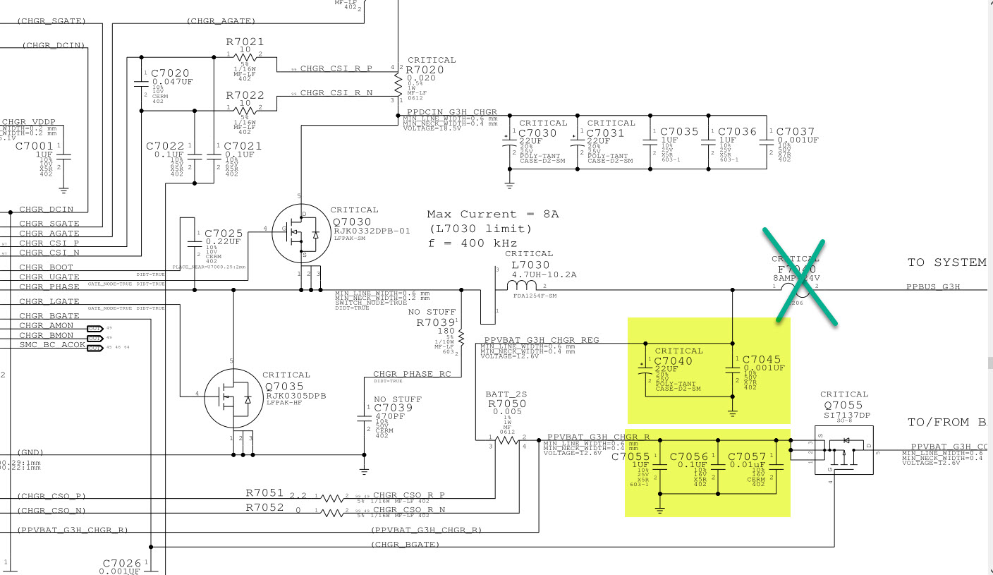

                    • mon2
                      • Dec 2019
                      • 14003
                      Re: 820-2850-A: battery not detected
                      So the fault is in the source side = U7000 circuit. The input voltage to U7000 is good.
                      Perhaps one of the caps are damaged / shorted.
                      See attached.
                      Start with removing (just for now), the current sense resistors @ R7051 - remove only this one and then check if the resistance has changed on this line. Do not lose the resistor.
                      If no improvement on the resistance, proceed to remove the resistor @ R7052. Measure again. Do not lose the resistor.
                      Any improvement on the resistance ?
                      If you remove one leg of L7030 then you can create an isolated island of parts to narrow down which cluster of parts has the fault. However, L7030 will be with heavy solder and copper plane. Proceed to lift one leg but only if you feel comfortable.
                      Alternatively, as a guess, perhaps the fault is in one of the highlighted caps.
                      Consider to lift one leg of the 22uf @ C7040. Once the one leg is lifted, check the resistance to ground again on pad # 1 of fuse F7040.
                      Do not power up with these parts removed till the root cause can be fixed.

                            • mon2
                              • Dec 2019
                              • 14003
                              Ok. This confirms the short is to the left side of the schematic of U7000. That is, to the LEFT of L7030.
                              Still leave off L7030 till the root cause can be located. The other parts can be placed back on since they are innocent. If you do find that pin # 2 pad of L7030 sinks on the resistance then there is a fault on this group of parts but sounds like the fault is upstream.

                                L7030 pad 1 = 170 Ohm
                                L7030 pad 2 >20 MegaOhm
                                C7030 pin 1 >20 MegaOhm
                                • mon2
                                  • Dec 2019
                                  • 14003
                                  Ok. Post the resistance to ground for C7030.
                                  Mosfet Q7035 may be shorted.
                                  After the above resistance check, do the follow (resistance checks are always with the power removed)
                                  Measure & post:
                                  resistance between SOURCE (1-2-3) & DRAIN (5-6-7-8) of Q7035
                                  resistance between SOURCE (1-2-3) & GATE (4) of Q7035
                                  resistance between GATE (4) & DRAIN (5-6-7-8) of Q7035
                                  Post each reading.
                                  • DrFalken
                                    • May 2008
                                    • 122
                                    Measure & post:
                                    Post each reading.
                                    Q7035 left on board:
                                    resistance between SOURCE (1-2-3) & DRAIN (5-6-7-8) of Q7035 = 171.3 Ohm
                                    resistance between SOURCE (1-2-3) & GATE (4) of Q7035 = 46.9 Ohm
                                    resistance between GATE (4) & DRAIN (5-6-7-8) of Q7035 = 220 Ohm
                                    Sorry but I've to leave but will back tomorrow: if You have anything else to check, please post and I'll report tomorrow
                                    Thank you very much for your guide !
                                    • mon2
                                      • Dec 2019
                                      • 14003
                                      Remove Q7035 from the logic board.
                                      Then check the resistance to ground of L7030, pin # 1 pad again.
                                      If the resistance improves and is no longer low, proceed to:
                                      a) check the resistance across the same combination of pins on the removed Q7035 mosfet. Likely the low resistance values will show while the part is no longer on the logic board.
                                      b) check the resistance to ground of the PCB pads where Q7035 was soldered to confirm that U7000 is not to blame. If there are low resistance readings with Q7035 off, post the values and can troubleshoot further.
                                      Suspecting that Q7035 is defective and needs to be replaced.
                                      • DrFalken
                                        • May 2008
                                        • 122
                                        Q7035 removed:
                                        L7030 pad #1 > 20 MegaOhm
                                        Q7035 readings:
                                        resistance between SOURCE (1-2-3) & DRAIN (5-6-7-8) of Q7035 = 174.3 Ohm
                                        resistance between SOURCE (1-2-3) & GATE (4) of Q7035 = 49.6 Ohm
                                        Resistance of PAD 1-2-3 to GND = GND
                                        Resistance of PAD 4 to GND > 20 MegaOhm
                                        Resistance of PAD 5-6-7-8 to GND > 20 MegaOhm
