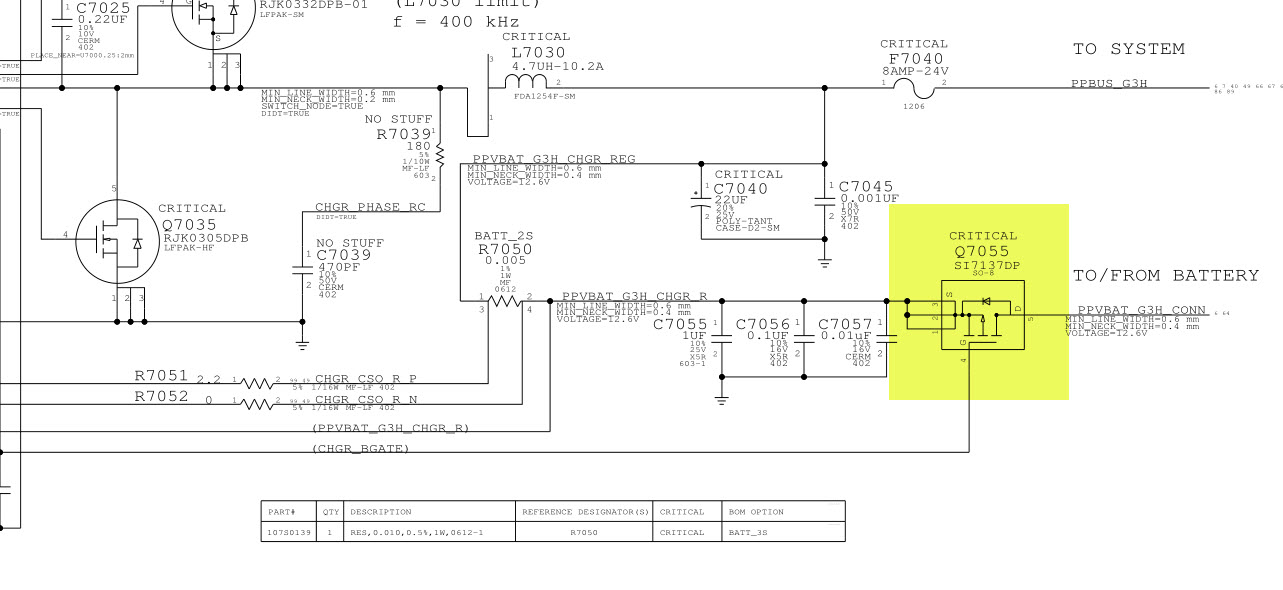

                  Remove all power and check the details of the battery mosfet @ Q7055.
                  Meter in resistance mode (2k scale).
                  Measure & post the readings for:
                  source (1-2-3) & drain (5-6-7-8)
                  source (1-2-3) & gate (4)
                  gate (4) & drain (5-6-7-8)
                  Searching again for a low resistance.
                  Also, while in resistance mode, check the resistance of D6950 (dual ESD diode) pins 1 & 2. Both should be of a HIGH resistance otherwise, D6950 is defective.
                  If the readings are NOT of a low resistance then power up again with the battery.
                  Post the voltage readings of Q7055 battery mosfet for:
                  source (1-2-3)
                  gate (4)
                  drain (5-6-7-8)
                  While you are in voltage mode, check the voltages present on pins 1 & 2 of the dual ESD diode @ D6950 (pin # 1 & 2). Ideal case is that these are with ~3v3-~3v42 each since these open-drain lines are each pulled upto 3v42.
                  Any chance your battery is still charged ? If not, this test will have to do.

                    #29
                    Re: 820-2850-A: battery not detected
                    Originally posted by mon2
                    Ok. Good readings on the replacements.
                    Readings on Q7055
                    source (1-2-3) & drain (5-6-7-8) > 2MegaOhm
                    source (1-2-3) & gate (4) > 2MegaOhm
                    gate (4) & drain (5-6-7-8) 2MegaOhm
                    4 KiloOhm
                    source (1-2-3)
                    gate (4)
                    drain (5-6-7-8)
                    Voltage readings of Q7055 with the battery:
                    source (1-2-3) = 9.74V
                    gate (4) = 0
                    drain (5-6-7-8) = 9.74V
                    D6950 pin 1 = 0
                    D6950 pin 2 = 0
                    But probably the battery is almost empty...
                    Note: both F7040 and L7030 are still removed from the board

                              6) The battery mosfet is still a suspect @ Q7055.
                              Remove all power. Meter in resistance mode (2k scale).
                              Measure the resistance for:
                              For these checks, you will use red meter probe on one pin group & black meter probe on the other pin group. Repeat for each 3 of the tests.
                              The voltage that you are presently reading is from the partially charged battery ending up on PPBUS_G3H.
                                  source (1-2-3) & drain (5-6-7-8) > 2 MegaOhm
                                  source (1-2-3) & gate (4) > 2 MegaOhm
                                  gate (4) & drain (5-6-7-8) > 2 MegaOhm
                                  Q7055 readings:
                                  • mon2
                                    • Dec 2019
                                    • 13994
                                    #37
                                    Q7055 resistance is fine.
                                    Remove the battery, leave off F7040 fuse.
                                    With the adapter connected, carefully measure & post the voltages on each pin of the U7000 IC.
                                    U7000 may be defective but will know more after these measurements.
                                    Also, PPBUS_G3H normal voltage may be lower for this logic board but it certainly should not be as low as you are reading. So far, this is showing that the battery voltage is passing through onto the PPBUS_G3H common rail ok but U7000 side is not creating a similar voltage when the adapter is connected.
