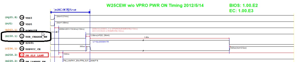

    Dear forum,
    I have a Clevo W25CEW Notebook which died. It worked perfectly, but then it stopped working.
    As I see it tries to power on (drives RAM power supply etc.), but then turns off after less then one second.
    Bios and EC were flashed, same issue.
    I also see power consumption at 19V switching between 0,1 A and 0 A.
    19v rail is fine. I also see 3v3 and 5v (VDD5 is there/ 5v & 5VS is there for a short time and then goes to 0V, exactly same for 3v3, see page 34)
    On bios chip I see between 0 and 3v3, with the power cycling.
    All inductors show normal values in my opinion.
    Resistance @ HM77 is around 55 ohms - normal I guess?
    Service manual is here - where to start?
    https://www.manualslib.com/manual/11...vo-W25cev.html
    Thanks in advance.
    Edit: From power sequence I see that RSMRST is present, but then problems occur, USB_CHARGE_EN is also cycling

    I have measured resistance of PLT_RST to ground and it is 15-17 Ohms, is that too low?
