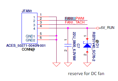

    FAN is controlled by SIO chip. On its connector you have GND and +5VDC and there are two more signals:
    FAN1_PWM - control voltage produced by the SIO and the speed of the FAN is directly proportional to this voltage
    FAN1_TACH - this voltage is feedback information about the actual speed of the fan.
    Did you try with another fan? It is possible that its feedback information is faulty and therefore control signal is not generated.
    It could also be possible that something is wrong with the SIO chip and that is much harder to replace.

      These signals are not DC, when the FAN spins theres pulses on both, when it dosn't work
      PWM is stady LOW
      TACH is stady high
      They are comming directly from SIO, but is there another reasons for not starting the FAN?

        these signals are DC even though not constant. PWM is Pulse Width Modulation. It represents series of pulses typical frequency of about 10 kHz, so the multimeter should measure some average DC voltage. If I'm not mistaken, the pulses go from 0V to 3.3 V.
        Just for test, you can try to connect 3V to the FAN_PWM input to test if the fan works and produces feedback voltage on TACH.
        The fan should start spinning immediately after laptop is turned ON on DELL 7440.

          I It is a brand new FAN, and I have also testede it.
          I have cut PWM signal, then the FAN runs at full speed.
          In case it was the pull up resistor, I have supplied 3.3V throug a 10K resistor to PWM Pin, and it is still LOW, so it IS SIO that pulls it down.
          The funny this is, that sometimes the FAN run when I power down.

                      Well, If I were you, I would use +3.3V_RUN and connect it to the FAN jut to test.
                      Your FAN has 4 wire (RED 5V, Black GND, Yellow is feedback voltage - RPM, and Blue is control PWM signal).
                      I would cut red wire from and connect it to +3.3V_RUN to test if the fan is spinning. This 3.3V should go to FAN only and not on the motherboard.
                      Something like Sorin did here:
                      https://www.youtube.com/watch?v=ocTOD0vBFgc
                      If that doesn't work, try to connect it to blue wire also, but only to FAN and be careful no to touch pad on the motherboard. I would cut wires and left connector in the slot intact. This new voltage 3.3V should come only to the FAN.
                      I don't think you have anything to lose.

                                Back to this issue, i think it's a common fault.
                                same lap with same motherboard (la-9591p) with a same behaviour....fan not working..display present.
                                If i power on the lap without ram the fan is working proprely..but with ram no chance.
                                i try official bios , another fan , à multiples ram but still same behaviour.
                                jfan1 with ram :
                                pin4 =5v present
                                Pin2 = fan1 tach 3v
                                ​​​pin3 =fan1 pwm 0v
                                jfan1 without ram :
                                pin4 =5v present
                                Pin2 = fan1 tach 1.6v
                                ​​​​​pin3 =fan1 pwm 1.6v.
                                R408/R376 pullup resistor are ok =10kohm.
                                when i try for test with a tweezer joint the 2 side of R408 the fan start working at full speed.
                                see all the discussion before can i cut the red wire 5v and 5v connect the part that go straight to fan with 3v run!..and remplace r408 with 0ohm Résistance !​
