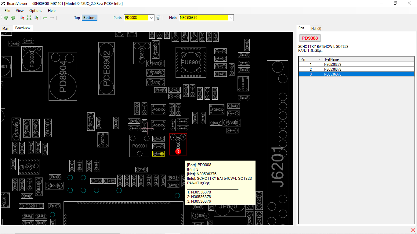

                  so it's like this, when the adapter is connected, pin number 5678 acfet has 19v, and pin 1234 is 0v
                  then on pin 1234 rbfet 0v too, but on pin 5678 there is 5v
                  I also wonder why it can be like this, maybe there is a problem in the battery line, or is there a problem with the regn which is leaking and draining 5v?

                      If there is no battery connected and if the adapter is connected, then this 5V can come only from the input 19V via IC chip. There is no other explanation.

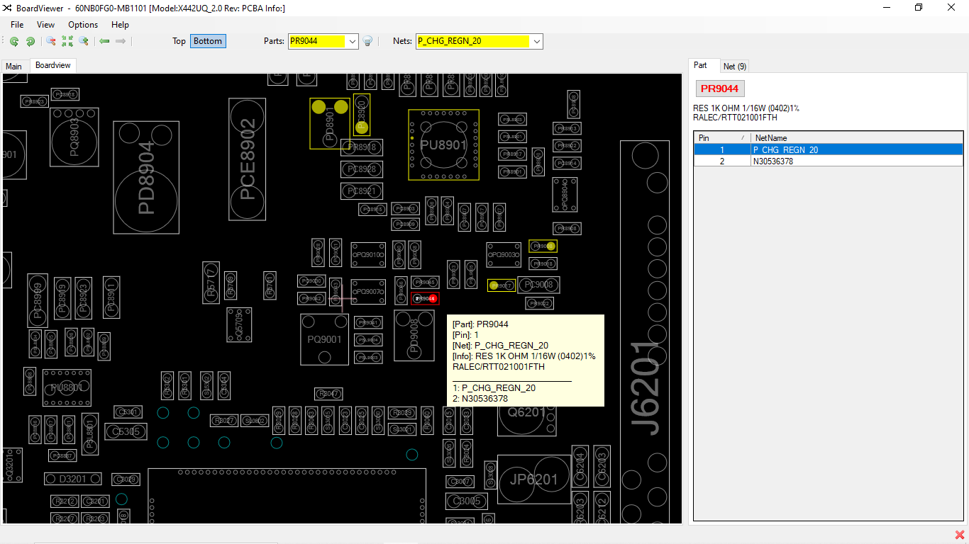

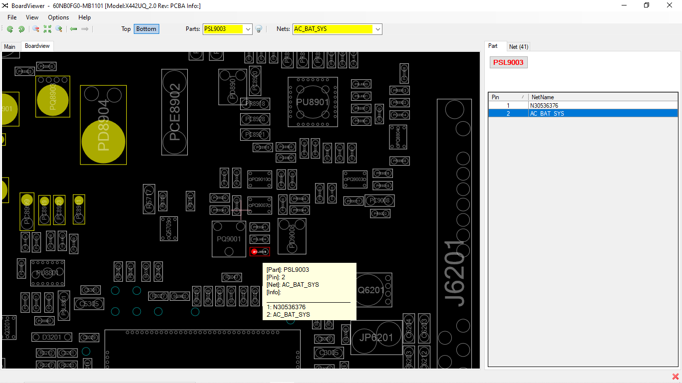

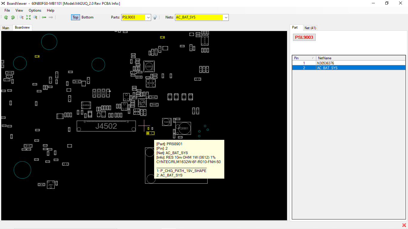

                        Do you feel comfortable with the replaced charger IC ? Consider to flux it and hot air till it swims into place with tweezers. Just to rule out any possible shorts underneath the QFN package pins.
                        Also observing that the replacement is from TI vs. the original used by Asus. According to the internet, the 2 devices are cross compatible. Is this 100% confirmed ?
                        Yes, I'm sure sir, I've replaced with 3 ICs, but still the same one of the ICs is indeed damaged, but the other 2 ICs are still good, and work on other Mobos, after I searched, there is indeed a Regn that can penetrate anc
                        please open this picture from the first order shows the path of screenshot 4 until screenshot 8
                        • Adenitz
                          • Jan 2021
                          • 122
                          • Congo
                          #52
                          Re: Asus x442u cant use adaptor
                          Thos is quite possible, since REGN is about 6V and is generated internally inside the chip. If possible, remove the chip and measure resistance between REGN and ACN/ACP pins on the motherboard. Maybe this is shorted not inside the chip, but on the mobo itself.
