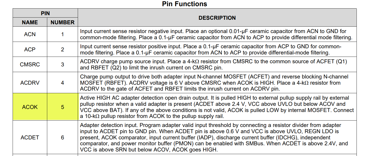

      May I ask, is it true that ACOK for normal conditions is 5.2v?
      I think this pin should have a voltage of 2.8v?
      correct me if i'm wrong

          According to the TI datasheet for this part, ACOK is an open-drain output.
          So if ACDET > 2v4 then this ACOK will be floating. It is upto the external pull-up resistor to define the 'high' value. The pull-up voltage of 5v0 is fine for this pin to be considered OK.

              I've never seen ACOK at 5.2V on BQ24780(S). It should be 3.3V as the pull up resistor is always from 3.3V ACDRV will work only when CMSRC is 19V. So do check that. Is there 19V on charging Coil??
                thank you for taking your time to help me, then at what parameter is the volts when ACOK is on high?

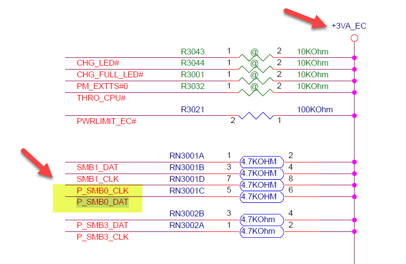

                      Confirm the voltages on pins 1, 2 and 3 again for the charger IC.
                      The SDA and SCL lines are missing their pull up voltage. Trace these lines to the local pull up resistors. The other side of each resistor will go to an always on rail of 3v3.
                      That regulator is not working to supply the missing rail.

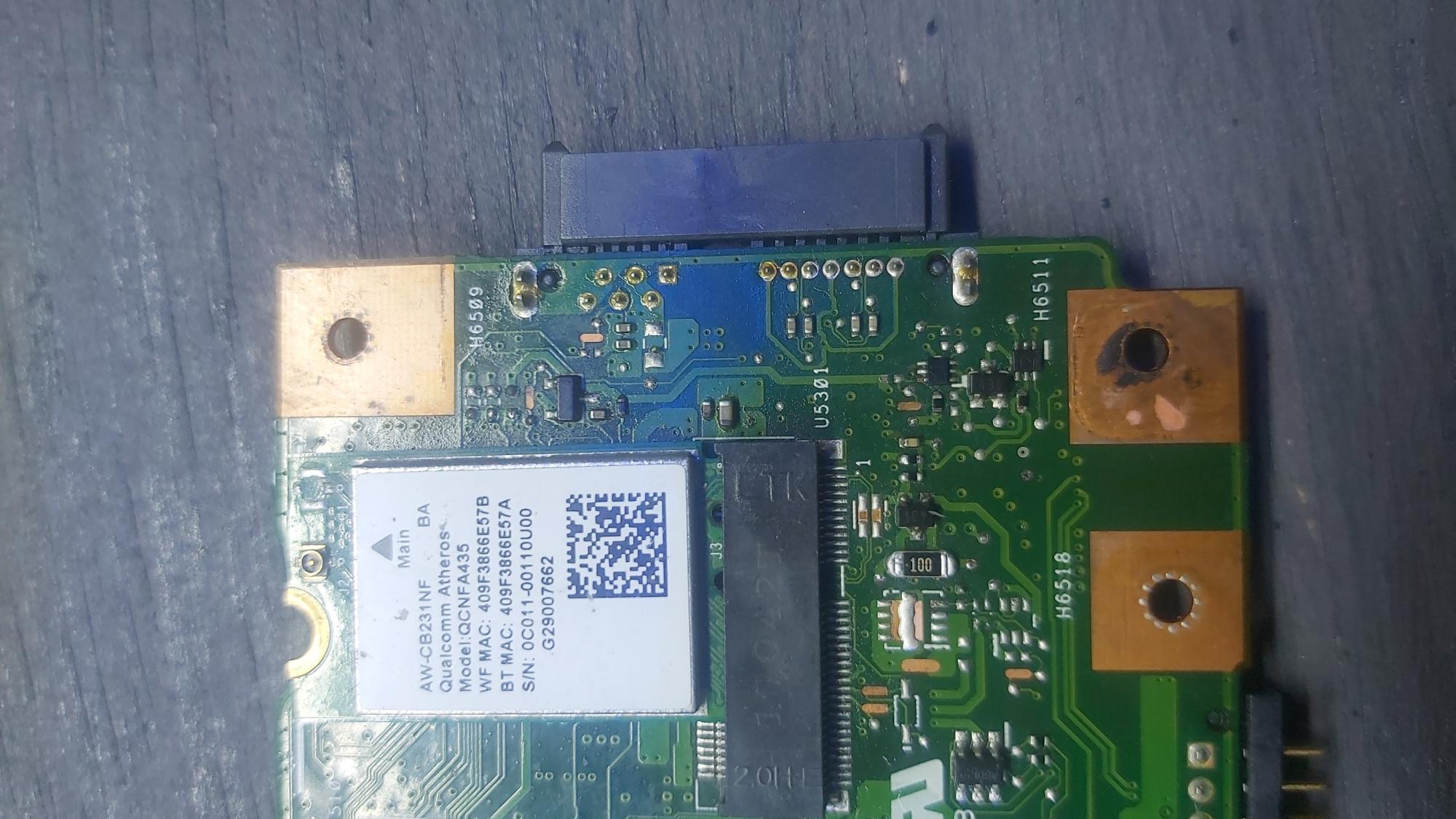

                          I found a 6 pin diode parallel to 2 resistors connected to the sda and scl lines, and on pin number 5 there is +3va and on pin 3,4 is the source of sda 0v and scl 0v too

                            No. The I2C (SMBUS) SDA & SCL lines are not broken but each should have a pull-up resistor. The other side of each resistor should be pulled up to +3v3.
                            The +3v3 rail is missing.
                            1) See attached. The schematic for this logic board looks to be very close to yours for the charger IC. This should help for this case.
                            2) Check the resistor values for the requested parts. Remove all power. Meter in resistance mode. Measure each resistor value.

                              Post a picture of the DIODE you are referencing and will see it can be found in the schematic.
                              Where is it on the boardview file ?

                                is the schematic you gave is suitable for this board?
                                the diode is at the top of the board near the battery connector and the code for this diode is PD6001 bro.

                                    you are right bro, the source of sda and scl is +3va_ec which is on the RN305 near EC, after I measured it turned out that +3va_ec was indeed missing

                                      +3V LDO will be missing as perhaps 19V is not passing thru on this board. Since 3V PWM is not getting +19V as VIN ,it cant produce +3V LDO. So dont bother about SDA/SCL at this moment. You need to check why charging IC ACP/ACN is not 19V. Thats the 1st step for repairing this mb. Stay focussed on this issue alone till you fix it.
