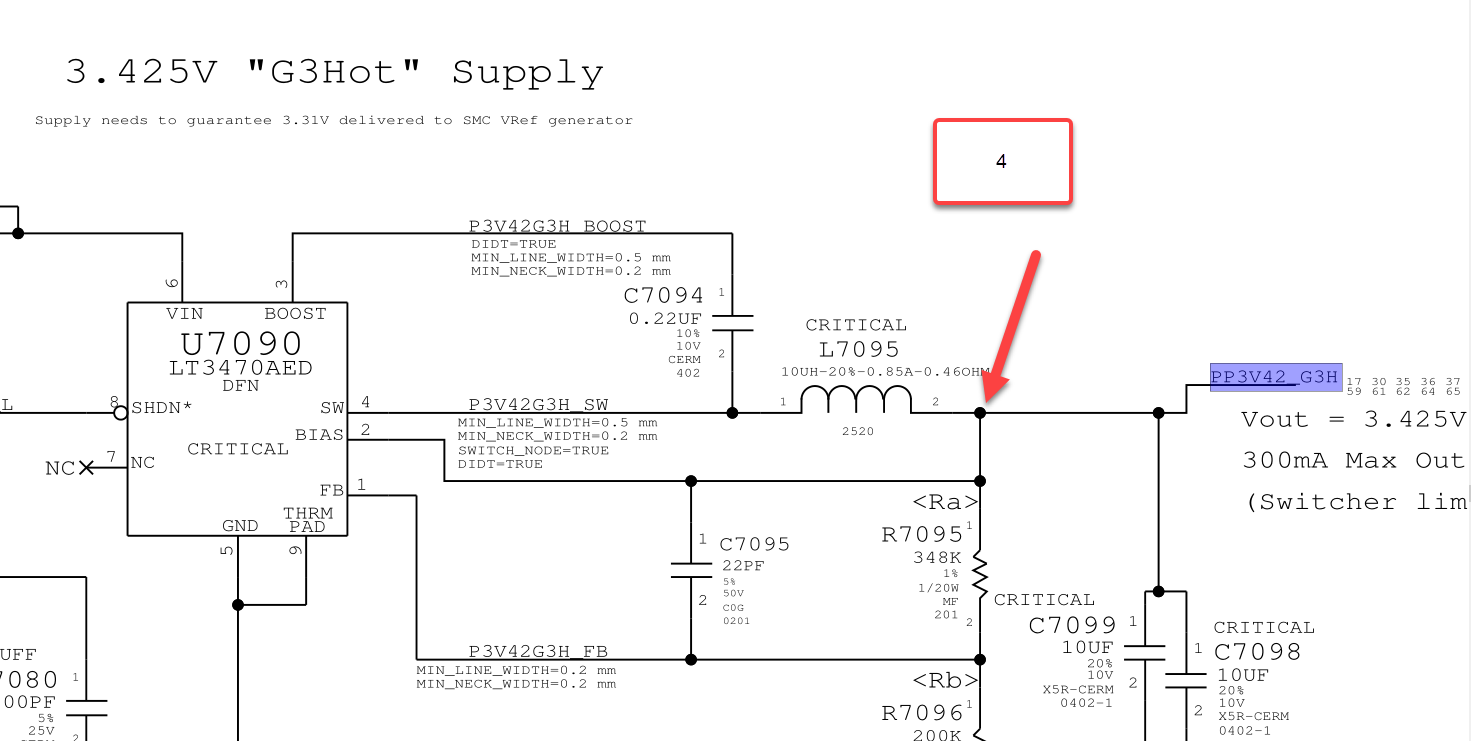

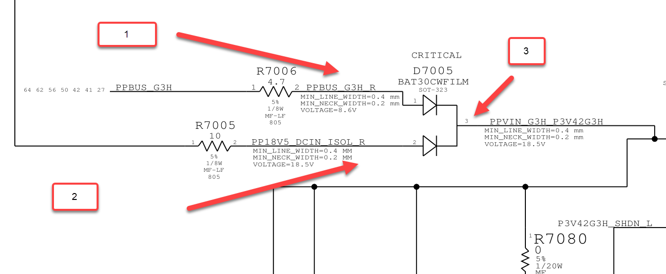

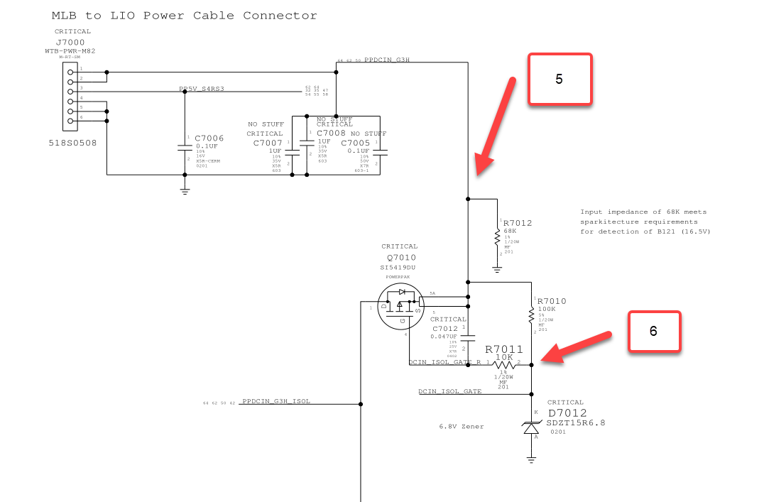

    Re: macbook, 820-00165 turns on, magsafe light off and does not charge
    Are you using an official power adapter from Apple ? (not a clone)
    See attached.
    Meter in DC volts scale (20V should be ok).
    Attach your (official) power adapter.
    Post the voltages for each requested location. Magsafe light needs 3v42 to operate so that is the first area for your investigation.

      I get the correct voltages in those points,
      PP3V42_G3H 3.42V
      PPVBAT_G3H_CHGR_REG 8. 5 L7130
      SMC_BC_ACOK 3.3V
      SMC_ONOFF_L 3.3v
      SMC_RESET_L 3.3v
      SYS_ONEWIRE missing 0.4v
      the mac the fan runs, works fine without battery, magsafe light off
      with battery it starts but shows me the low battery symbol, not charged and magsafe light always spent.
      sys_onewire not shorted but not generated,
      can I test the DC Board if it generates sys_onewire?
      original power supply 14.85V 45W

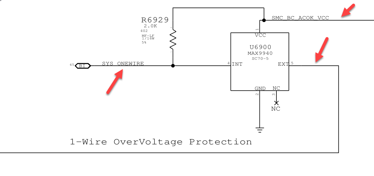

              See attached. Post the voltages on U6900.
                i have a main 820-00165, sys_onewire does not go from u6900, goes direct from smc U5000 to J9500,
                c is continuity of signal between the two points, do you have any other advice? thanks

                      The sys_onewire circuit is identical to that of the older MAC's, just that the AND gate and protection IC's are on the DC IN board. For reference, they are just to the right of the audio connector on the DC in board. For them to work, you need to confirm you have SMC_BC_ACOK and PP3V42_G3H on the board. I assume you have checked a known good DC IN board and LIO flex cable, so check the presence of these signals at J9500 and on the DC IN board AND gate and protection IC. You can also put a CRO on the sys_onewire testpoint too to see what activity you have.

                        thanks for the advice, U6901 pulled down smc_bc_acok vcc on U6900, replaced u6901 all back working, battery charged magsafe led on
