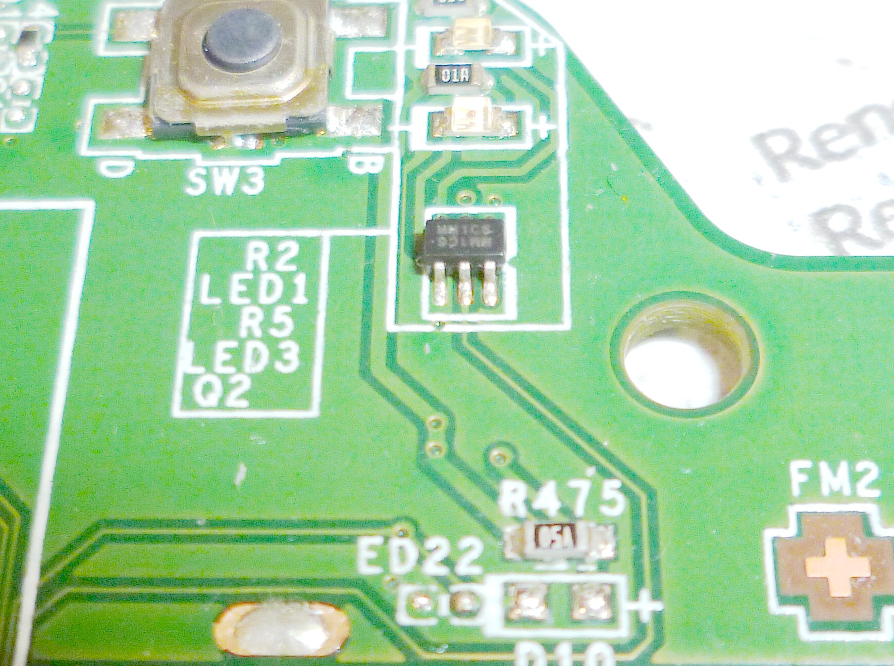

    I am trying to identify an IC that is on the power switch of a MSI laptop, as shown in the picture. It is either marked MM1C6 or MMTC6, not sure.
    Any help would be greatly appreciated!

    It could be a diodes Inc. 2N7002DWA ,MM1 plus 2 digit Year/Month code,and the same code marked upside down
    https://cdn.badcaps-static.com/pdfs/...be6b9cde44.pdf
    Post the laptop model number and motherboard part number please,so that it can be added to the thread title

      The laptop model is MSI GP72 2QD Leopard and the motherboard model # is MSI ms-16j3a.

        It sure looks like the correct component. New number is dmn65d8ldw
