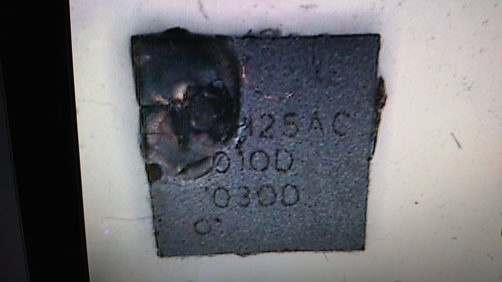

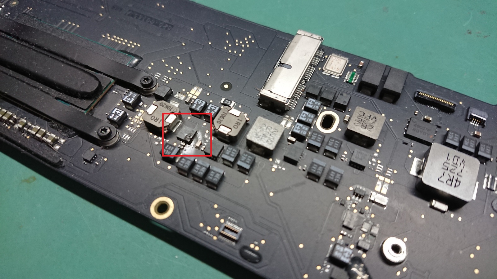

Please identify IC on MacBook Air 13 1466
  • NTBservis
    • Jun 2016
    • 32
    • Czech
    Please identify burnt smd IC on motherboard 820-00165-A

    Re: Please identify IC on MacBook Air 13 1466
    Review the board view file for this pcb.
    Then select the part and locate the same inside the schematic for this logic board.

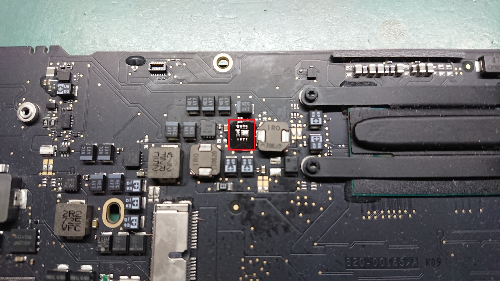

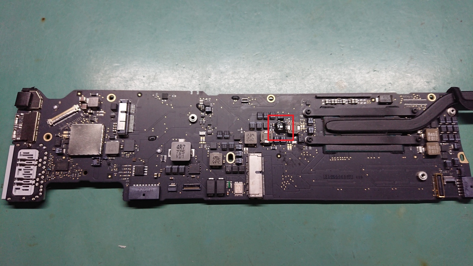

      Q7630 (FDPC1012S). This is the for the +1.05V supply for the PCH though. Any liquid damage around this converter (or FET failure) usually destroys the PCH unfortunately.
        That's the dual fet for switching 1.05v to the PCH, check for impedance L7630 (close to the fet) if its less than 0.10ohms you likely have a fried CPU
