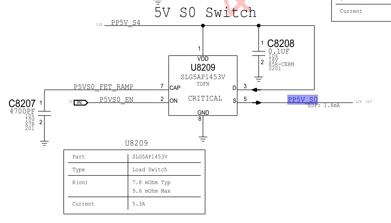

                      Re: Macbook A1707 short on PPBUS - nothing gets hot
                      pp5V_S0 does not look healthy.
                      Disconnect (if not done already) the LCD; keyboard; trackpad.
                      Be sure that the keyboard connector area is clean of any possible corrosion. IPA is great with a Q-tip.
                      The above rail is all over the logic board starts with a load switch. See attached.
                      What is the resistance to ground of Pin # 1 (U8209) ?

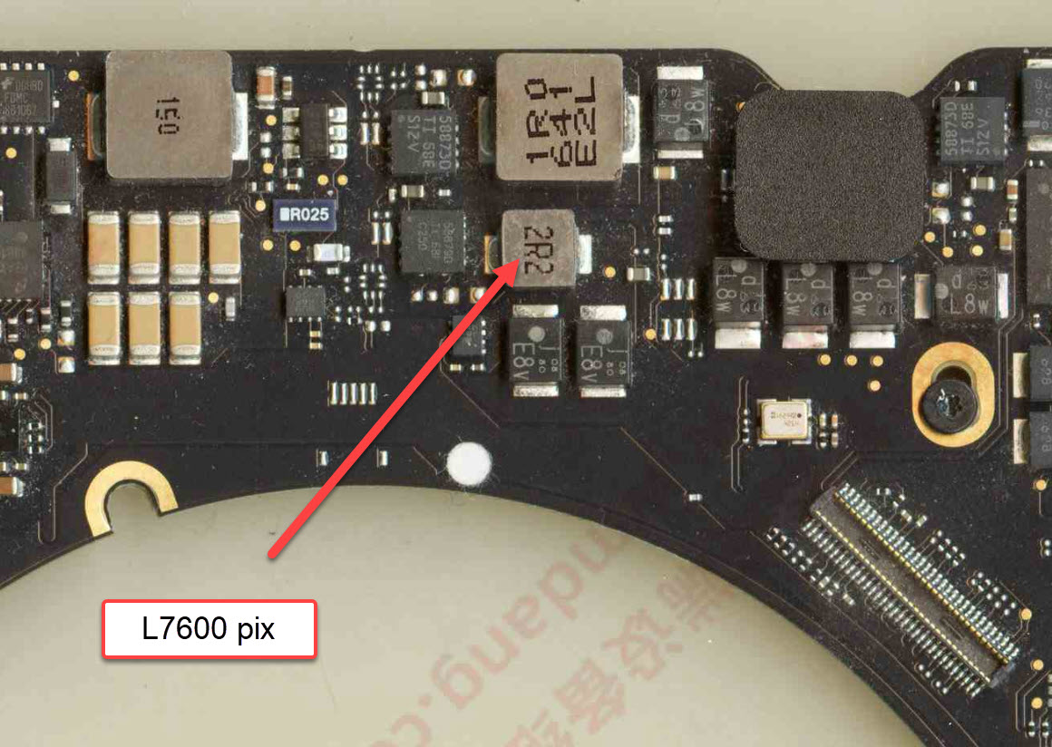

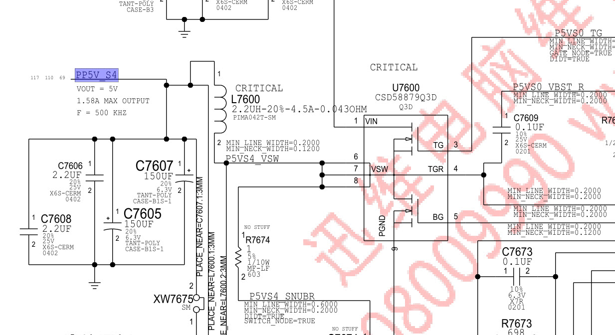

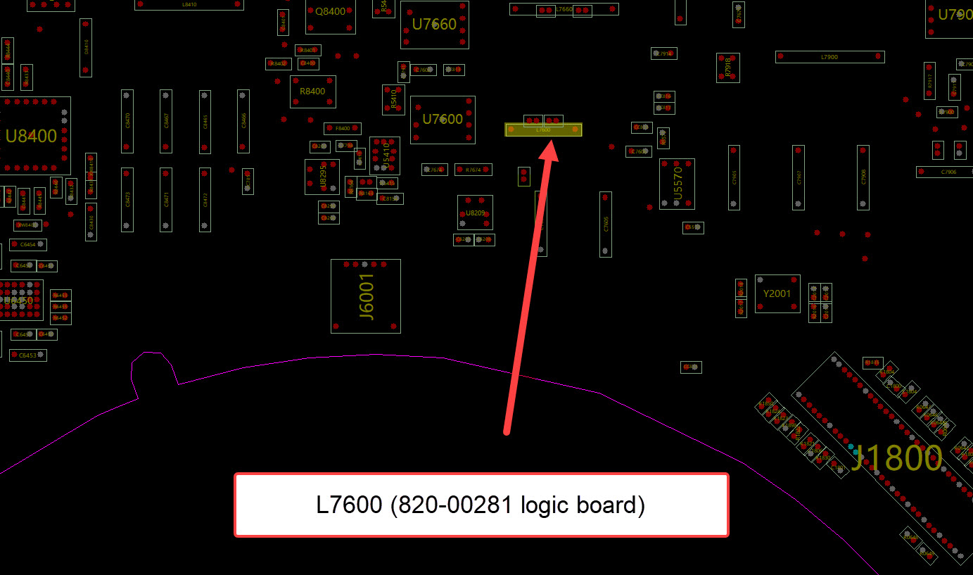

                          See attached.
                          Locate L7600 inductor. A bit of a pain but lift one leg of this coil - carefully. Use flux and heat to melt the large SMD pad to isolate the 5V rail.
                          Do not power on in this condition.
                          Meter in resistance mode.
                          What is the resistance to ground on L7600, pin #1 pad ? pin #2 pad ?
                          • JM1010
                            • Sep 2021
                            • 16
                            Thanks Mon, just momentarily pulled it out to take a reading. Unfortunately this short is on the PP5_S4 side (3.4 ohm)Sorry I forgot to record the other side but it did not beep.
