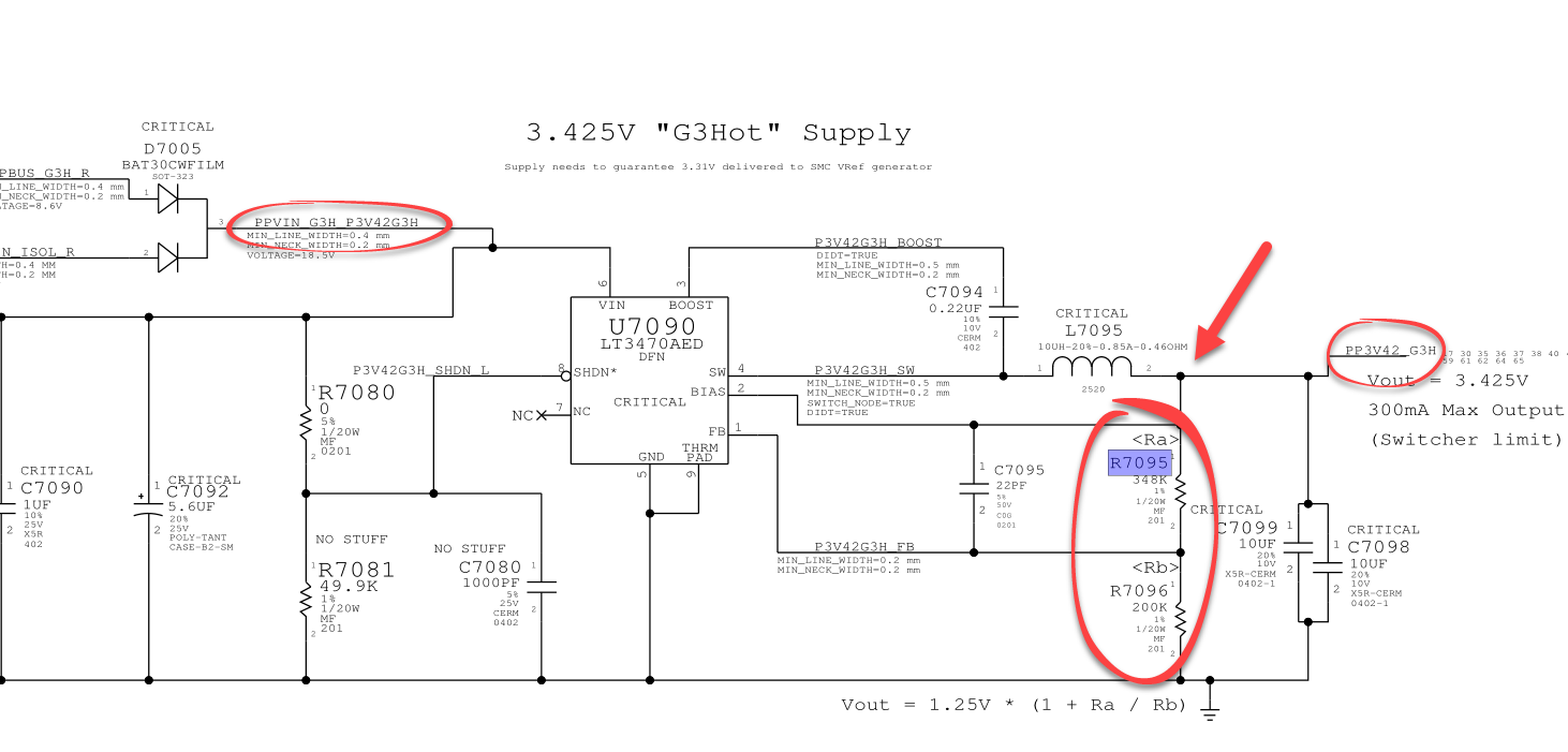

        Voltage reading of PPVIN_G3H_P3V42G3H ?
        PP3V42_G3H 3.38V
        This rail is low. It should be 3v42. Power down and post the resistance to ground for L7095, pin #2.
        Also confirm the resistance of the voltage feedback resistors that dial up the required 3v42 voltage setting @ R7095 and R7096.
        https://www.logi.wiki/index.php/PP3V42_G3H
        You can find the normal voltage values for your logic board here:
        https://www.logi.wiki/index.php/Power_Rail_List
        As noted, 3v42 is required so something goofy is going on here.

          L7095 pin#2 is 3.39
          R7095
          pin#1 3.39V
          pin #2 1.28V
          R7096
          pin#1 1.28V
          pin#2 GND

                r7096 has 183K resistance. should be 200k.
                R7095 has 250k. should be 348k.
                could this be the issue? should i replace them ?
                    Yes. While the resistors may have different readings while on the logic board, remove each resistor and measure again out of circuit.
                    If the values do not match the schematic, then yes, recommend to replace them.
                    You should have 3v42 on this rail. The rail is a low current one so it cannot support too much of a load. Respectively, a bad cap on the rail can cause it to droop. Start with your resistor review.
                    DO NOT POWER up without these resistors in place. Otherwise the regulator will spit out the wrong and possibly higher output voltage and kill everything downstream!!!
