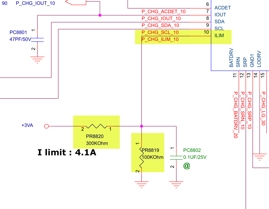

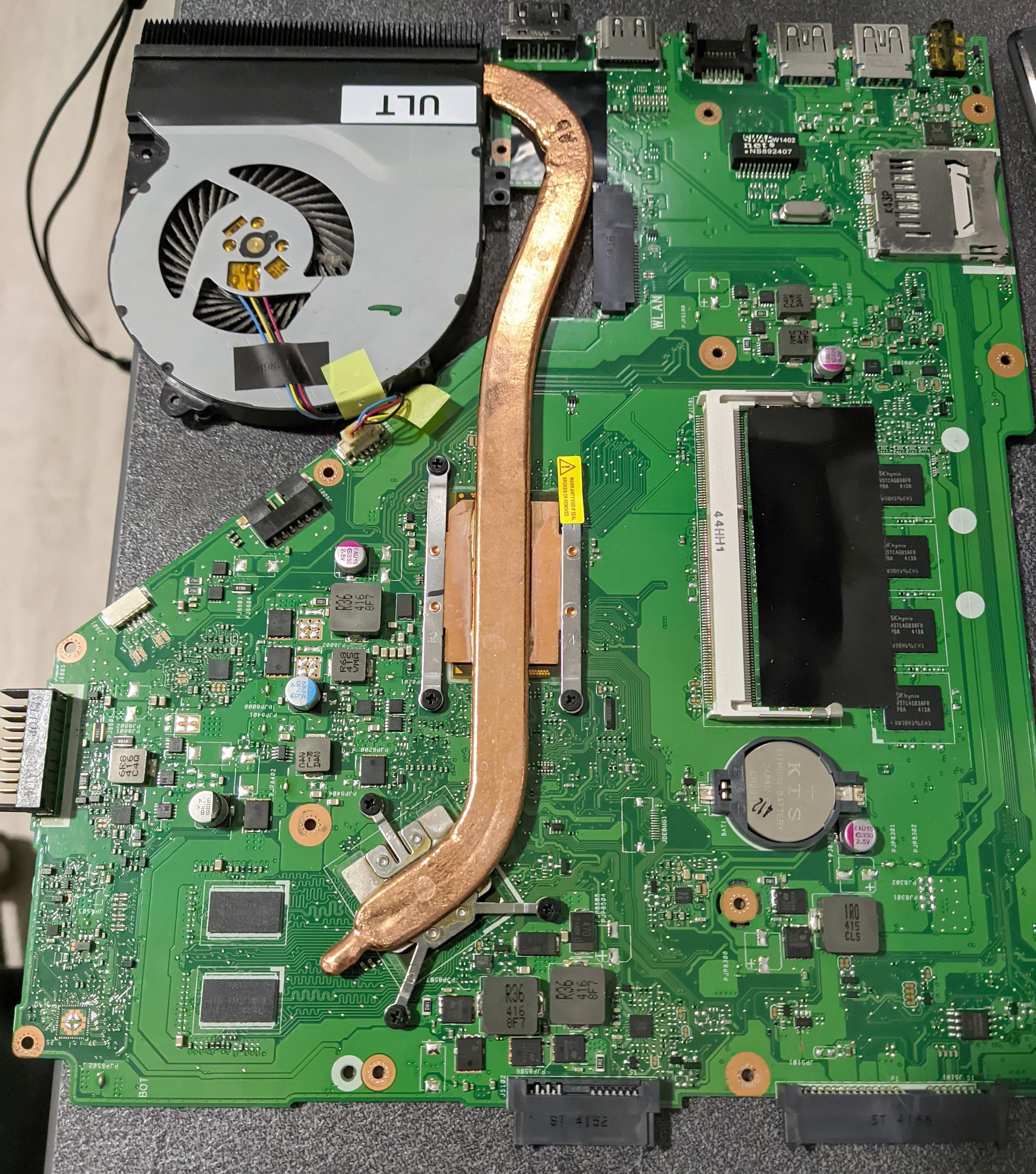

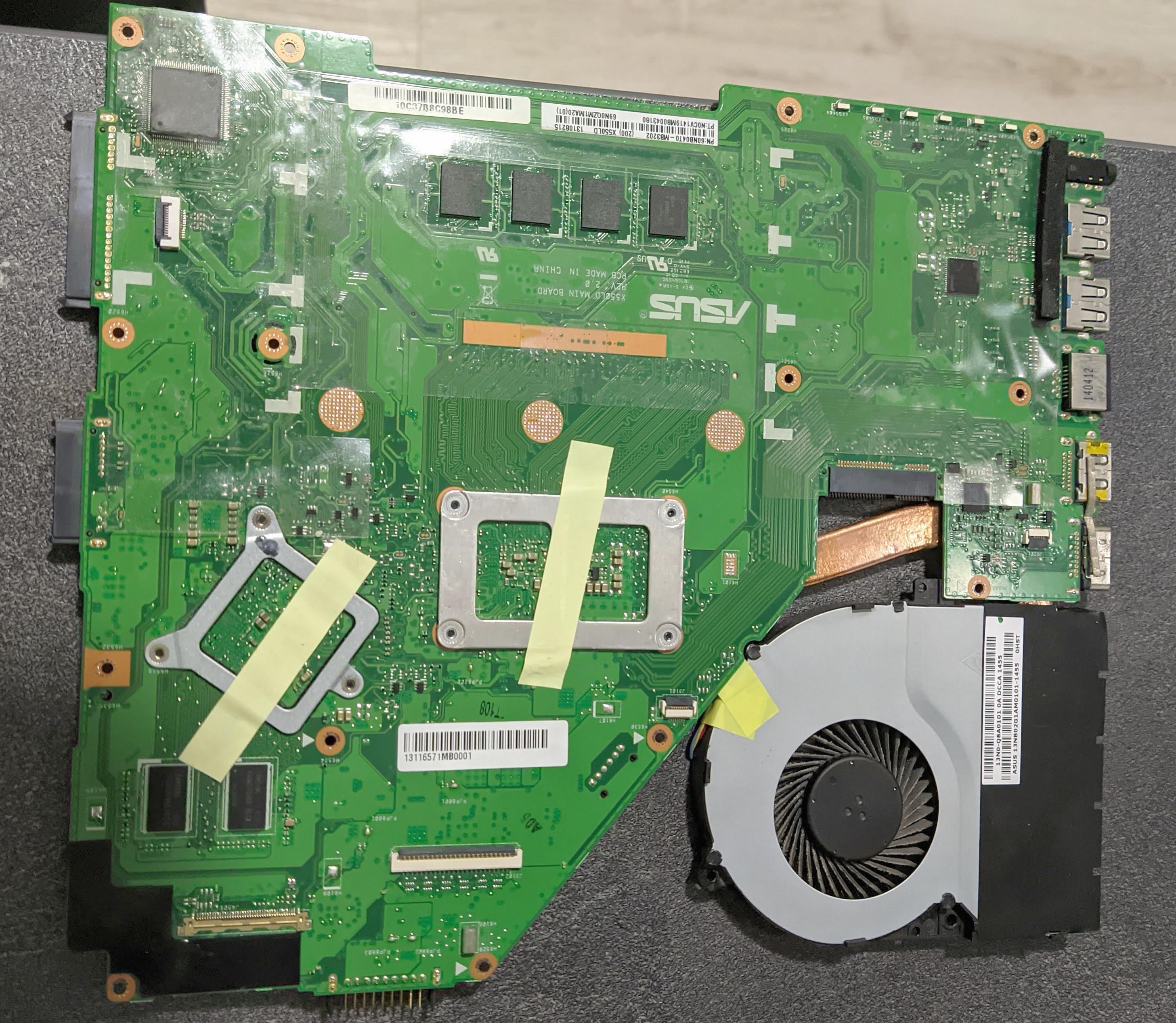

    Hi all
    I have a Asus X550LD laptop (cpu intel i5 4200u, gpu nvidia 820M) here that refuses to turn on.
    No visible physical or water damage on the board.
    CMOS reset; coin battery is fine; plug is fine (gets 19,5v up until a certain point and 3,3v to the battery charging plug); power button discharge done; still nothing.
    The interesting things that I've noticed:
    -when power button is pressed, all the front LEDs flash once, in sequence and then only the far left one stays on for a second, then turns off as well.
    -i hear a pulsating (cca. once a second) high frequency "whine". when measured on a certain point (forgot which one exactly), the voltage jumps up and down.
    I have the boardview schematic and guide, but don't know how to use them ^^
    Thanks for the help

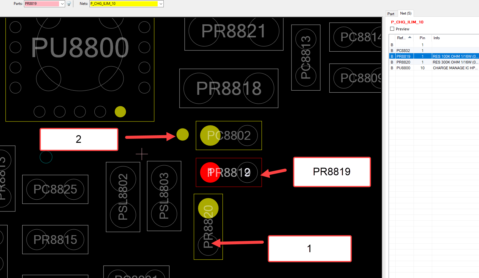

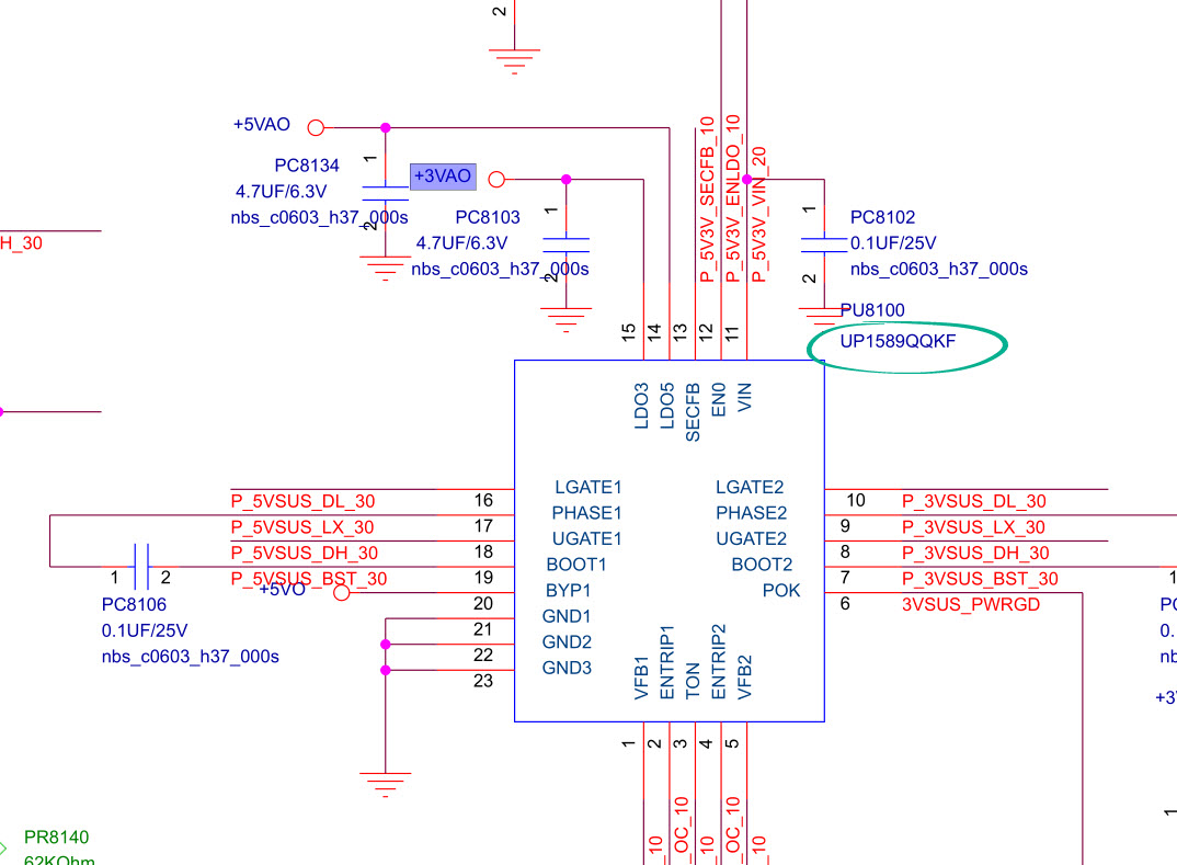

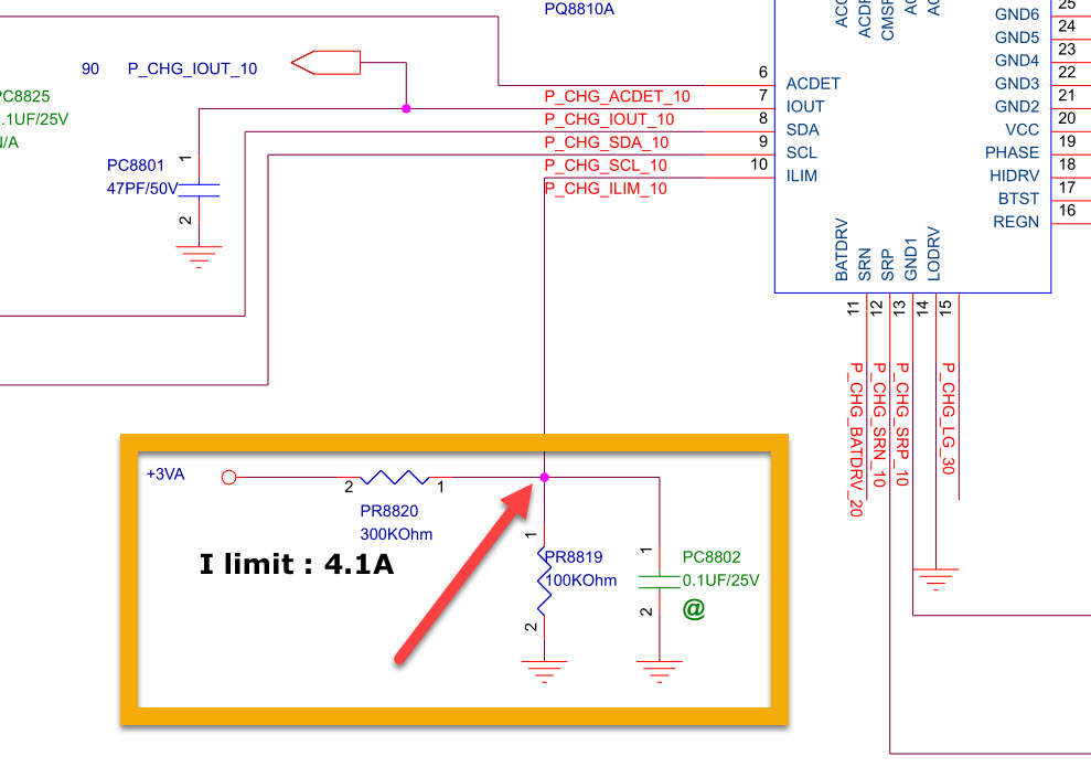

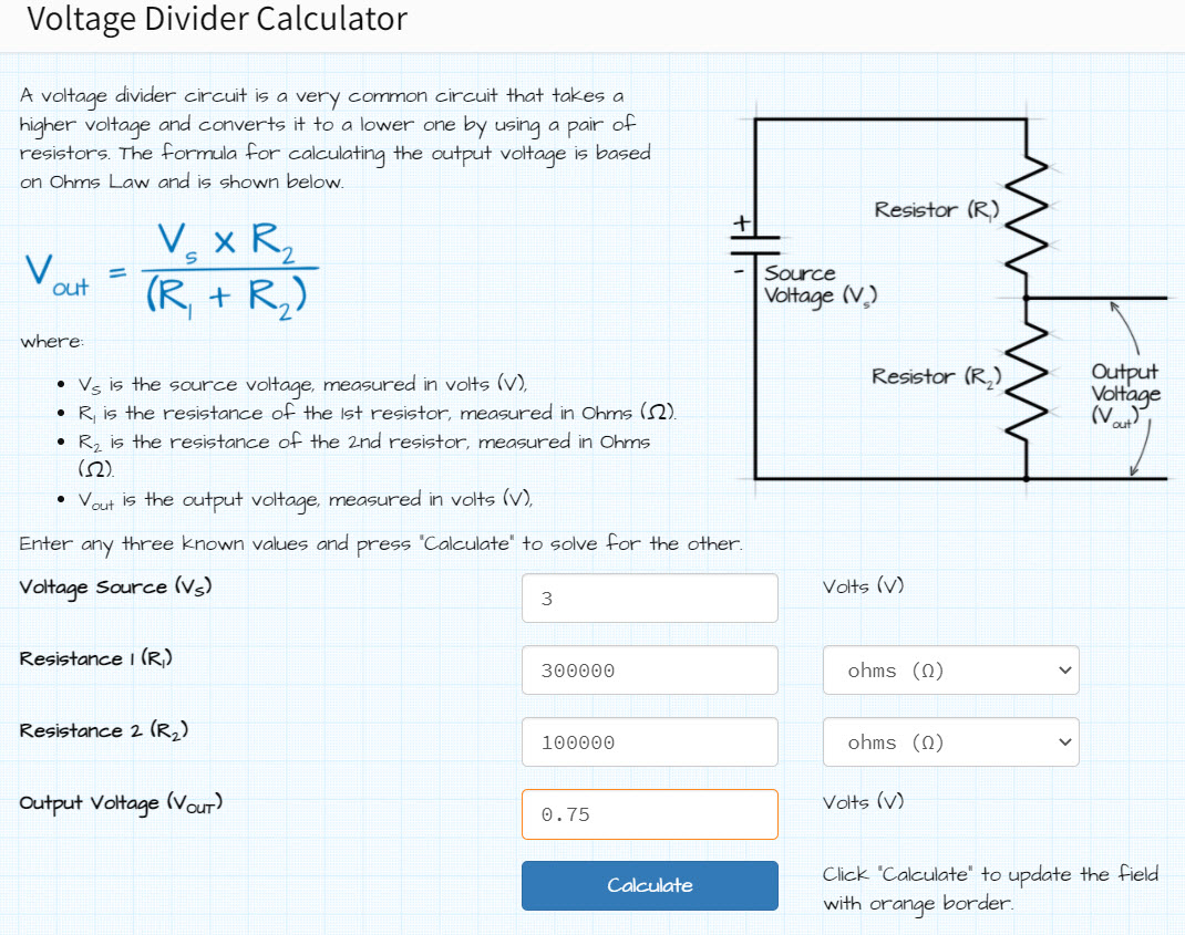

          Re: Asus X550LD - not turning on
          10) P_CHG_ILIM_10 - 0,01v
          This does not look correct for the operation.
          See attached. Based on the calculator, this ILIM value should be ~0.75V
          Reference:
          https://ohmslawcalculator.com/voltag...der-calculator
          Review the resistors PR8820 & PR8819. Are they the correct values on the logic board ?
          Confirm the voltage on PR8820 - is one pin truly 3v0 ?
          The +3VA rail is mated to +3VA0 using PSL8101 jumper. The +3VA0 rail is created by the LDO (fixed linear regulator) @ PU8100.
          Confirm that the +3V rail is working so that this voltage divider can create the 0V75 for the ILIM threshold. With the present low value, the charger IC will not enable the battery charging.
                pr8820 gets 3v on one pin, the rest are 0,01v
                i measured this with voltage mode, one probe on common gnd, and one on the pin
                You are measuring this properly. Be sure that you are in DC volts mode.
                Use the lowest DC volts setting on your meter.
                Given that you can measure 3V, this resistor divider is messed up for some reason.
                Try the following:
                1) Remove all power. Meter in resistance mode.
                2) Place one meter probe at the common junction of these 2 resistors = ILIM pin on the charger IC. The other meter probe to ground.
                What resistance value is being read by the meter ? Based on the very low voltage of 0V01 = 0.01 volts at this resistor based voltage divider, guessing that the charger IC or the resistor @ PR8819 is shorting to ground (or is a very low resistance that is not the required 100k value = 100,000 ohms).
                BTW - Is there a capacitor near this resistor to ground @ PC8802 ?
                Do you have hot air tools for soldering / desoldering ? If you see a capacitor @ PC8802 - remove it and then check the voltage again for the ILIM pin.
                Something linked to the ILIM is tanking the voltage down to this very low value of 0v01.

                                      • mon2
                                        • Dec 2019
                                        • 14401
                                        See attached.
                                        1) Remove PR8819 off the logic board.
                                        2) After the resistor is removed, confirm the resistance of this component while it is off the logic board. It should be ~100k ohms. Post the value.
                                        3) Leave this part off the logic board. Check the resistance to ground of the ILIM pin of PU8800 (charger IC). You can check this at the common junction of PR8819 & PR8820 (point #2 in the attached boardview pic). Post the value.
                                        4) Next, check the resistance of PR8820. Use the meter probes and check the resistance across the 2 pads of PR8820. Your meter should be in a scale higher than 300k to measure this component. This part should be ~300k ohms. Post the value.
                                        5) Remove the battery. Meter in DC volts mode. Power up with adapter. Check the voltage on PR8820, pin # 2. It should be about +3v0. Post the value.
                                        Check the voltage on PR8820, pin # 1. It should also be about +3v0 since the pull-down resistor @ PR8819 is still off the logic board. Post the value.
                                        Only if PR8819 & PR8820 are of the correct value and PR8820 is mated to +3v0, then these 2 resistors will work together to offer a lower voltage than the source +3v0 but certainly should be a non-zero value.
