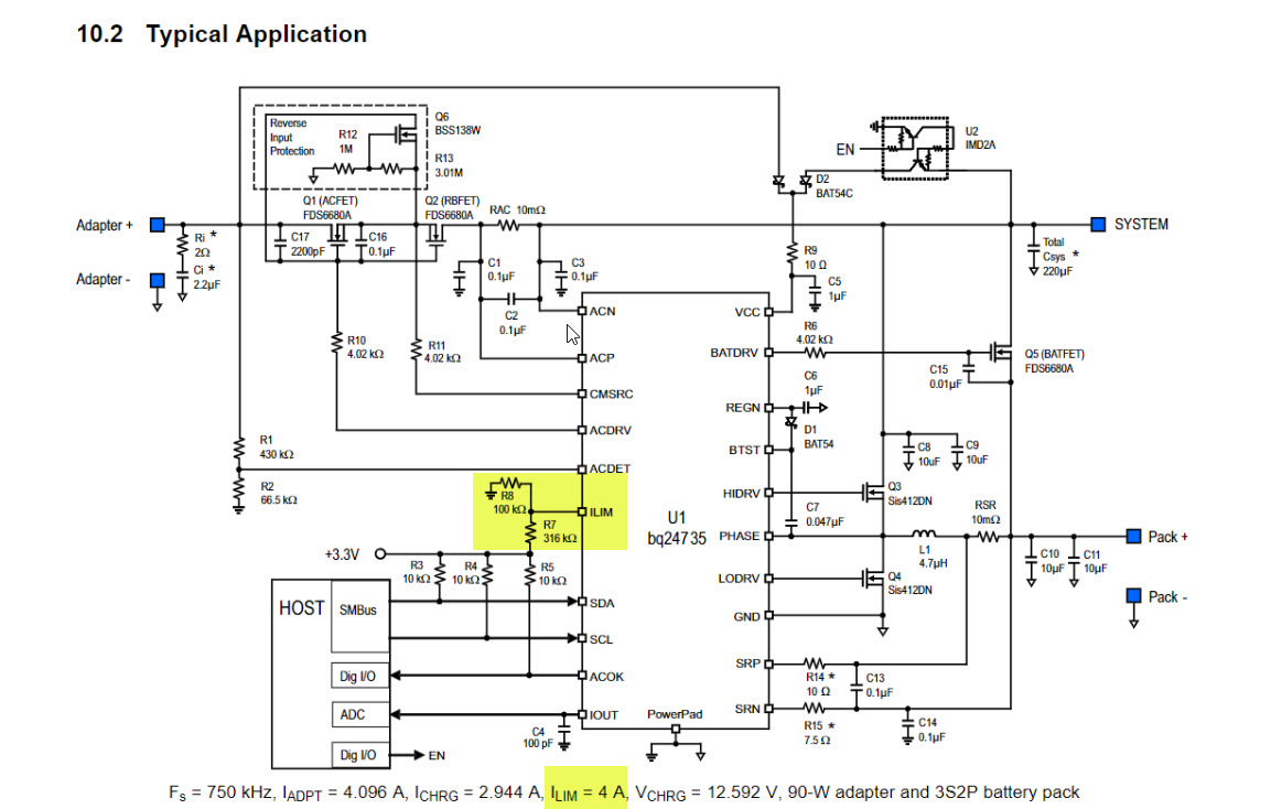

      According to the schematic, PR8820 should be a 300k resistor. So either the logic board has a defective resistor at this location or the assembly was made with this change and the schematic was not updated to reflect the new value.
      Locate any resistor that is available like 10k or similar (value is not very critical but try to be in the range of 4k7 to 47k). Solder in place for PR8820.
      Do not have a resistor @ PR8819 on the board.
      Then power up (no battery). What is the voltage reading for the new PR8820, pin # 1 ?
      This will be the same as the ILIM pin analog voltage. It should be ~ +3v but confirm it.
      Attaching a typical charger circuit for the same device that is onboard your logic board. The reference design is also using about 300k for the high side and 100k for the low side for the ILIM function. This equates to about 4A peak support.

          Something is wrong @ pin # 1 junction = ILIM pin of the charger.
          Are there any other parts that may be connected to pin # 1 of PR8820 ?
          Or is the charger IC, pin #10 the only other connection ?
          Specifically, pin # 1 of PR8820 should be ~ +3V0 and it is not. Some other factor is causing this pin to go to 0V which is not correct.
          If you are comfortable with the idea, you could desolder the charger IC and check pin # 1 voltage again. Perhaps the charger IC, pin #10 (ILIM) has a fault and is causing this issue.
          You could apply flux onto the charger IC and hot air to make the chip dance to reflow the IC. Use low air pressure but higher heat so that parts do not go flying off the PCB. Then check the voltage again for pin #1 of PR8820.
          Is there a capacitor @ PC8802 ? If yes, remove it and check again. The schematic shows '@' in the label suffix so usually this means the part is NOT stuffed during the PCB assembly process.

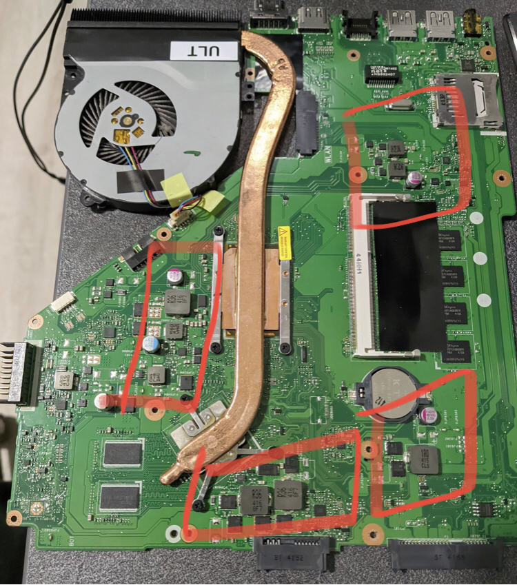

                                What are the missing voltage on the big Gray coils? On the ram slot check the voltage pin 30 with the ram
                                • krayz
                                  • Nov 2021
                                  • 54
                                  • Slovenia
                                  #36
                                  Re: Asus X550LD - not turning on
                                  big coils:
                                  18,5v
                                  1v
                                  1,5v
                                  1,7v
                                  1,3v
                                  i have onboard ram only
                                  pin 30 on ram slot: 0,4v

                                    In your MB they are 8 Gray coils note the voltage near the coils , so you don’t have a extra ram to check? Q602 voltage?
                                      No extra RAM modules sadly
                                      Here are the measurements in picture form
                                        Do you have a USB key board if so attached the screen power and see if the
                                        num lock is working or not ? Check the voltage U7002 BUF_PLT_RST# H DRAM PWRGOOD
