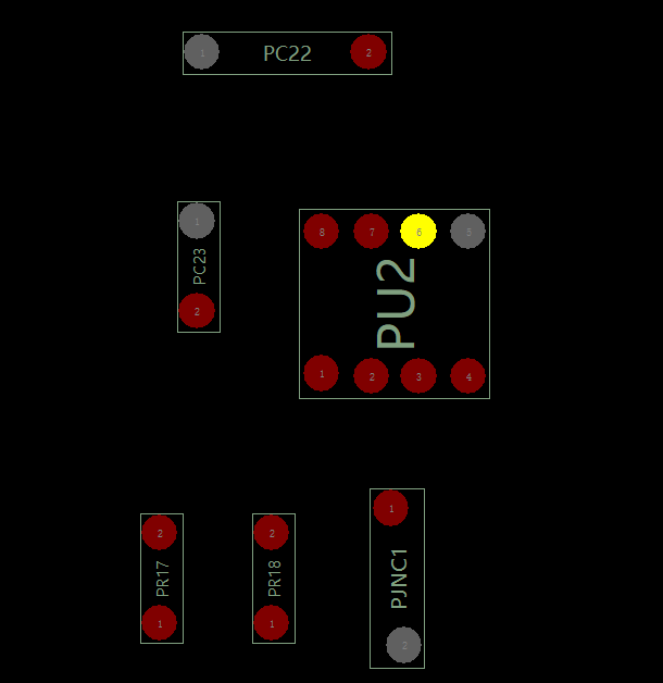

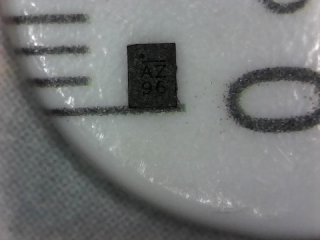

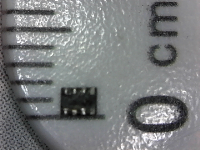

    Hi. I am hoping that someone would know the name, and maybe even where to buy this power ic. This is from msi gt72 ms-17811 motherboard. On the motherboard it is named pu2. The chip has text: AZ96. I can not find any information of that ic. My chip is shorted, so replace part is needed.
    Many thanks!

    Hi.
    Is there a metal belly pad on this device?
    Can you post a clear pic of the pcb location where this device was soldered?
    It may be Richtek RT9011-JGPQV.
    This is a fixed dual rail LDO.
    The JG define the vout1 and vout2 fixed voltage values.

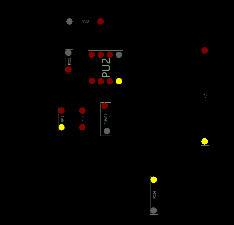

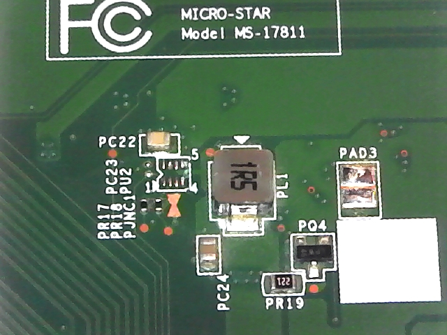

      Re: Msi gt72 - Need to know IC name
      Okay, here is all the components from that area. No metal pad.

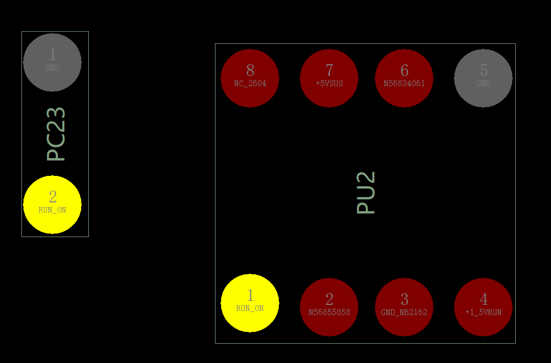

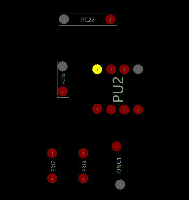

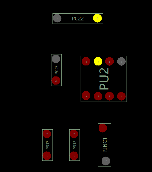

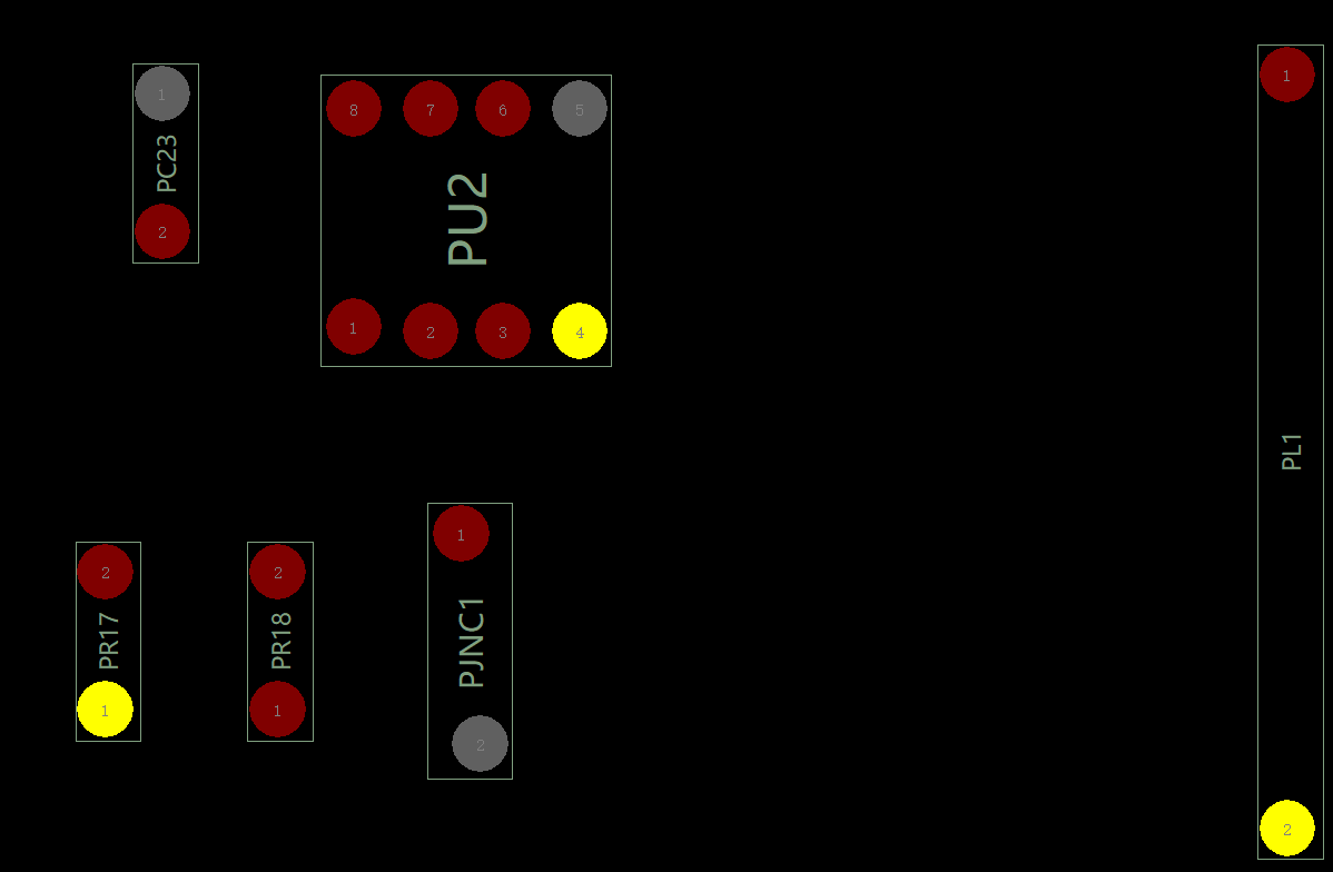

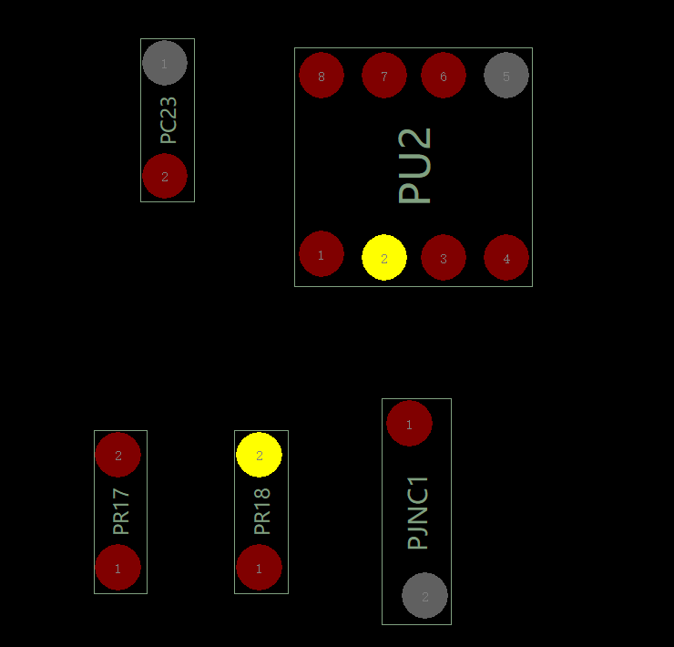

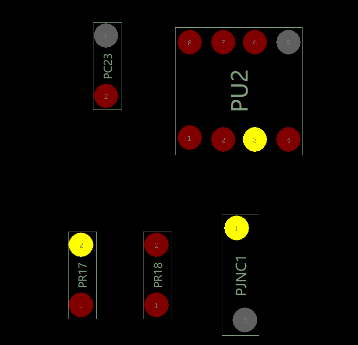

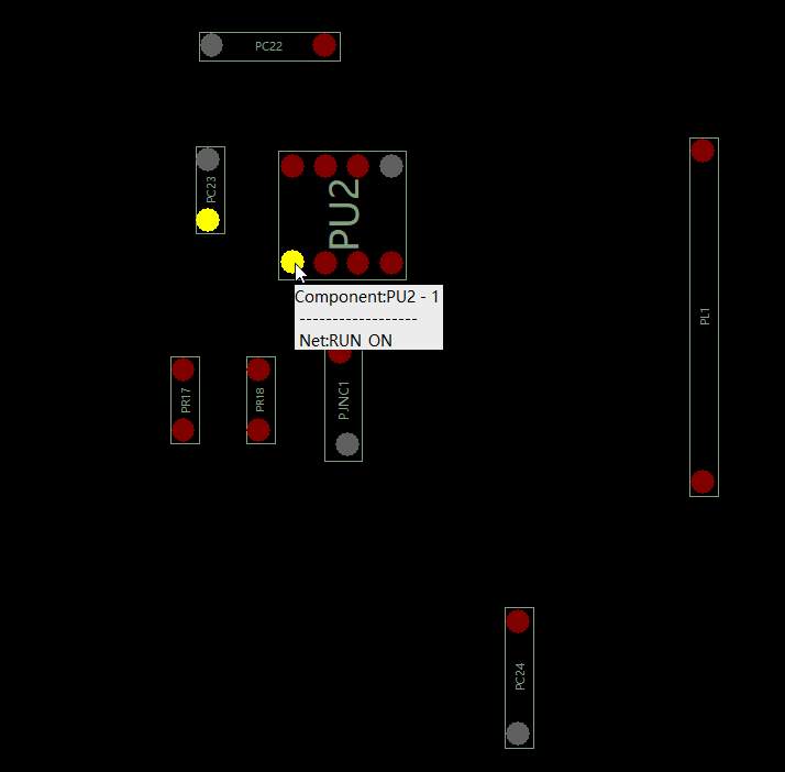

        Ok - skip my idea. The PL1 is a switching inductor and this device appears to be a switching regulator. So it cannot be the RT9011.
        Have only the boardview from my paid sub service. See attached.
        See the logic board on Aliexpress - perhaps the vendor can search for this part as well.
          Az - mp2162

              • 21197
              The line above the AZ is the identifier
              https://www.badcaps.net/forum/showpo...85&postcount=3
                Holy crap... That was really fast. Seems to be the correct ic. Thank you so match LOTAS & MON2 I tried many hours to find any info but no any luck. Already ordered 10pcs package
                Just wow, this community really rocks
