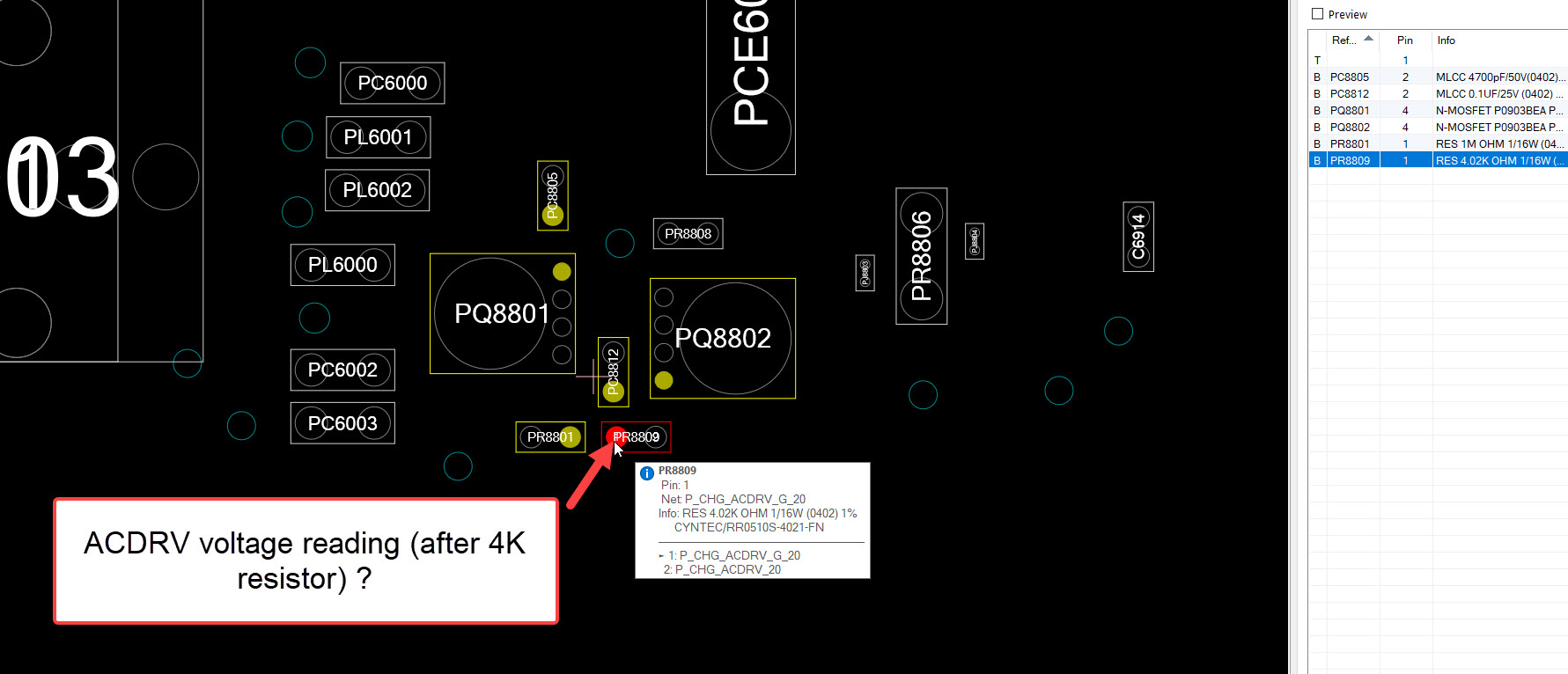

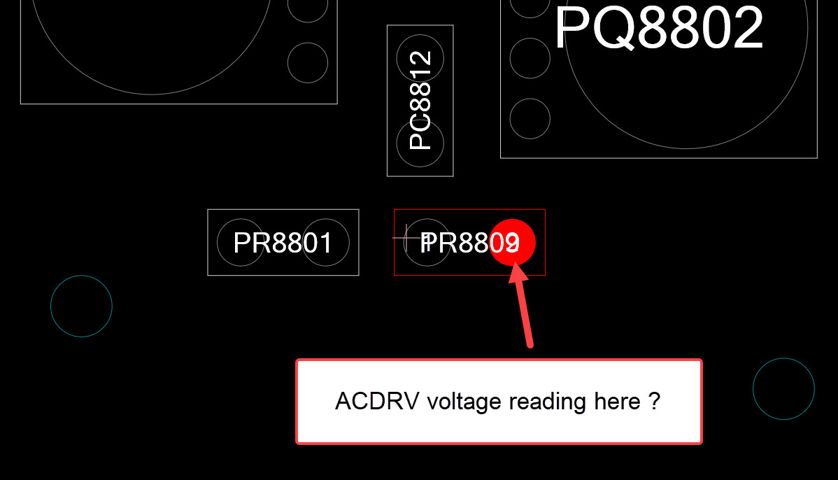

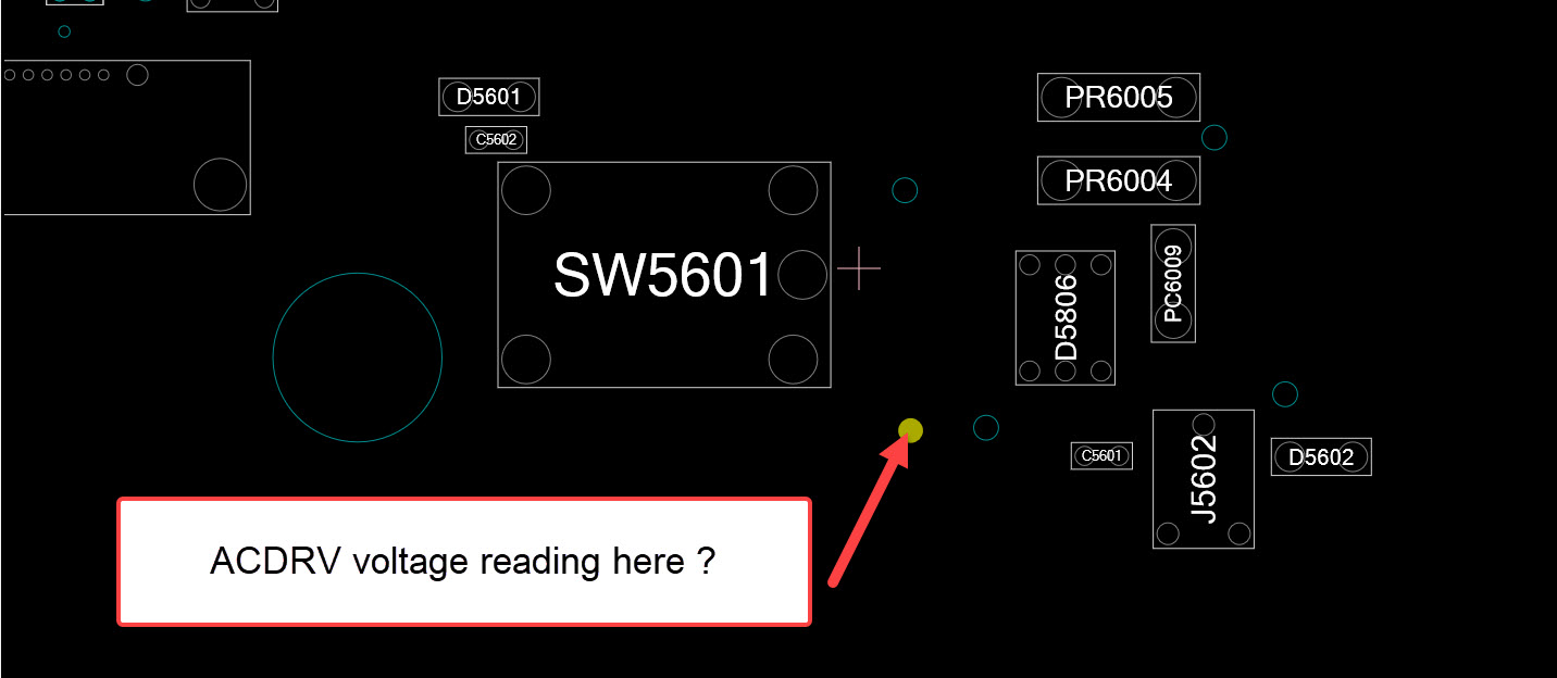

                              2) wish to measure the ACDRV voltage at assorted locations - see attached.
                              Note that you will have to flip the board to measure some of the locations. Do so carefully.
                              Measure and post the voltages for:
                              3) SRN pin 12 of BQ735
                              4) CMSRC pin 3 of BQ735

                                  hi bro sorry in advance, this is my fault, actually the acdrv has issued a normal voltage of 24.5v because yesterday I forgot to change the avometer set to 20v.
                                  so the problem of acdrv and acok is fixed... , but I'm confused why the battery percentage can't go up and stays at 70%?

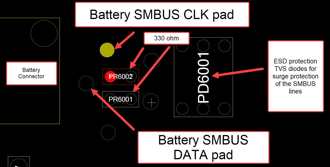

                                        Otherwise, the I2C (smbus) communication needs to be checked. There will be a BMS logic inside the battery pack that reports the details of the battery. Assuming the BMS is working and communication is as well then the host can properly gauge the health of the battery.
                                        What is the connector of the battery on the logic board? Any silk screened text near the battery connector? Will look for it on the board view file to trace the mated parts.
                                        Also...if you remove the battery - what does the battery meter report ?
                                        See attached.
                                        Remove the TVS diode part @ PD6001 and test again. This component may be hindering the communication between the battery and the logic board.
                                        Post the voltage readings of the SMBUS CLK & DATA pads when the battery is attached.
                                        Also check that the voltage of the SMBUS CLK & DATA pads is very similar on BOTH sides of the 330 ohm resistors as per attached drawing. It is required that PR6001 & PR6002 are present and not open. These are each @ 330 ohms.

                                          I just tried to disconnect the charger and only use the battery, and the percentage dropped to 68% then I plugged it back in and until the time the battery remained 68%.
                                          and I've made sure that the battery is in good condition and normal on another motherboard bro.
                                          when my battery is removed there is only an X on the battery and there is a "battery not detected" notification ok thanks a lot for helping me so far bro, I'll check back on the attachment
