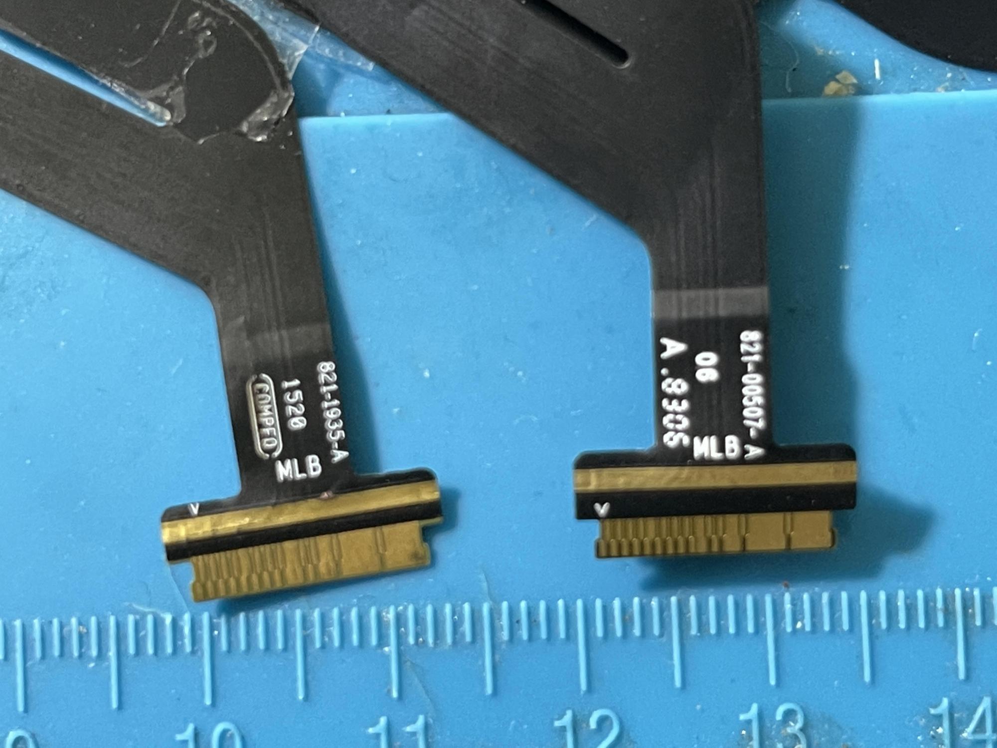

    i have macbook 12" 820-00244 that came with no keyboard..
    short story..i change the flexible from trackpad to logic board and the keyboard can be use perfectly..and no it came back with no keyboard and trackpad so i tried to change again the flexible but when i try to change it maybe the cable was slented and suddenly burnt L4804 (PP5V_S0_KBD_F). so i changed L4804 and C4804..after finished i use diode mode for checking the short and found out PP5V_S0_KBD_F shorted to ground..and also PP5V_S0..
    injected 1.4V and 4A through PP5V_S0 buth nothing gets hot
    any suggestion?

          hi @mon2,
          right now i am not dare to turn on before i get the solution fot the short.
          actually this macbook is ex repair from another repair shop.
          here i attached the picture of flex cable.. the right one is the original..and i replace with le left one

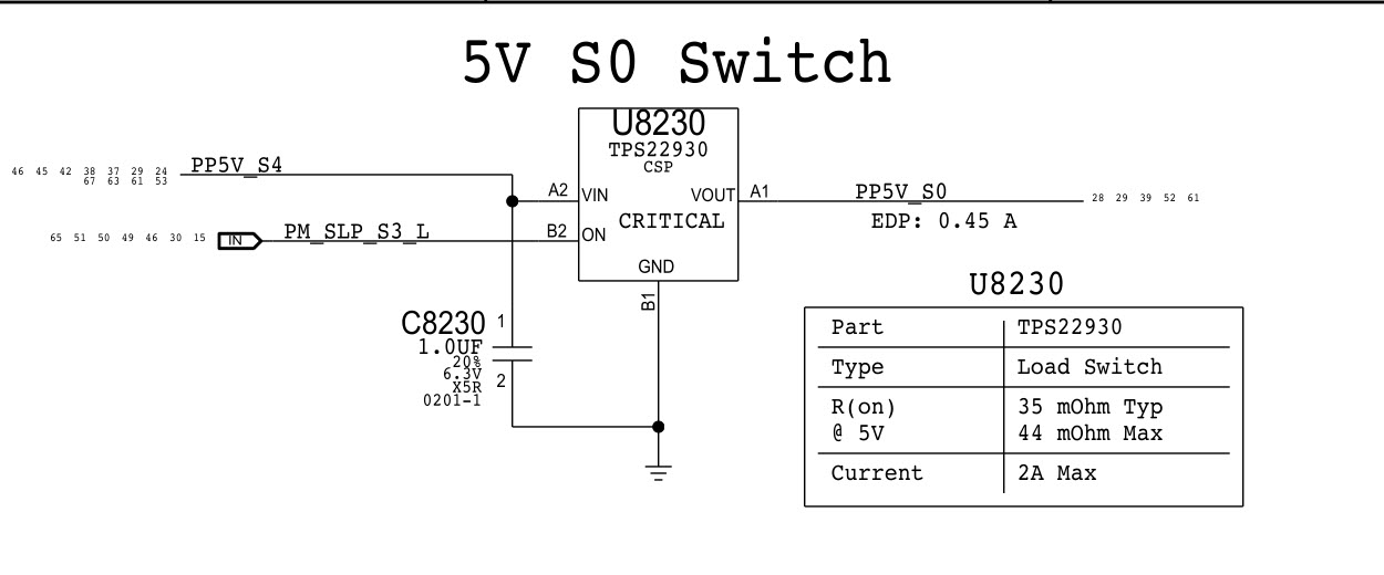

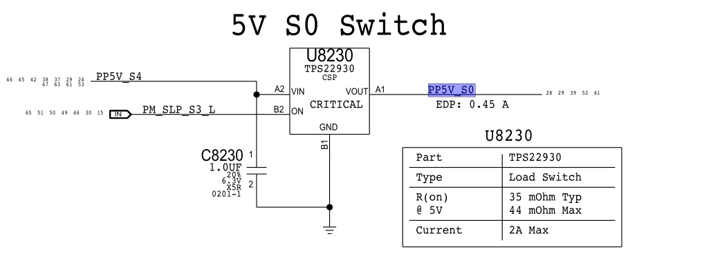

            Meter in resistance mode, remove all power (no adapter / no battery).
            1) What is the resistance to ground of A1, A2, B2 on U8230 ?
            2) inspect U8230 which is a small WLCSP device and if you see L4804 burnt than you had some excessive current draw (perhaps due to the trackpad cable seating).
            It is possible that U8230 is now damaged. If you feel comfortable, you could desolder U8230 to see if the short is removed. Be sure to note the pin # 1 on this very tiny device for proper placement back onto the logic board.
            When taking the measurements, remove the trackpad cable to rule out the cable & trackpad / keyboard interconnect.
            You can also consider to remove the cable @ J6799 as PP5V_S0 is linked to here (and many other locations on the logic board).
            If necessary, remove RA000 (0 ohm resistor) to isolate the PP5V_S0 rail away from the PP5V_S4RS0 rail. Only to locate the root cause of the short on PP5V_S0 rail.

              i took out RA000 and measure PP5V_S4RS0 is not shorted so the culprit must be U8230 right since PM_SLP_S3_L and PP5V_S4 not shorted.
              does anyone know which logic board that has U8230 (TPS22930)? i look around macbook 12" 820-00045 but not found

                With RA000 removed, which side of the RA000 pcb pads is shorted ?
                What is the resistance to ground of the output pin of U8230?
                Are you looking for U8230 to replace? So far, only found it on AliExpress.

                  pin 2 (PP5V_S0) that shorted.. the resistance on this pin is 0.6 ohm.
                  yes i also looking in aliexpress..only one seller sells it..
                  actually can this board turn on with PP5V_S0 shorted to ground?

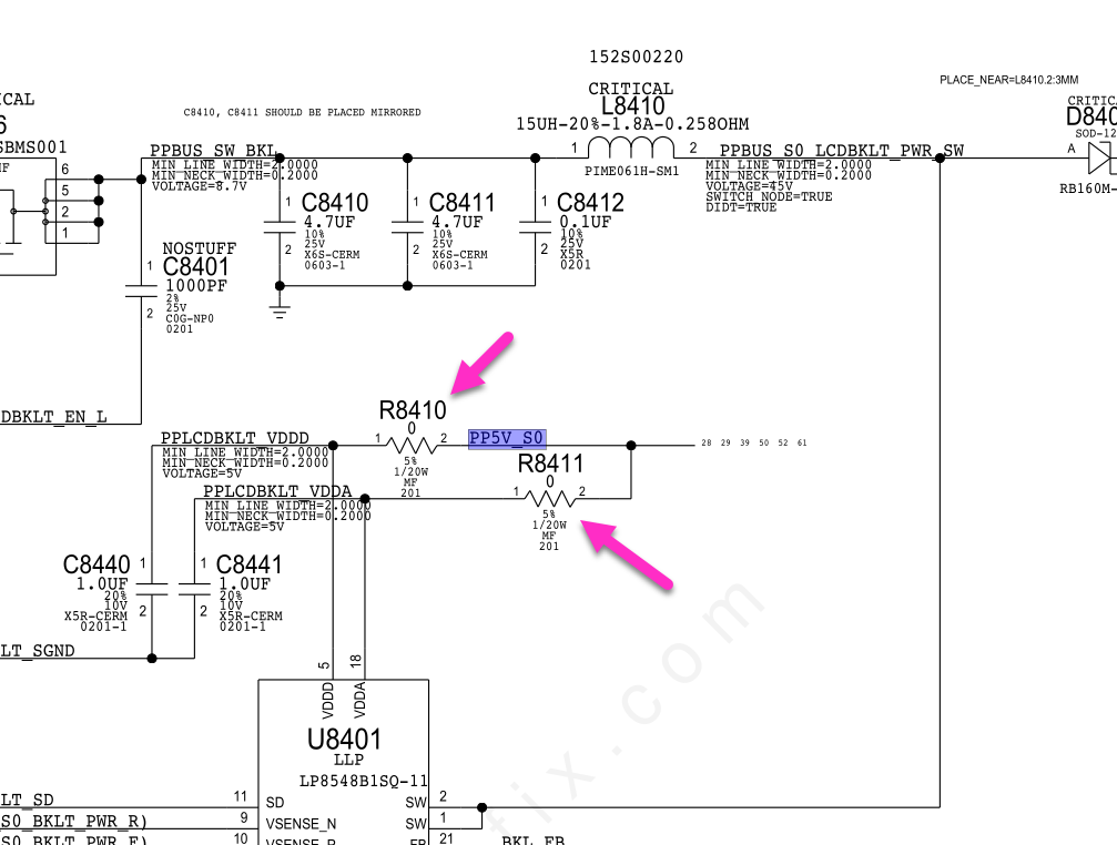

                    1) Remove R8410 & R8411 -> check if short to ground is removed.
                    2) If the short still remains, consider to flux and remove U8230.
                    Post your results.

                      i just remove them and still got short on PP5V_S0..PPLCDBKLT_VDDD not shorted. took out U8230 still have short..
