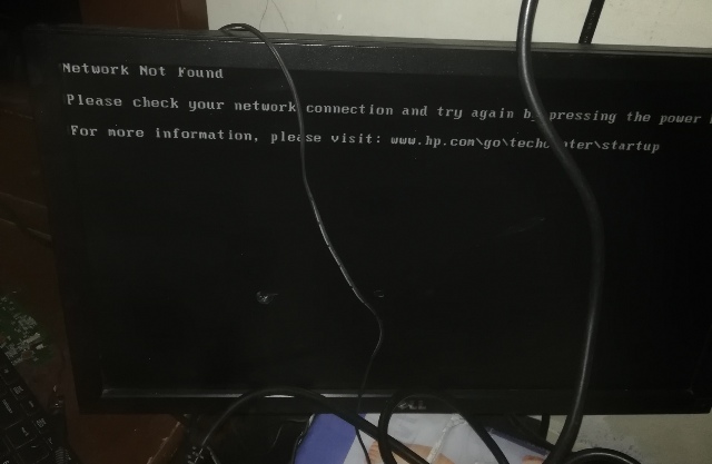

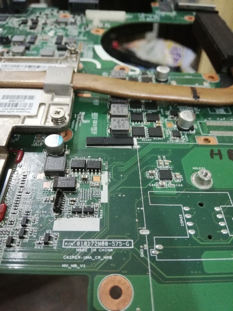

    I have hp probook 6570b that has only external display but nothing on the laptop screen.
    Any guidance please.
    (P/N: 010172N00-575-G
    CASPER-UMA_CR_HPB
    MV_MB_V1)

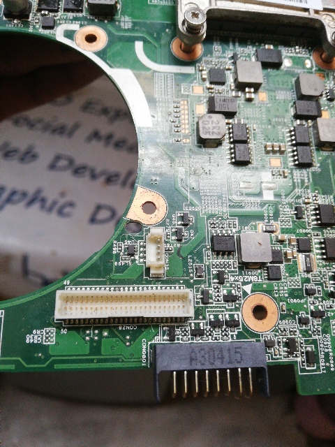

                    Re: Hp probook 6570b only external display
                    Originally posted by mon2
                    Are there any labels or markings on the display?
                    Post all details here. Perhaps there is a public datasheet that will help to determine the voltages on the display connector.

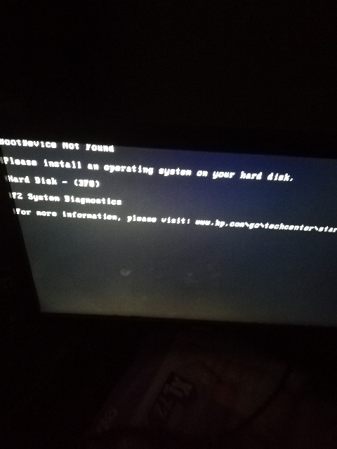

                    in the start, i saw CMOS battery error
                    but as i was using charger, so in neglect it
                    other pics are as follow.

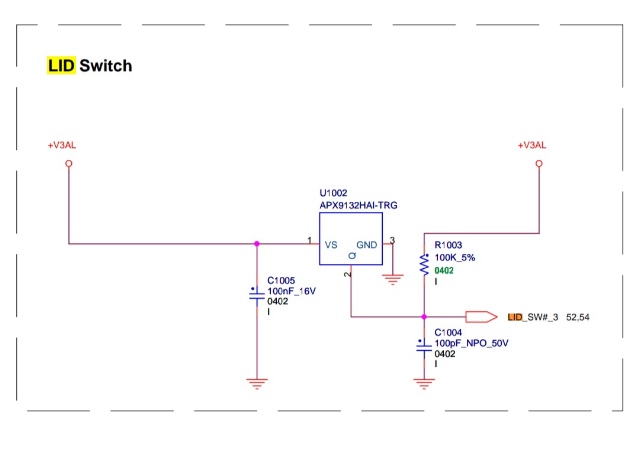

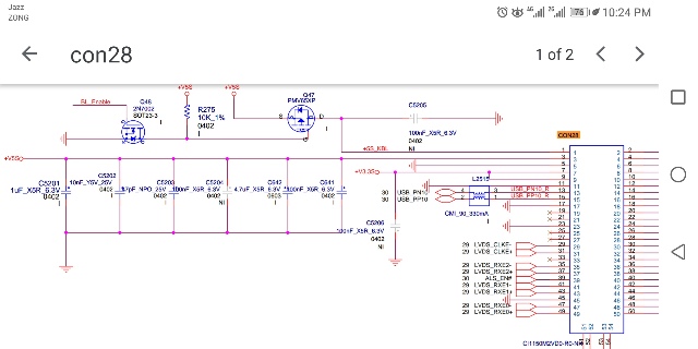

                      Hi here shematic if it is the right one.
                      Good luck
                      Regards
                        Good luck
                        Regards
                        Thank you sir, its the one

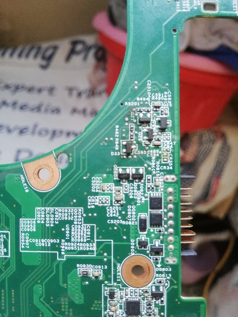

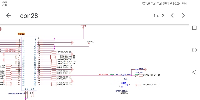

                        • usyusy
                          • Sep 2021
                          • 171
                          • Pakistan
                          Lvds connector pins and surroundings components were checked, some have values others are not, the findings are attached in pic along with schematic pic.,., any guidance please
                            Hi i would look to the lidswitch first. Test the lidswitch. You need 3,3v. Also measure the resistance tobground where you got 0v and share it here.
                            Good luck
                            Regards Steve

                              sir i dont know what happened, but the display has come. the values of
                              >> lid_switch is now around 3.18V on D33 diode, earlier it was 0.03V
                              >> on IO Pin No. 64, is also 3.18V earlier it was 0.03V
                              >> as per schematic, the lid switch value on the Hall Switch IC (U1002-as shown in attached pic) is also 3.18 V
                              For knowledge seeking, what can be the reason if lidswitch volt is missing.
