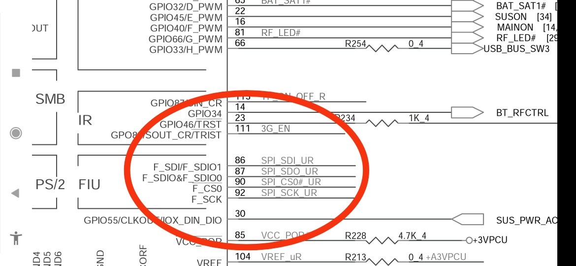

    Dk10fg-6050a2491301-mb-a02
    when i pluged in the power adapter i found the 3.3 & 5 volt on coils but no voltage on power button i replaced the io with a new ic but still no volt on power button

    Re: toshiba l855 - Dk10fg-6050a2491301-mb-a02 power issue
    i think the new io chip shoul be programmeing
    and this is the datasheet
        NPCE885 is not programmable.
