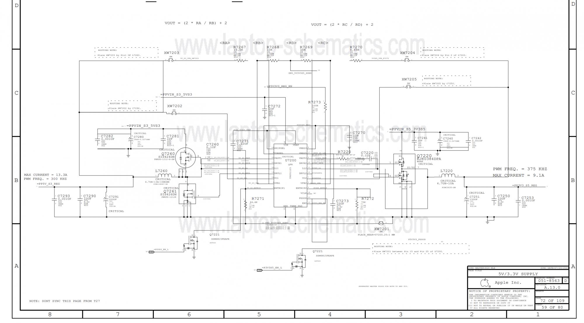

    Hoping someone can help me with with troubleshooting this board.
    Its an 820-2879 from A1278.
    Voltages all good at U7200 except at PP5V_S5 where im only getting 1.5v.
    I had a spark while disconnecting cables. Yes stupidly forgot to disconnect battery first.
    I could put a new U7200 on but waiting for a new rework station to be delivered.
    Anyone like to take a guess if ive a bad u7200 or should I be looking at something else first.
