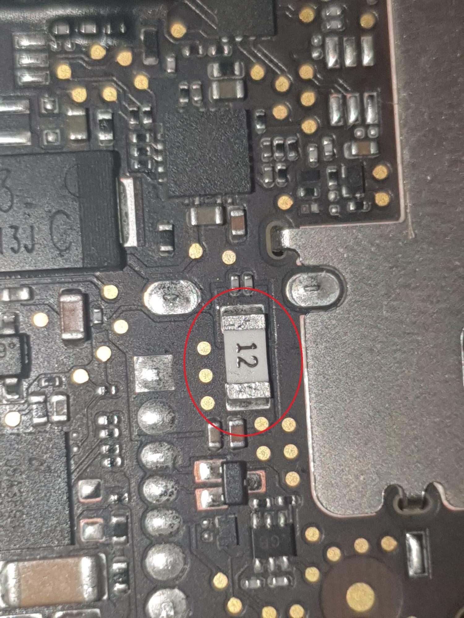

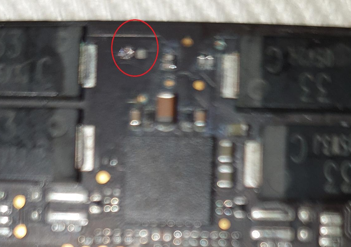

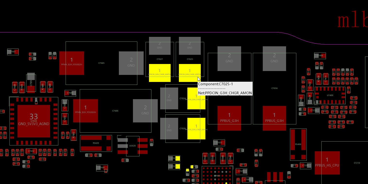

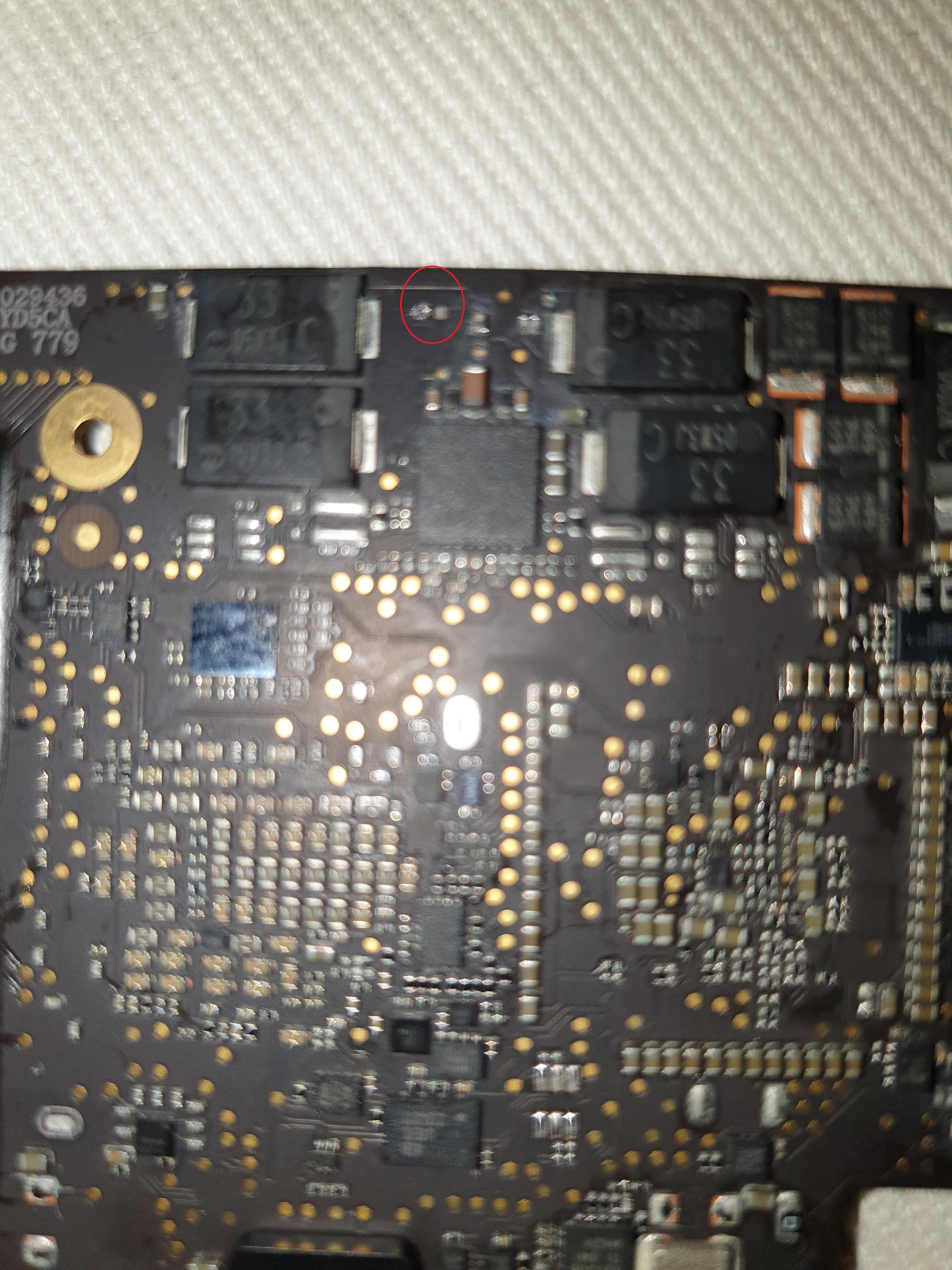

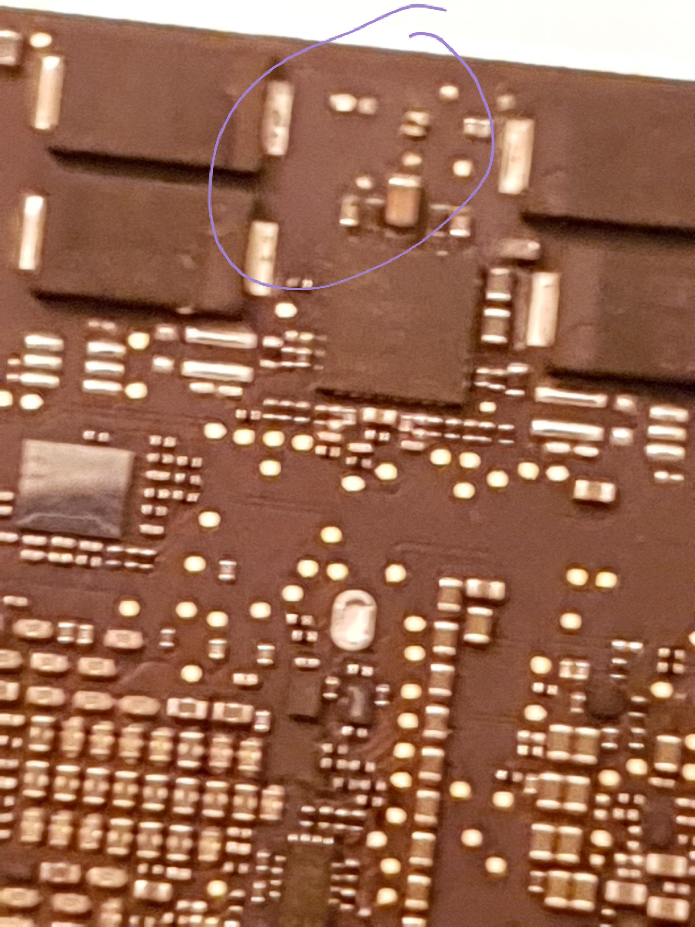

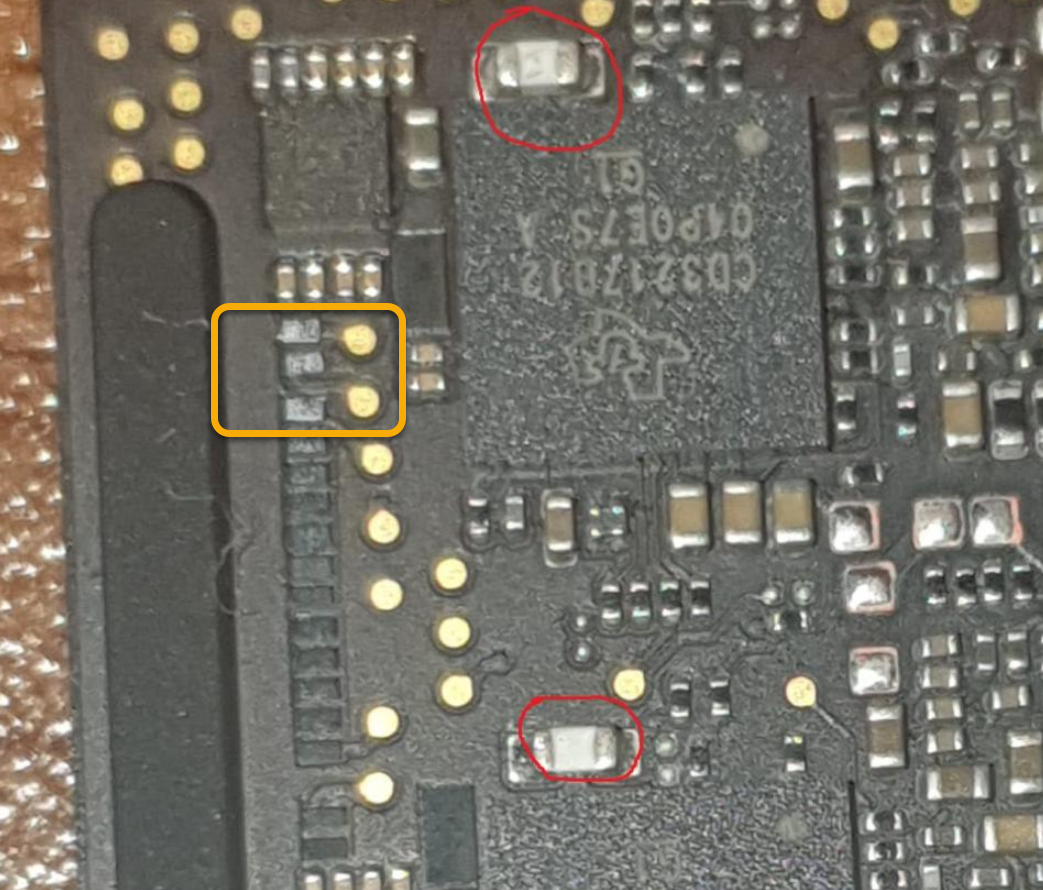

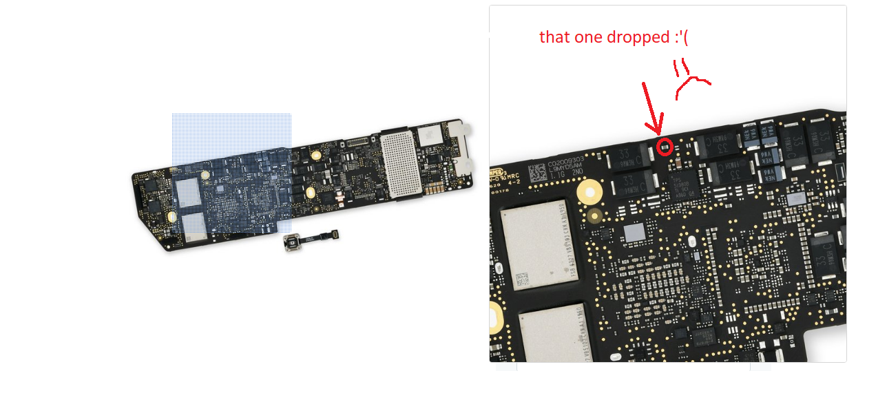

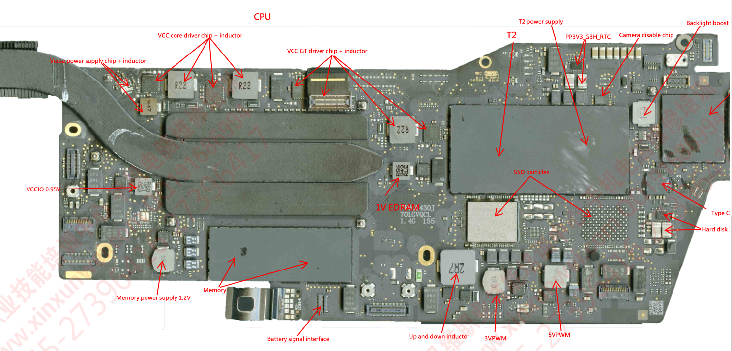

    Hi All,
    I have a MacBook Air 2020 which has a problem with the motherboard. I lent my laptop to my friend for a week and he somehow destroy it. When I opened the laptop I found a capacitor/ resistance like the piece. Can you help me to Identify this part because there is no board view only partial boardview available and I could not determine it.
    It is in between C7665 and C7685 approximately.
    The laptop is not turning on though. But, I would like to fix that problem first. You can find pictures at the attachment.
    Thanks in advance.

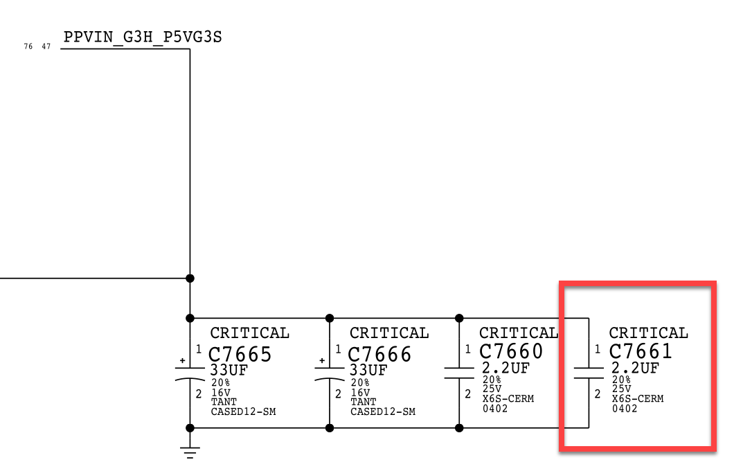

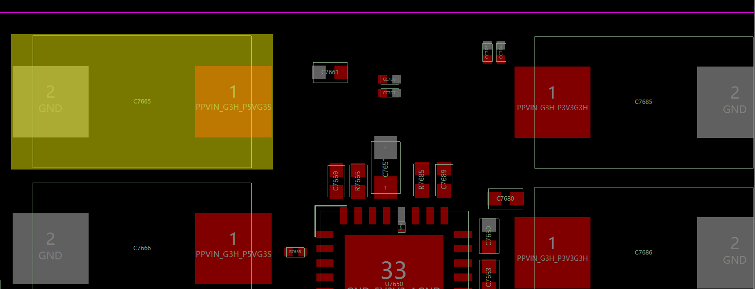

    Re: Macbook Air A2179 Motherboard Component Identifying
    Hi. See attached.
    This is C7661 = 2.2uF non-polarized ceramic 0402 cap @ 25V.
    This part missing will not impact the operation of the logic board.
    If you are still interested to replace this missing part, send me a PM and can send it to you from Arrow - wish to test out the international free shipping with our company account. The part is very inexpensive so can just send it to you and you should receive it sometime next week. If the shipping is indeed free then we may consider to start a small biz to sell repair parts off the Arrow portal.

        1) For reviewing the schematic / boardview files, always look for an etched part # on the logic board. It should be of the format
        820-xxxx
        to identify the logic board.

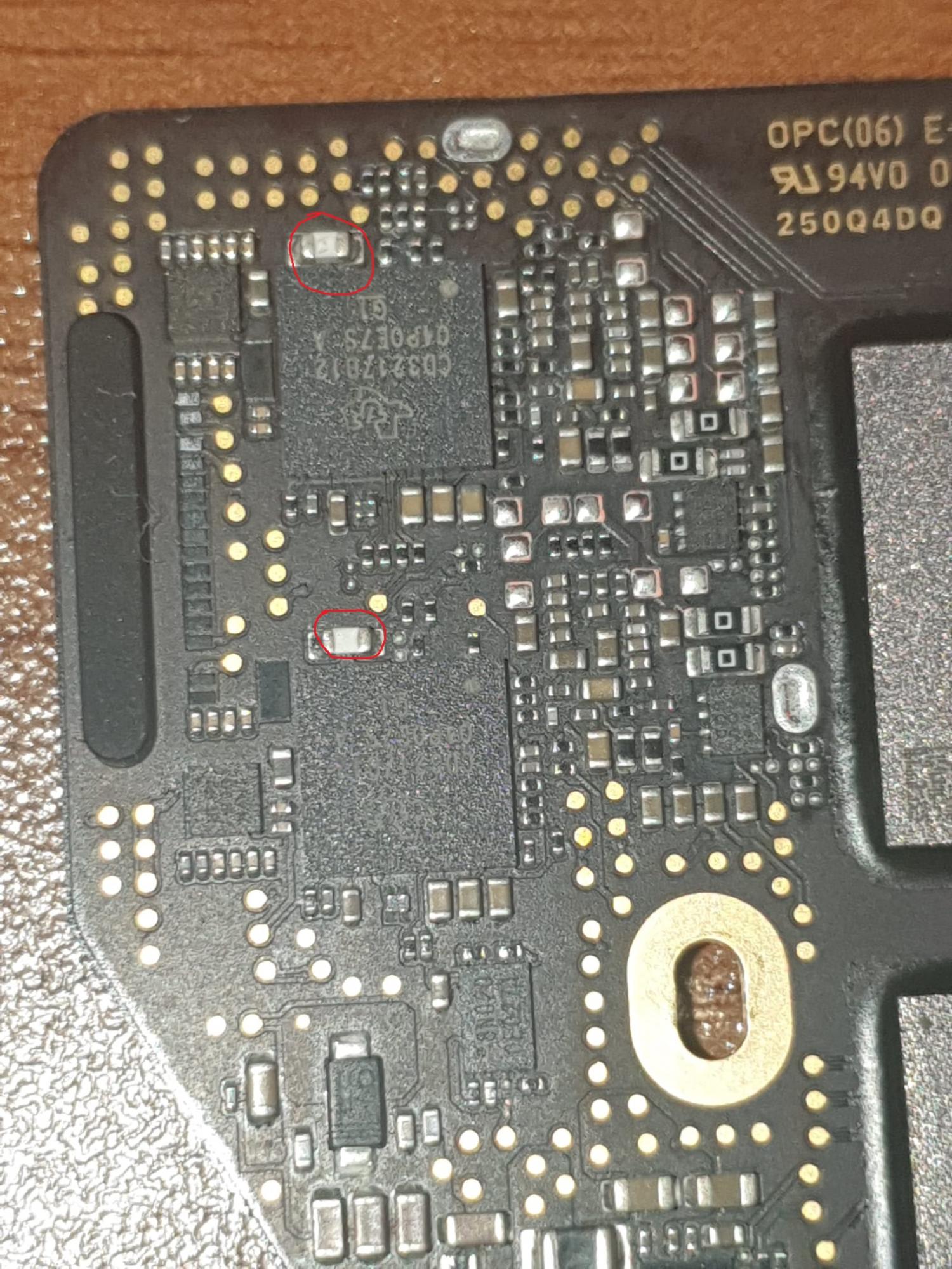

        2) Based on your posted location of the missing part, found in my database that it appear that you have 820-01958. Is this correct ?
        Moving on - just sent you a reply to the PM.

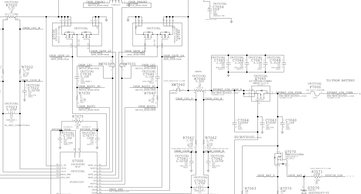

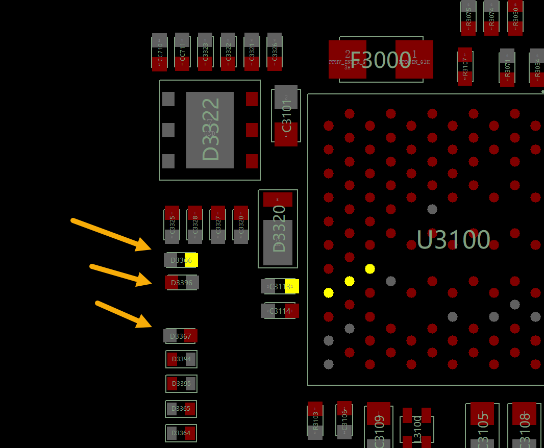

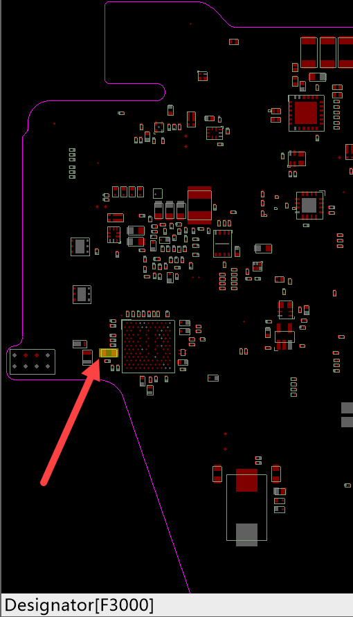

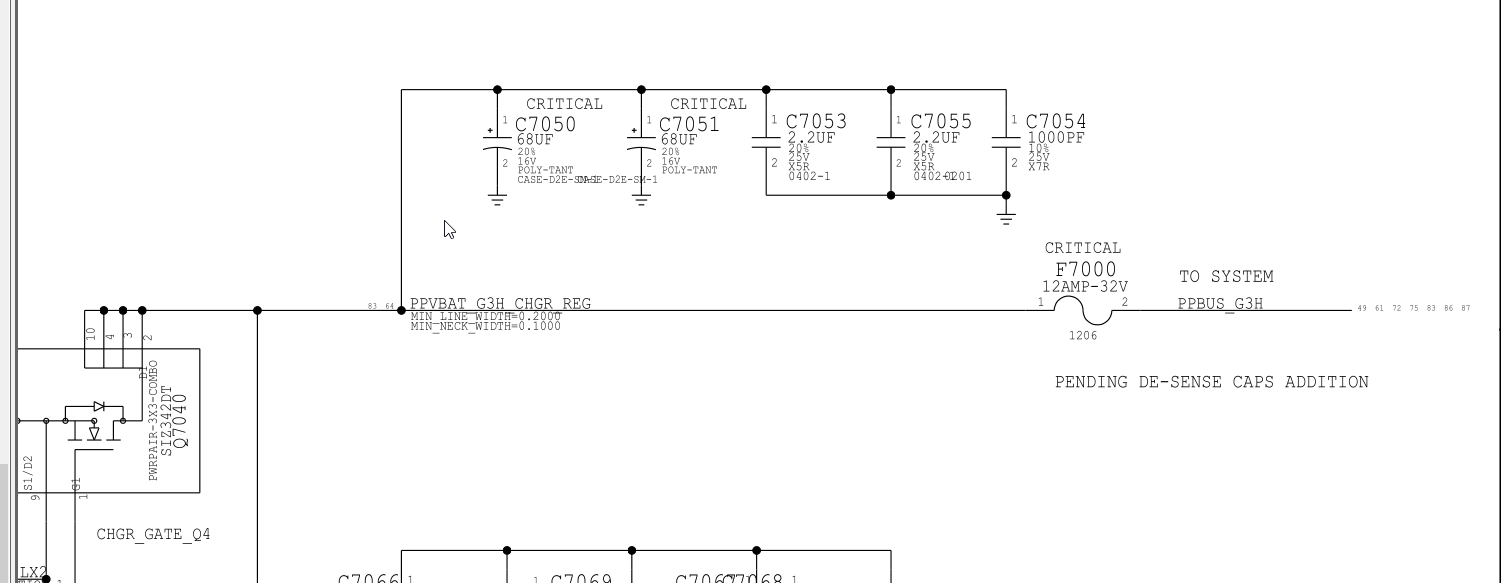

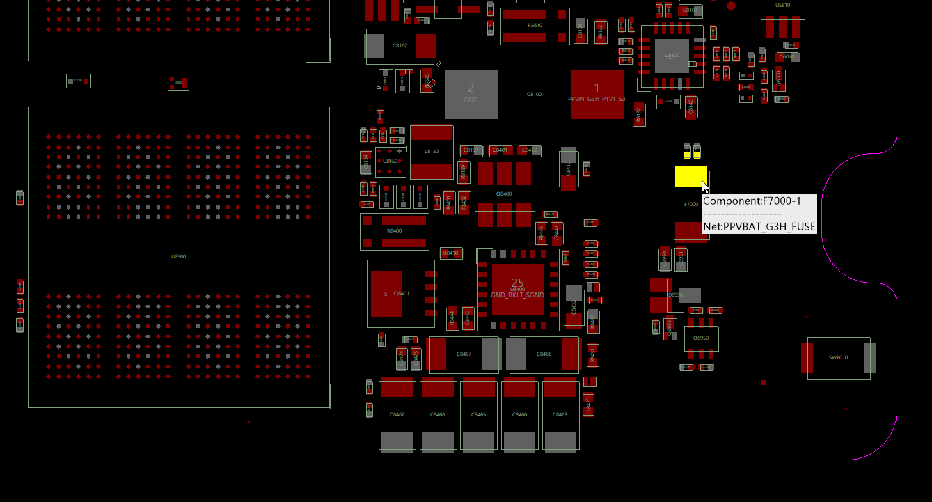

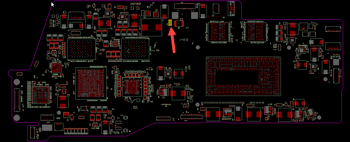

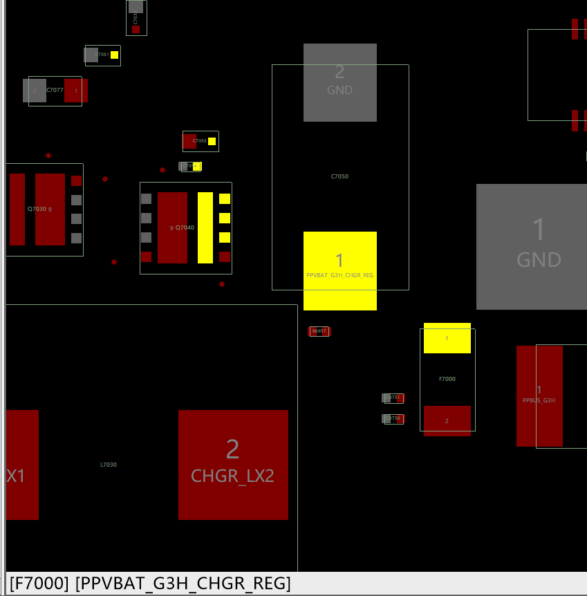

        Update # 2 - see attached.
        Look for a white surface mount part = F7000 (main fuse).
        a) power down. meter in ohms mode (200 ohms). Check the resistance across F7000. Is it still ok with ~0 ohms ? If open, then you will not have a resistance reading = meaning the fuse is not allowing for the power to pass through.
        b) if the fuse is ok -> meter in DC volts mode. carefully power on your Apple power adapter. Check the voltage to ground on F7000 (both sides of this part). What is the voltage reading ?
          That area of the board has clearly been heavily liquid damaged. Replacing one cap won't be enough to fix it.

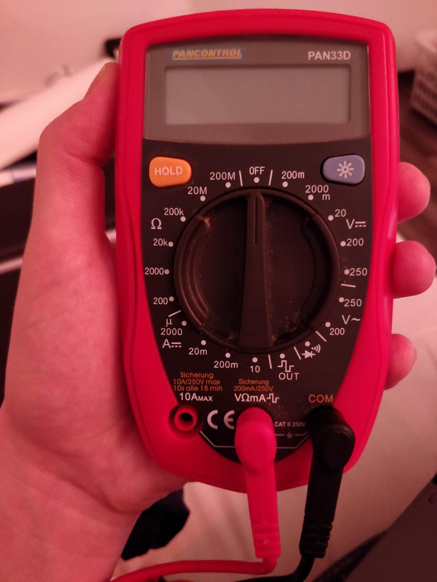

            My voltmeter/ amp meter is arriving tomorrow. Do you think you would have some time if I send PM to you for asking stupid questions? During my bachelor education we only worked on old bulky electronic parts and I dunno where should I put + and - parts of the volt/amp meter on the components.

              I appreciate your reply. The stains you are seeing must be excess electronic board corrosion remover liquid. It left some traces on the board. But I'd like to test components more if you have suggestions. I hope you would support me in my learning process as a woman. When I consult to my some friends they are making fun of me instead of supporting me... How can I use the volt/amp meter for the components? I was confused a bit because I got used to working on old and bulky versions of these.

                  2) Which multimeter do you have on order. It will be a good start to monitor some of the points of the logic board. The USB C meter will show your quickly on the power delivery between the external adapter and this logic board.

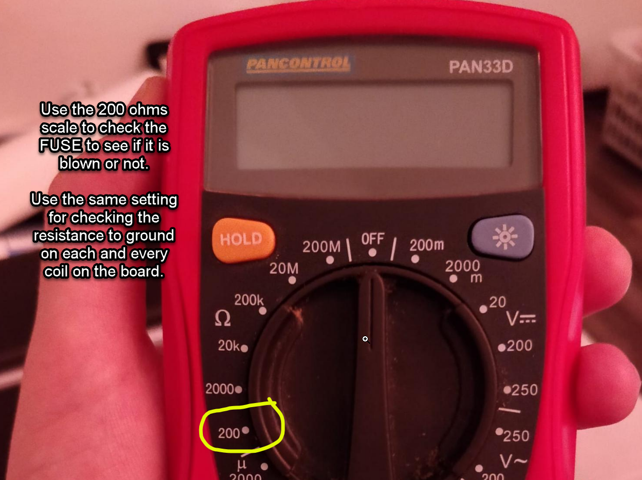

                      See attached.

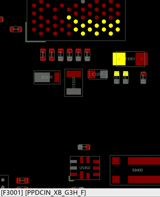

                      1) Start with the meter in the DC volts scale (see attached) @ 200V. Of course we do not anticipate such a high voltage on the board but need to confirm that 20V reaches the start of the logic board. If the POWER DELIVERY contracts negotiate correctly with the external adapter, the logic board will then select the "20V" contract to start the powering of this logic board.
                      2) The resistance mode can be used once you have the adapter removed. You MUST also remove the battery for these tests of the resistance on each coil to ground. Once the power has been removed, meter in 200 ohms scale.
                      Red meter lead on any (grey) coil on the logic board.
                      Black meter lead on a ground on the logic board. Can be the EMI metal shields that are onboard.
                      You are checking for ultra low resistance that may indicate a shorted capacitor or a shorted part.

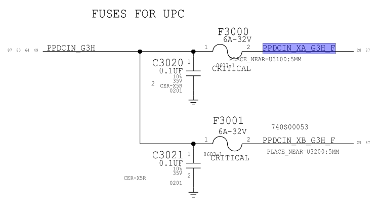

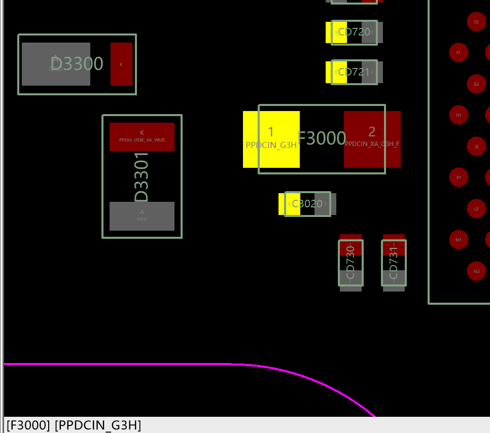

                      Start with the voltage reading on F3000 & F3001 (each should be likely white in color) which will allow us all to know where you stand to start with on the external power adapter.
                      What voltage do you see with the adapter attached on these fuses ?
                      Next, review the fuse @ F7000 and post the voltage reading there.
                      Inductors are the GREY SMD (surface mount devices) with the inkjet markings like 2R2 = 2.2uH, etc. The reason to inspect these are because such large devices are linked to local switching power supply rails. Each inductor = a different power rail. If you read some kooky low resistance (< 10 ohms), then that area needs further investigation.
                        Again, even if the picture is of very low quality, this area is clearly liquid damaged.

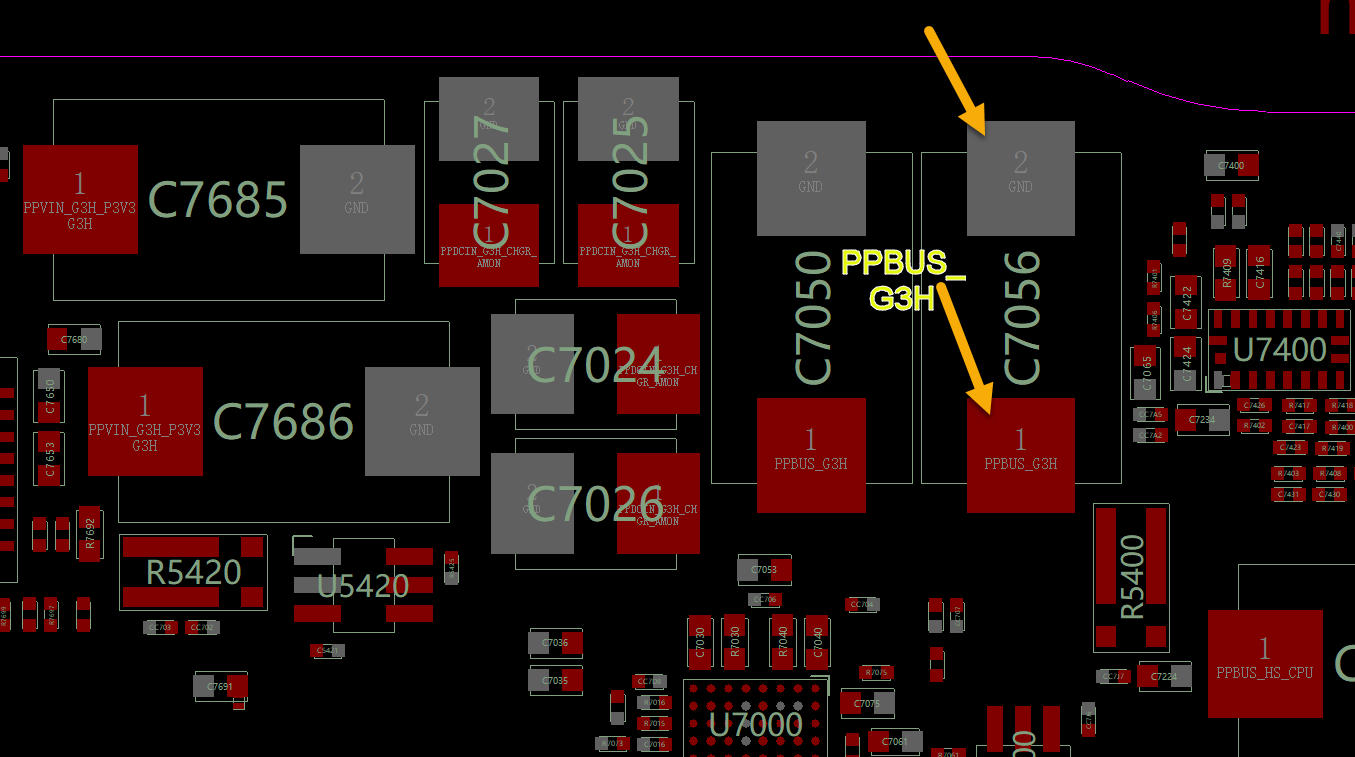

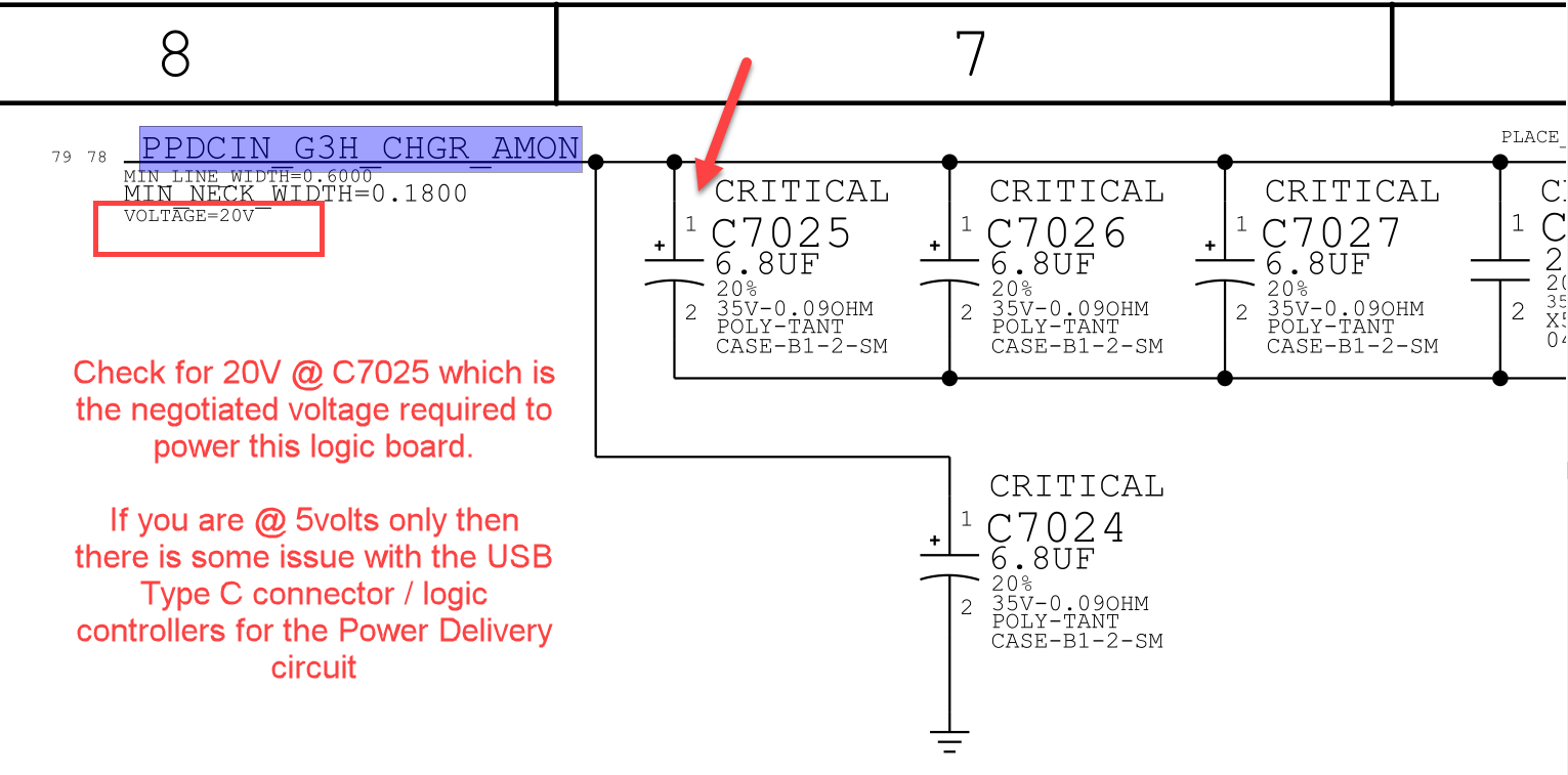

                                1) With the adapter connected, post the voltage on C7056 (+). Meter in DC volts (20V is ok); black meter lead on the negative side of this capacitor.
                                Red meter lead on the + side of this capacitor.
                                This step is checking for the voltage of PPBUS_G3H.
                                2) With the adapter connected, check and post the voltage on BOTH sides of F7000. Or are you reading this low voltage on both sides of this fuse ?
                                Pin #1 of F7000 is important to know if the local switching power supply is working. If Pin #2 of F7000 is zero then it is possible that the fuse is blown.
                                3) With the fuses @ F3000 & F3001 @ 5v1, we know that the power rail PPDCIN_G3H = 5v1. This rail is too low to power the logic board.
                                Respectively, require this rail to be @ 20v.
                                There are 2 USB connectors on this logic board. Each USB connector is controlled by a local CD3217 (ACE controller by Texas Instruments).
                                Both of these USB controllers must be working to allow for the 20V to be selected.
                                See the article here from @Piernov which is related:
                                https://www.logi.wiki/index.php/T2_a...er_on_Sequence
                                4) Also inspect the diodes from your posted pics to confirm they are not damaged. They look discolored - could this be corrosion or just not a good picture ?
