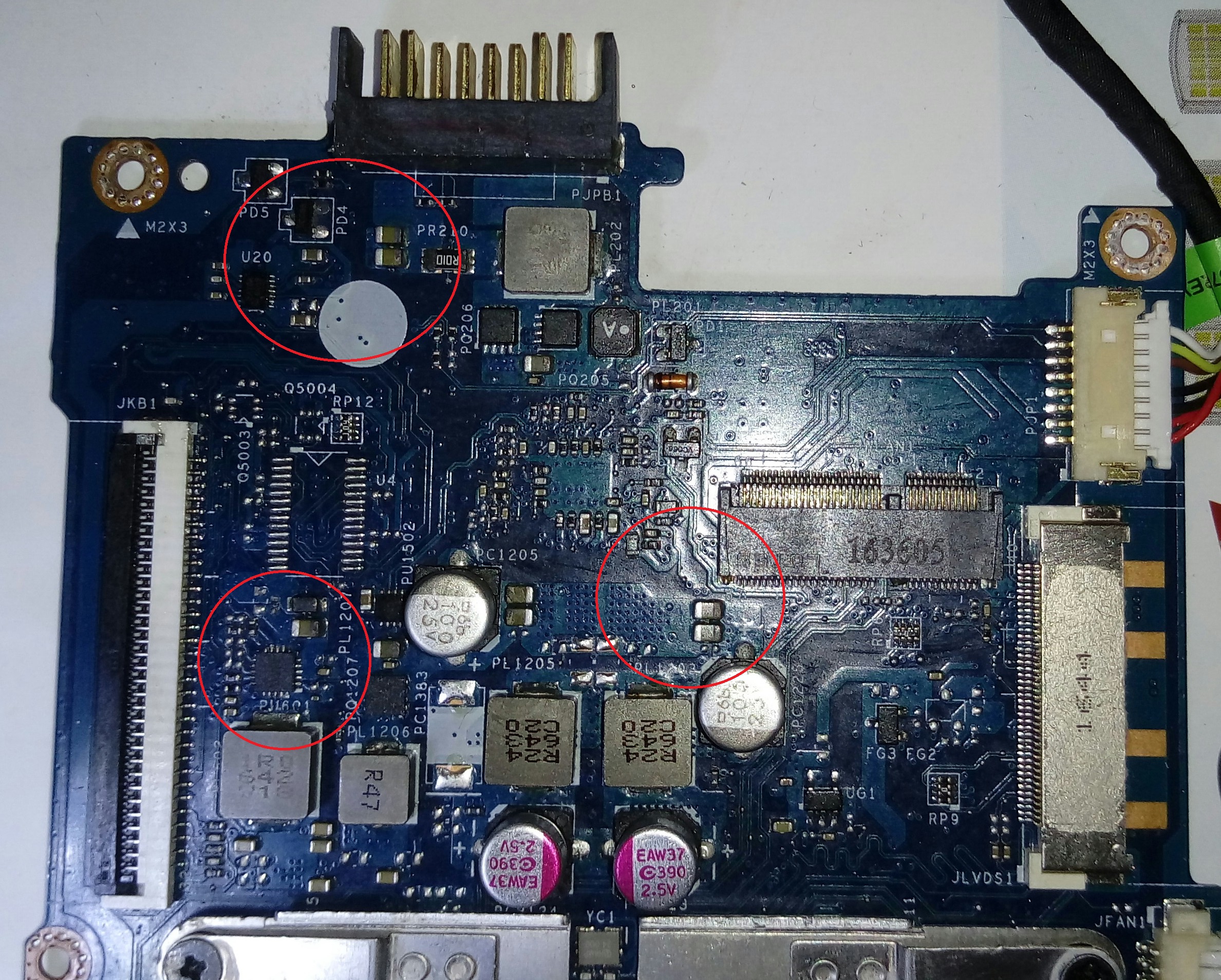

    HP 250 G5/BDL50 LA-D704P Rev 4.0 Water damage
    Hi
    I have this notebook with liquid damage (see picture).
    After cleaning the marked areas notebook turns on when pressing the power button and the fan spins for about 8 seconds and stops then, but the display does not come on.
    The battery charges when it is attached (LED turns orange), but won´t start from battery.
    When on these coils have:
    PL202 = 16,81v
    PL602 = 1,021v
    PL1206 = 0v
    PL1205 = 0v
    PL1203 = 0v
    PL11 = 1,209v
    PL9 = 3,385v
    PL8 = 5,08v
    I only have the schematics for BDL50 LA-D704P Rev 3.0 so i am kind of lost.
    Can anybody give a little help?
