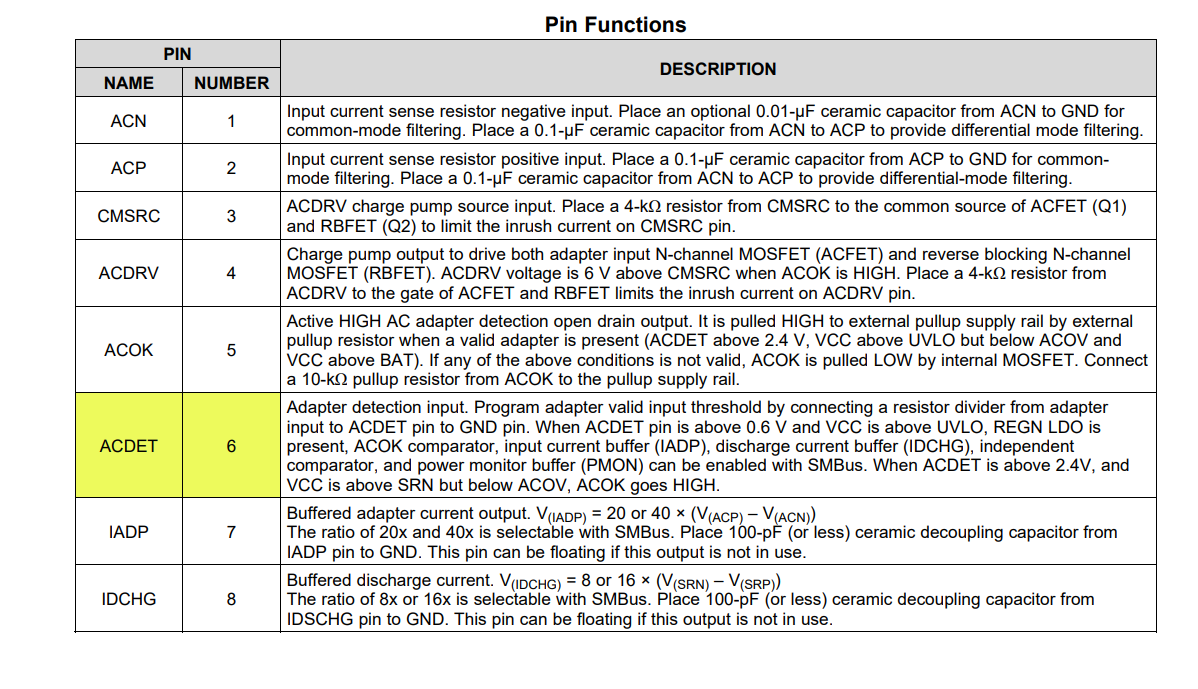

    1) Link or post schematic if available.
    2) ACDET is too low. Only if ACDET is > +2v4 will the ACOK go high. Post the current voltage reading for ACOK pin.
    3) Next, power down and inspect the resistor voltage divider on that should be +19v on the HIGH resistor. Are the 2 resistor values similar in resistance like the attached ? The TI website has the full datasheet for this component.

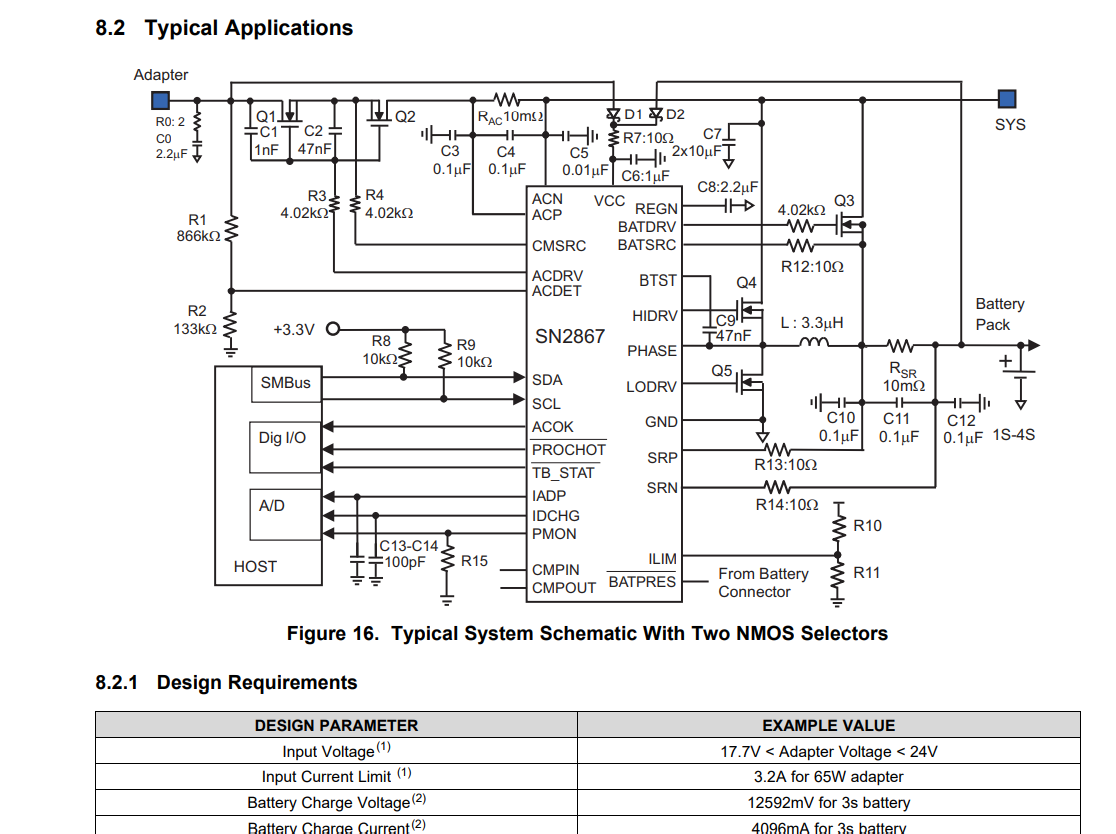

      Re: Lenovo no AC_OK signal no power
      Are you getting +19V on pin5-8 of 1st dc in mosfet?? Gate voltage for same mosfet on pin4??

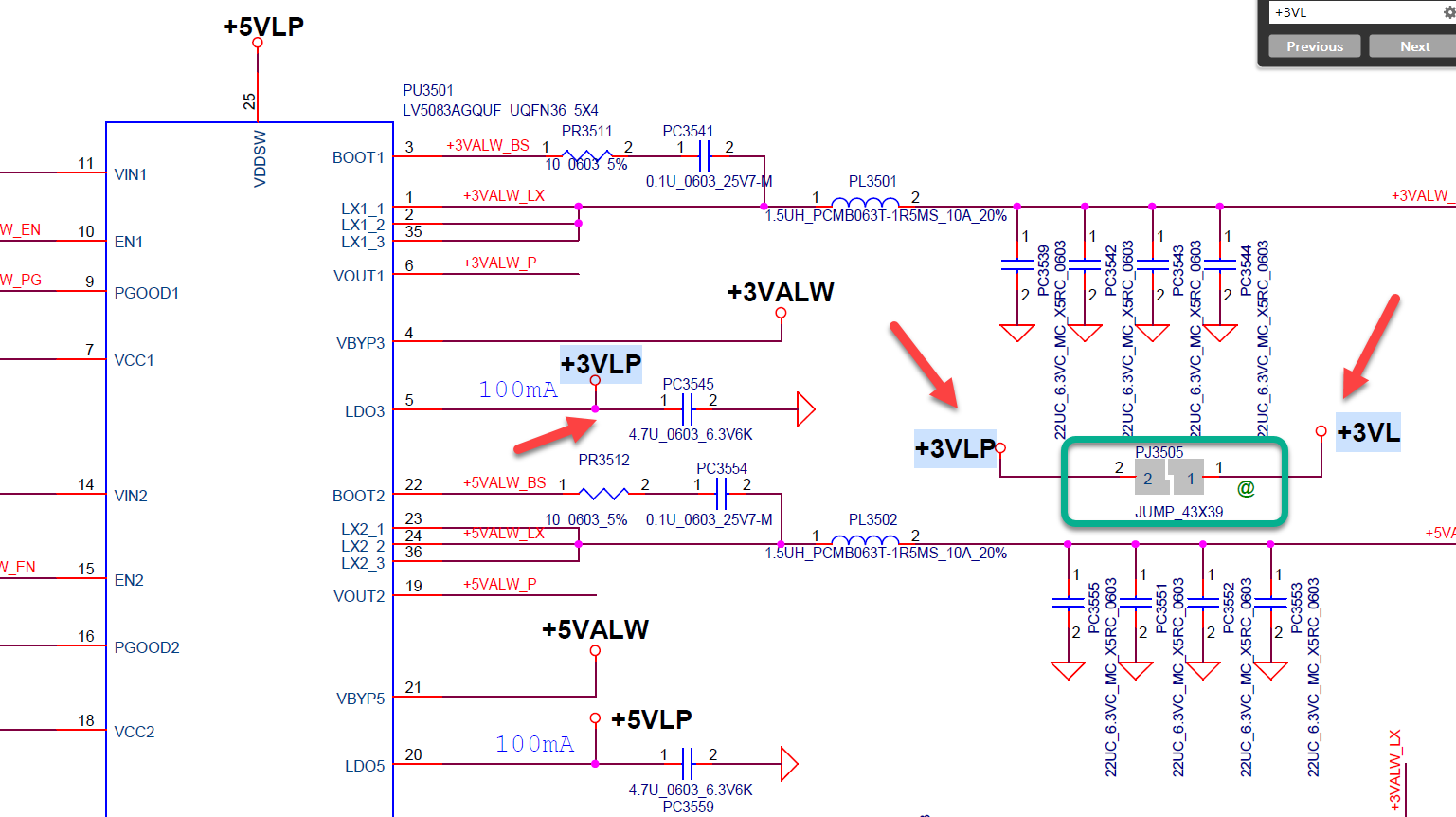

              Re: Lenovo NM-C111 REV 1.0 no AC_OK signal no power
              (PR313) pin 2 has 2.8v
              This is a good voltage for ACDET.
              Q1: What is the voltage on ACOK pin # 5 of PU301 ?
              If ACOK is 0volts, confirm that the pull-up resistor @ RE42 is still present. Post the voltage reading on pin 1 and 2 of RE42 resistor (100k). This resistor is required as the ACOK pin is an open-drain style. This means there is a logic low support for ACOK but NO LOGIC HIGH. The resistor @ RE42 is used to soft-pull up the line to the +3v3 rail for the logic '1' state. Open drain = pin becomes OPEN when it is a 'high' state. Again, a pull-up resistor must be applied on this ACOK line.
              Does RE42, pin #1 read @ +3v3 @ +3VL ?
              +3VL is vital to the proper operation of this logic board so confirm it is there.
              Also confirm that resistor RE74 (0 ohms) is present.
              All this then must lead to the EC chip under ACIN# label.

              Confirm PU3501 (pin #5) is creating the +3VLP rail. Post the voltage reading.
              This +3VLP rail is then used as +3VL after the jumper (solder short) @ PJ3505. Confirm that the +3VL rail is correct at this short jumper short.
                    1) On coil PL3501, what is the voltage on pin # 2 ?
                    2) PR314, pin #1 ? This is the voltage that is required to power the charger IC so that it can function to deliver the V20B+ rail.
                    3) Be sure that the charger IC has been soldered properly in the rework.
                    4) Appears that mosfet PQ312 may be defective but first confirm that the IC is soldered OK and is being powered through PD302 (dual common cathode diode). Pin 28 of PU301 must be a valid power rail to function.
                    Once PU301 is confirmed to be powered, post the voltages on pins 3 & 4 of PU301.
