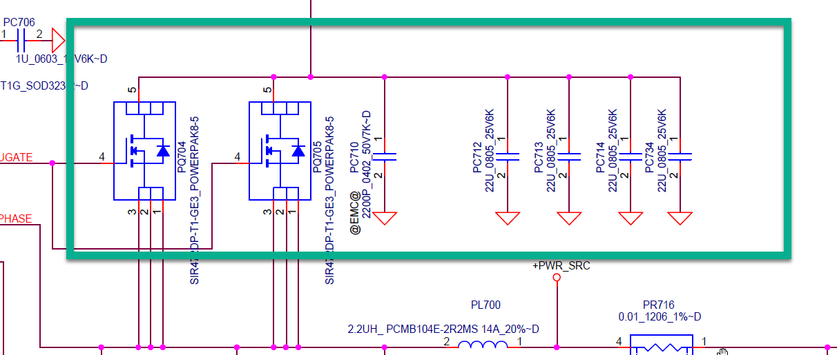

      Re: Dell E6440 shortcircuit
      1) Lift one side of PL701. Do not power up the logic board.
      2) Check if the SOURCE pins of PQ700 & PQ810 are still grounded.
          1) Leave PL701 lifted.
          2) Test for shorts on mosfets PQ704 & PQ705.
          3) Suspecting that your short is from the attached region of the logic board. Inspect each component.
          For the caps, you could quickly remove each and then check if the short is gone or not and then focus on the mosfets.
              Remove the linked caps as per above schematic to see if the short is removed or not.
              If the short is still there AFTER removing the caps, then remove each mosfet.
                You mean PC710 713 714 734 ?
                  Yes. If short is still there, remove PQ704 & PQ705 and check again if it is fixed. Do not power up. Only check for shorts.
                  Have to leave for an hour or so...will check back later. If short is removed, attach the coil and check again.

                            #33
                            1) With PL701 lifted, you are only working with the dual mosfets and the local caps on the same rail.
                            Update - remove / lift one leg of PL700 as well - confirm the short is still there.
                            2) Before you start this next stage of testing - check on the resistance to ground for pin # 4 of the mosfet(s) = connects to pin 18 of the charger IC.
                            3) If you wish to inject a voltage - inject 1V and being a short to ground (or close to) - the part should heat up quickly since it was forcing the power adapter to shut off immediately.
                            At 1V - it should be safe enough.
                            You can dab each of the mosfets and local caps with alcohol and check which area evaporates the fastest - unless you have a thermal camera.

                                #35
                                Excellent !
                                The solder back the lifted part. The laptop should be fine without this part. If you have spares, apply a replacement but will not be a 'show stopper'.
                                Be sure to consider a similar or higher voltage rated part - to be safe. It is a jelly bean part and quite common on other logic boards.
                                0805 non-polarized capacitor @ 22uf (can be a higher capacitance as well) but 25v or higher is recommended.

                                      #38
                                      You are quite welcome.
                                      PC714 guilty on the second MB!
