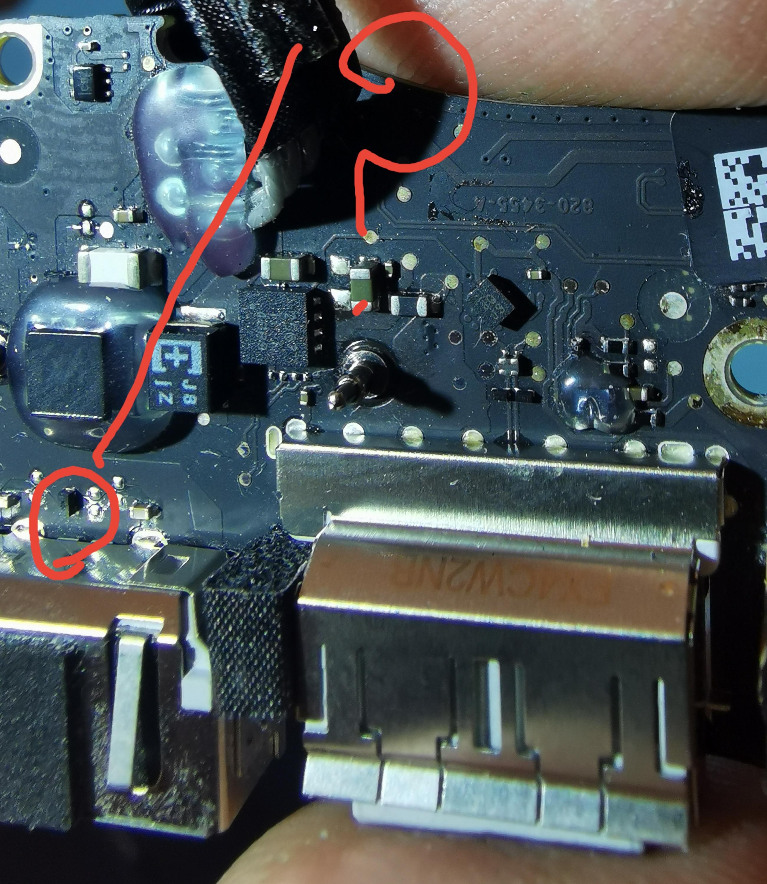

    I've been unable to source any schematics for this (820-3455-A) A1466 (Macbook Air 2013-2015) power/IO daughterboard, and I don't have a replacement on hand.

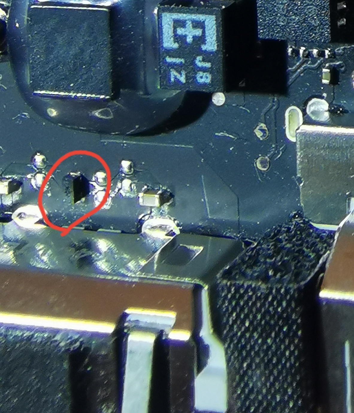

    I've narrowed my issue down to this diode(?) marked in these images, right behind the MagSafe port, but it has a big blow-out crater in it. Could any of you help me identify this part, closely enough that I can source a replacement?

    The part is a no stuff. Just checked it on a local board.

      Refer to 820-3213 schematics.

        Adding the schematic for 820-3213.

          This might be a bit late but, if this is referring to the diode in the picture, it is D6904, a protection diode.

            Can anyone supply me with a link to purchase D6905 5v 10pf SLP1006P2T-SM For 820-3213 I/o board ?

              https://www.digikey.com/en/products/...1TQTCT/4501981
