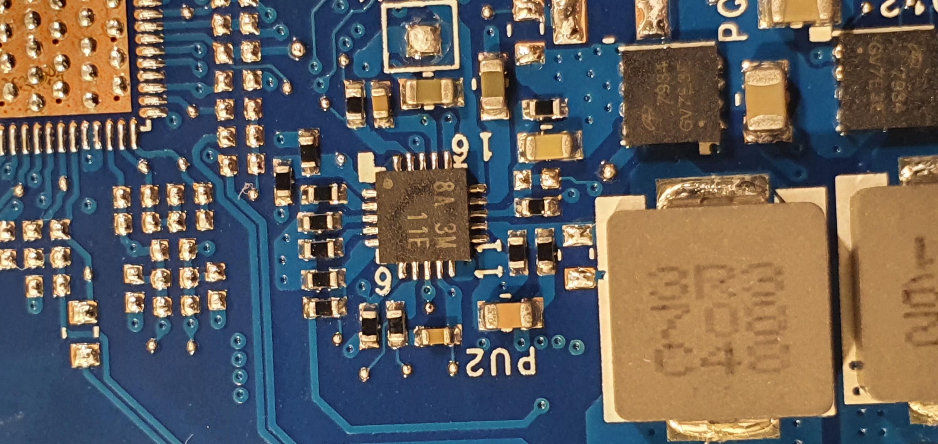

Hp 15 IC identification help
  • Wrightyzere
    • Aug 2021
    • 5
    • Uk
    Hi can anybody point me in the right direction of a replacement for this ic 8a 3m 11e? Can't find any schematics or data To support it? It's from a hp 15 ba005na (mb bdl51 LA-D711P)

    Re: Hp 15 IC identification help
    maybe a RT8243AZQW
      Originally posted by age80
      maybe a RT8243AZQW
      I will ask about and hopefully your right lol. I can't seem to work it out 😖
        I'm sure SMDFlea or someone else will tell you for sure...
          Originally Posted by age80
          maybe a RT8243AZQW
          Agree with the discovery.
          https://www.aliexpress.com/item/3286...5b9f069fba95-1
            top banana appreciated guys thanks a milllion, fingers crossed its a problem solved.
