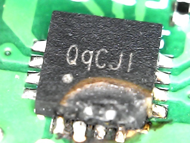

Please help to identify this IC HP 15-dy1002la
  • ruletero
    • Nov 2018
    • 182
    • Mexico
    Hi everyone
    Please help to identify this burned IC, I guess is a DDR4 PWM controller but I didn't find any data about it.
    Brand: HP
    Model: 15-dy1002la
    Motherboard: DA0P5DMB8C0 REV. C
    Thank you for your help

    Re: Please help to identify this IC HP 15-dy1002la
    Originally posted by ruletero
    Hi everyone
    Brand: HP
    Model: 15-dy1002la
    Its a silergy SY8386BRHC https://www.badcaps.net/forum/showpo...1&postcount=12
    There`s no datasheet but you can find a pinout in the LA-H131P schematic ,page 34 PU401 https://www.badcaps.net/forum/showth...light=LA-H131P
      very very thank you!!
