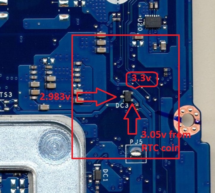

    Hello my friends
    GOT THIS MOTHERBOARD NOT POWER ON : LA-D711P. ans it's AMD
    No schematics/BRD available , when power button trigger only 0.009 amp consumption.
    PQ4 and PQ5 are OK :
    PQ4 = D19v , G= 24.5v and S=19v
    Pq5 = S 19v ; G=24.5 and D= 19v
    No short to ground at any coil, and 0.488v at senser resistor with diode mode.
    Try to get some measurements when button trigger :
    PL7/Pl8 = 3/5 valws present
    PL 602 = 0.948v
    Plm2 = ram voltage=0V... PUM1 = RT8207 = no s5/s3
    U44= KB9022 =
    +3VALW_EC = present
    pin 27 =EC_CLR_CMOS = 1.5v
    pin 113 = Lid_sw = 3.3v
    pin 122 = Pbtn_out = 3.3v
    pin 100 = rsmrst = 1.5 v
    no slp 3/4 , try another bios /ec bios and still the same
    What to check else !!

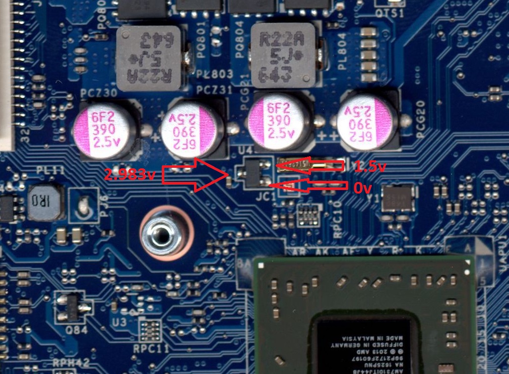

    Check RTC section specially for RTC_RST# and SRTC_RST#.

      Thank you my friend , but without BRD it's so hard to trace it.
      I only find this voltages

        U4 pin voltage is correct. On JC1, you should get 1.5V for RTC to be detected. So RTC seems fine.

          Check EC_RST present or not on SIO.
