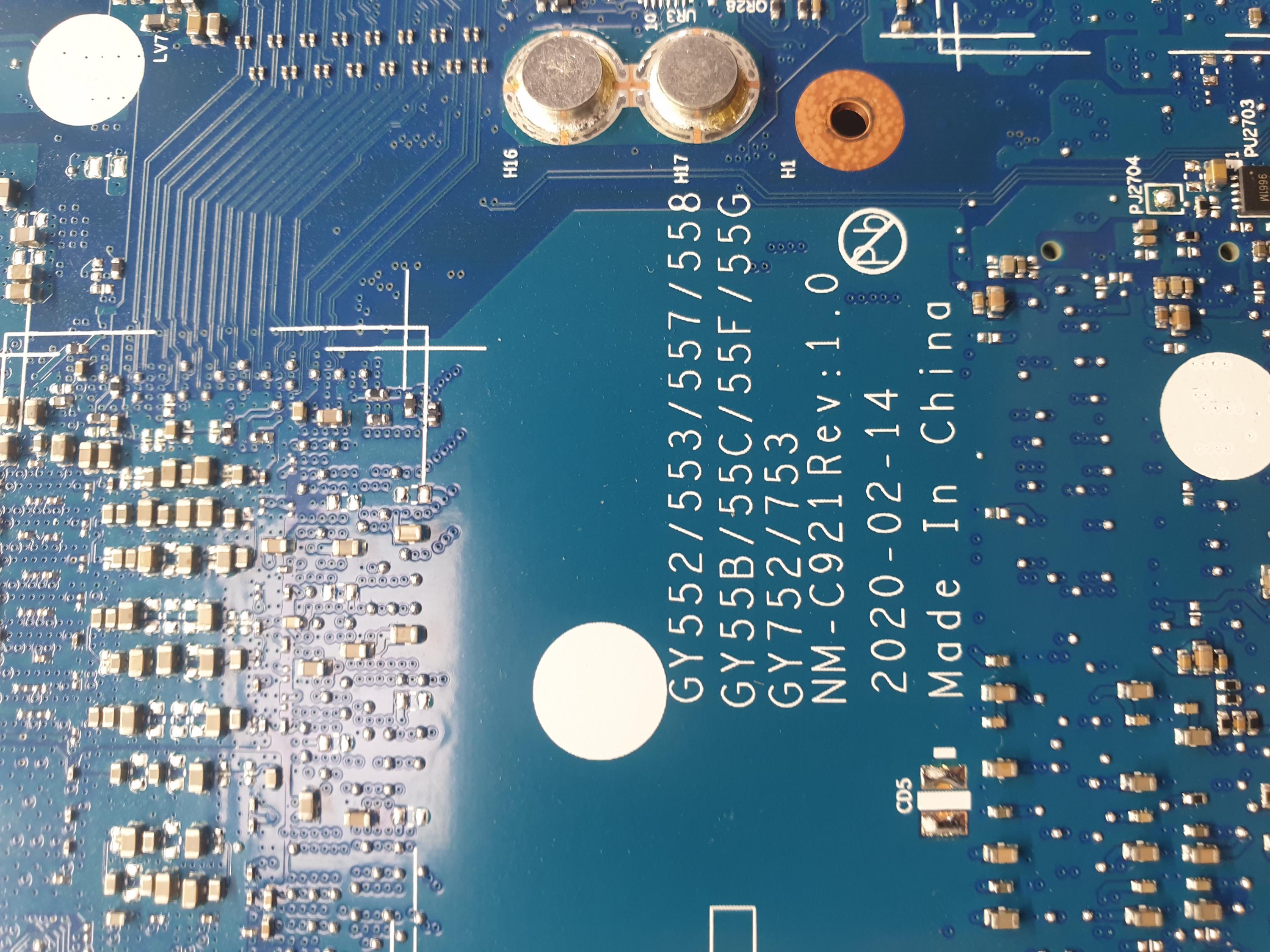

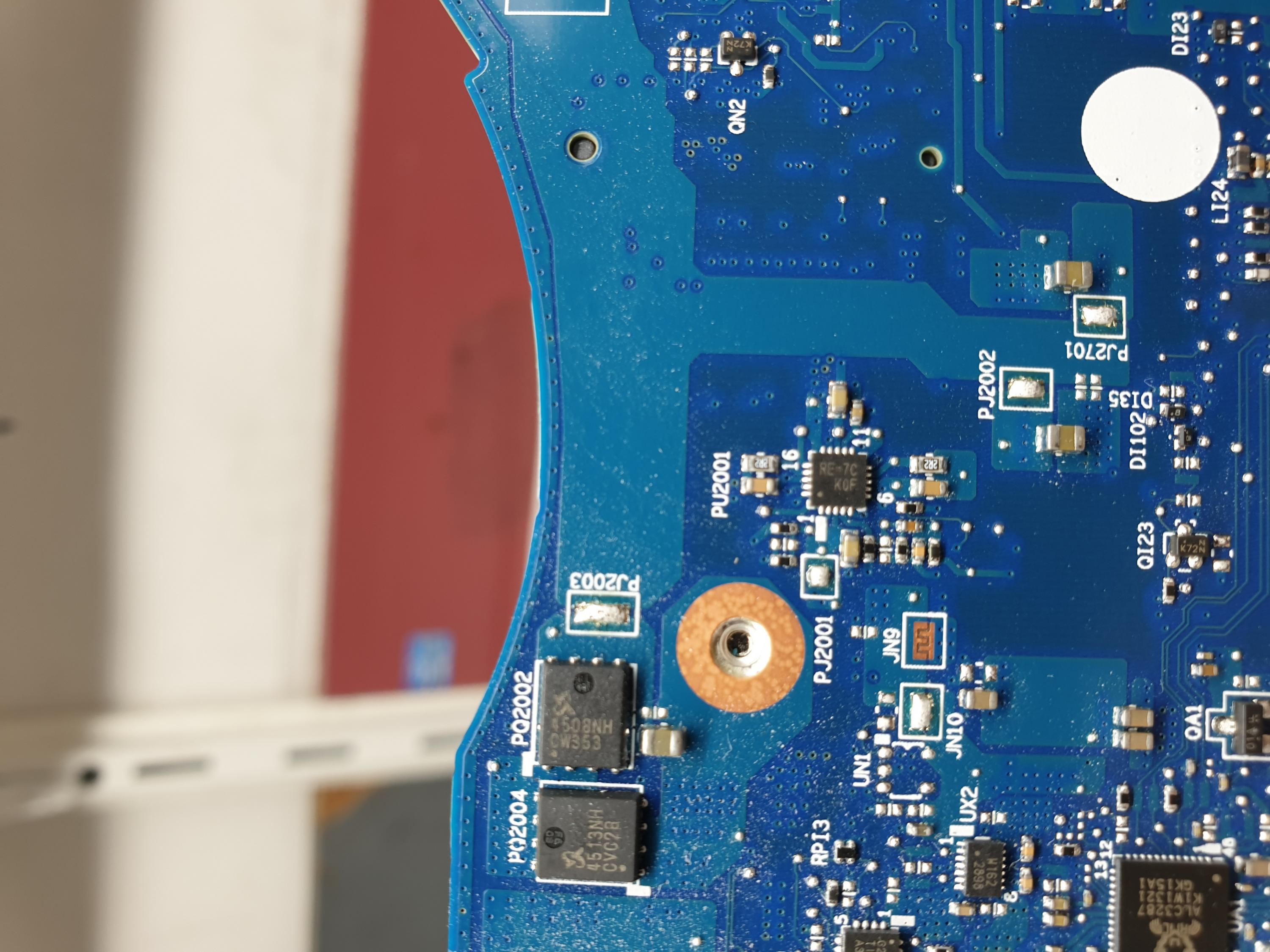

    I need advise.
    customer change a wrong LCD and now laptop not turning on.
    when plugin charger pu2001 IC will very hot. ic marked re=7c k0f
    re=7c k0f ?

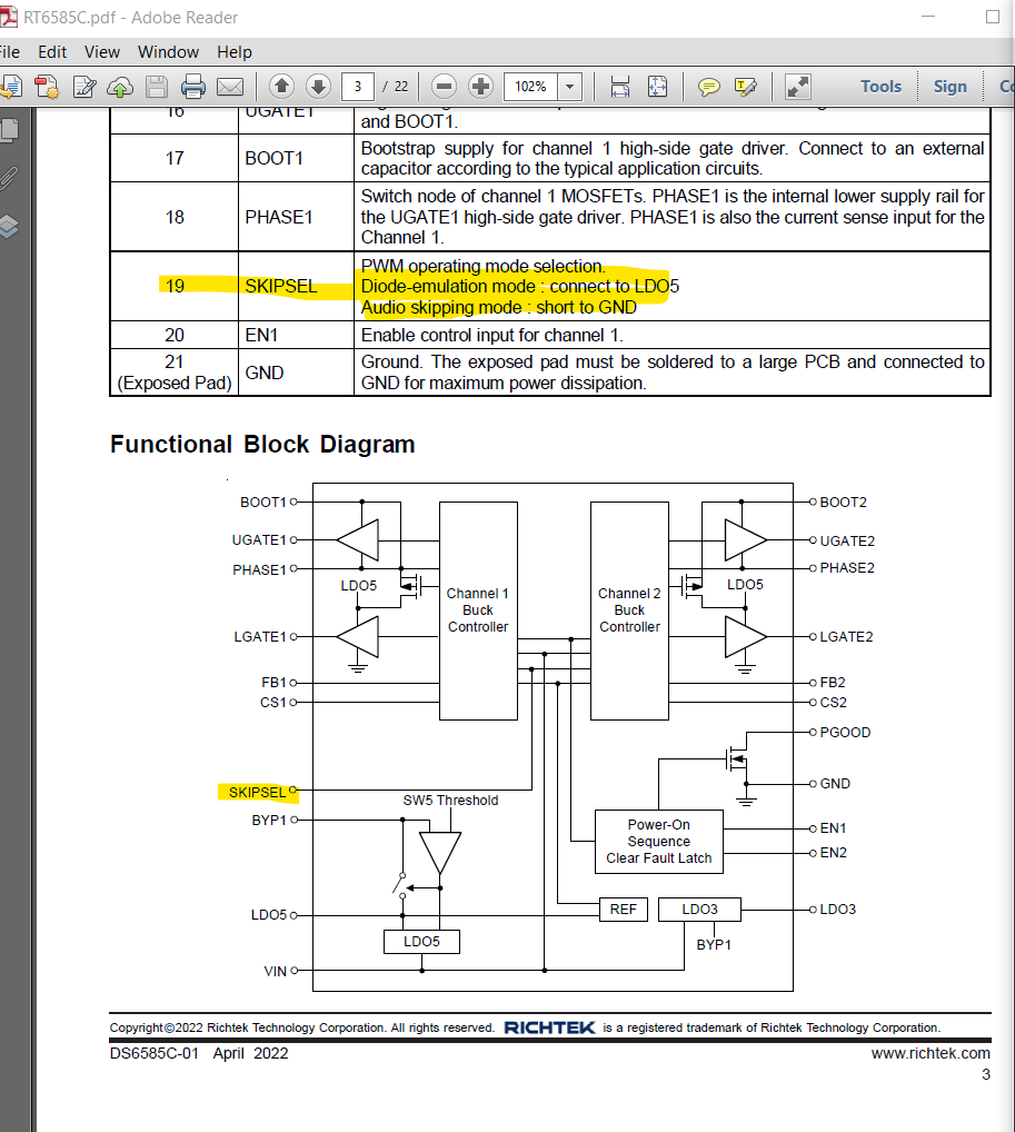

      RT6585B is this ic correct?
        • 22424
        Re: Lenovo nm-921 GY552
        RT6585CGQW
        https://cdn.badcaps-static.com/pdfs/...12ed4d5d14.pdf
          • 22424
          It doesn`t seem to be available to buy yet. You have a few options.
          1. Ask a seller of similar parts on ebay or ali-express if they can source it for you https://www.ebay.com/itm/191992912277 .
          2. Get the IC from a donor board .
          3. Richtek often sell parts that are the same but with different part numbers,check for a pin to pin equivalent by spending hours checking different datasheets .
          4. Check recent compal schematics for the same part.Sometimes an alternative part is mentioned

            as it is 3,3V/5V ic u must check resistance to ground and voltages on 3.3V, 5V, LDO5, LDO3 pins

                KBC to replace, I guess. To be ensured in this do that what wrote ktmmotocross

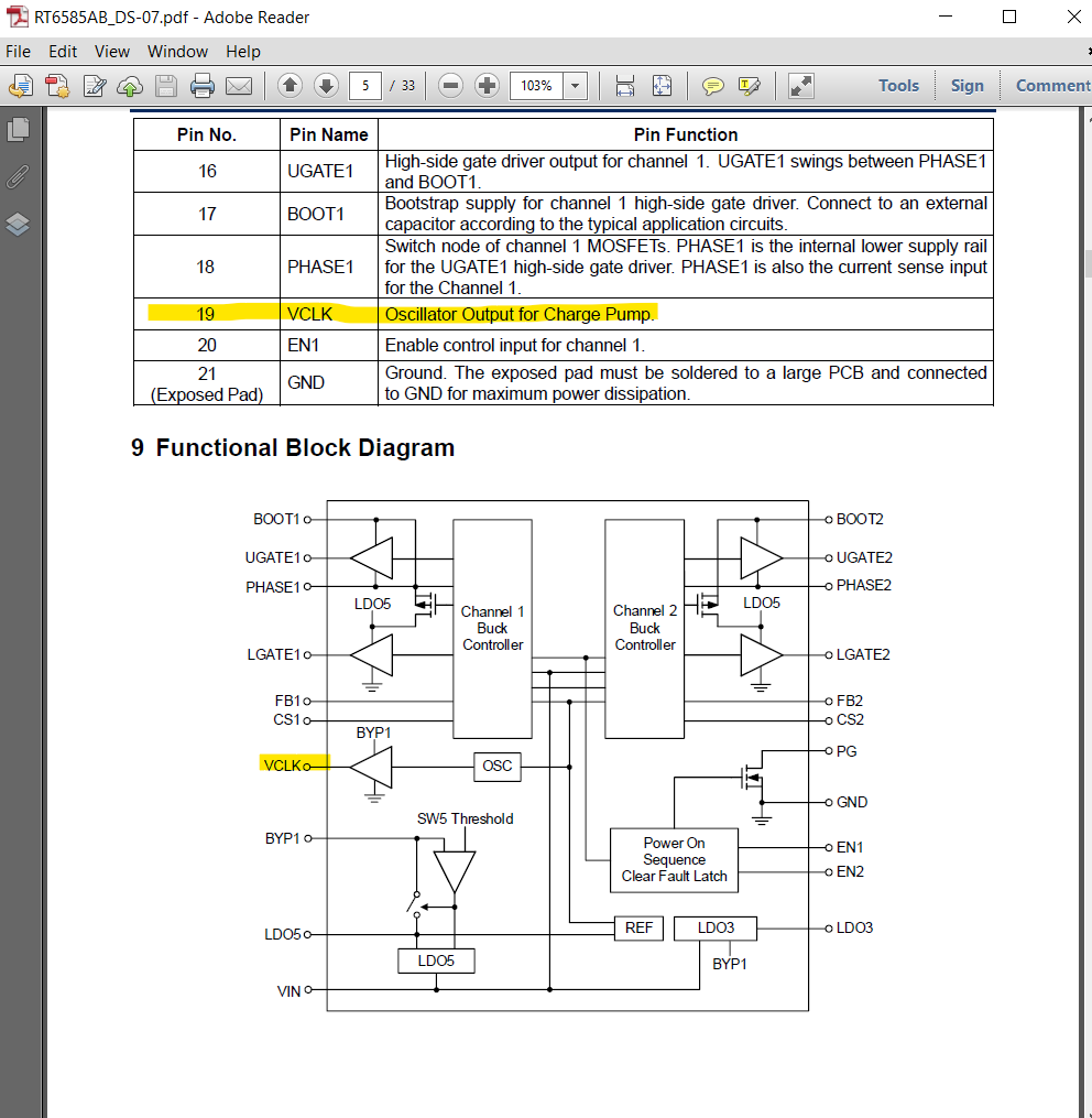

                  RT6585B and RT6585C are equivalent ? Can i replace RT6585C with RT6585B ?
                  • m.maher
                    • 32
                    • egypt
                    I think no because of this difference. Does anyone agree with me?
                    ๐Ÿ‘‡๐Ÿ‘‡๐Ÿ‘‡
                    • mon2
                      • Dec 2019
                      • 14996
                      Pin 19 is different.
                      One is an input.
                      Other is an output.
