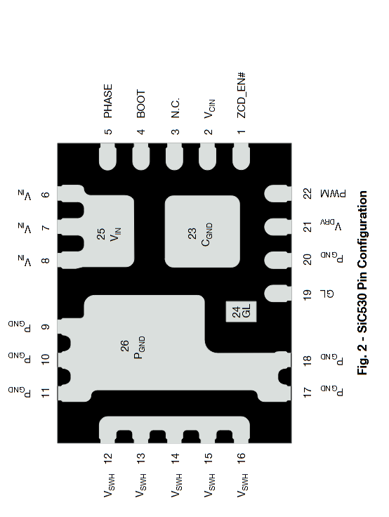

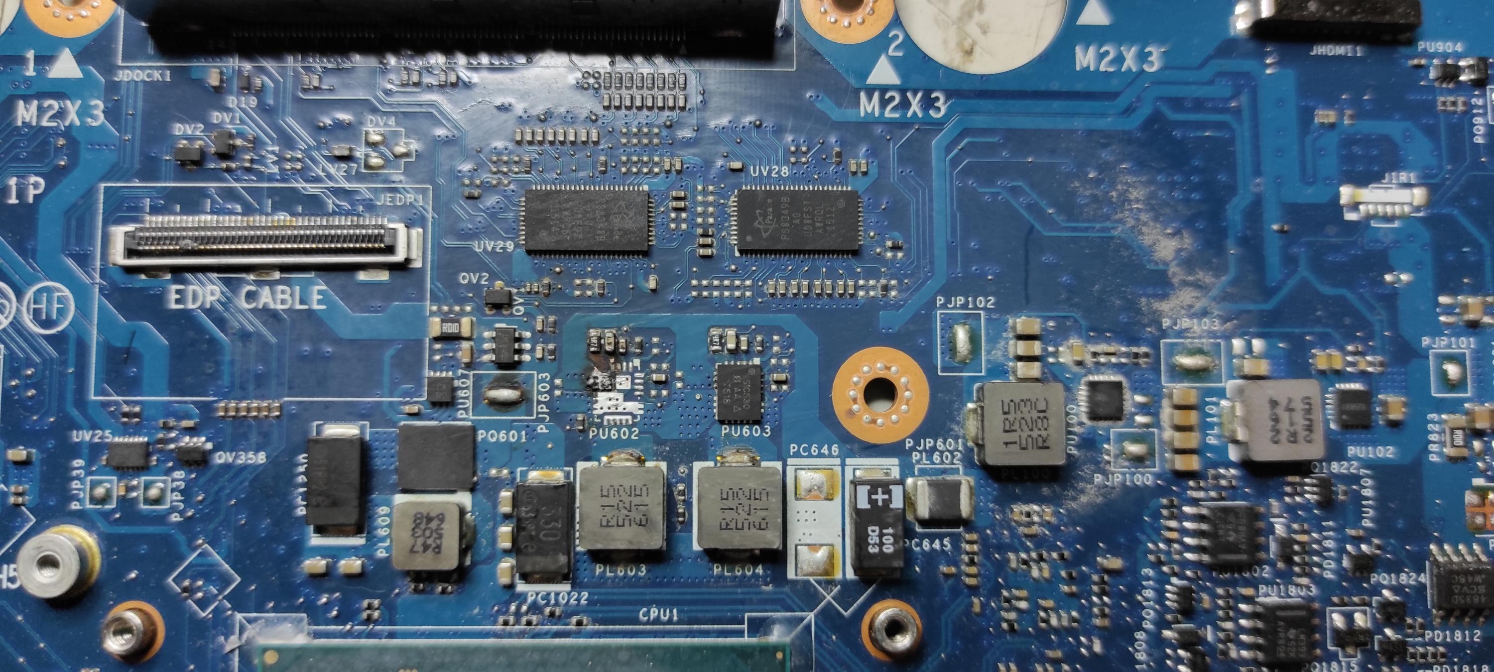

    Hello.
    Got a Dell Precision 3510 dead with burnt SIC530 mosfet.
    Some copper traces are gone from the heat, 6, 7 and 8 pin are the same (Vin) and this is the easy part but it also lost pin 3 (N.C) and i'm not sure if and where i can bridge it.
    I'm not sure if it's worth it our time that's why i ask you first before i order the mosfet.
    Please check schematics and datasheet of SIC530 and let me know.
    Thank you in advance
    schematic https://www.badcaps.net/forum/showth...04#post1053304

              Hello!
              You mean these that i marked in red (attachment)?
              I'll check resistance as soon i return to bench, meanwhile i order the MOSFET (5x just to be sure)

                Re: Dell Precision 3510 completely dead
                Yes. Also, although the other nearby capacitor and resistor looks OK, I would still replace them if possible.
                Check the tracks properly before soldering new parts to make sure they did not break/crack, etc.

                  Hello Spider!
                  Finally the MOSFET lot i ordered is here so i can proceed with this.
                  So the Vin has only 3Ω to ground and full continuity.
                  Should i proceed to rest measures or the problem is here?
                    VIN (pin 6) of PU602 you mean? You are measuring with the IC off, correct? If so, 3ohm is too low and is indicating a short on that line.
                    Remove PL602 and/or PJP601 if present and measure resistance to ground on both sides (pin 1 and pin 2 of PL602).
                    Report back your readings.
                      Yes pin 6, 7 and 8 (the same trace) of PU602, with burnt IC desoldered like in picture.
                      I can confirm left side of PL602/PJP601 (side of MOSFET) is shorted to ground.
                      • Spider1211
                        • Oct 2019
                        • 532
                        • Mauritius
                        6, 7 and 8 of PU602 are not the same. 7 is ground so short to ground here is obvious, pin 8 goes to CPU via PL603 and therefore low resistance is to be expected but pin 6 is VIN and should definitely not be low resistance.
                        Mosfet side (pin 2 of PL602) is around 3ohms, correct? What about pin 1?

                          I measured according to datasheet but propably is reserved?
                                    Remove PJP603 (make sure you clean the pads properly) and measure resistance pin 1 of PL602 again.
                                    • Andreasbest
                                      • Aug 2014
                                      • 1178
                                      • Hellas ( Greece )
                                      with pjp603 removed and cleaned 14.7Ω
                                      • Spider1211
                                        • Oct 2019
                                        • 532
                                        • Mauritius
                                        Something is pulling +PWR_SRC down. From the picture it seems the soot extends to QV1. Try removing it and see if that changes anything. Otherwise you need to check around for damage.
                                        Maybe try disconnecting +PWR_SRC jumpers on different power sections and see if that changes anything.
                                        There is also the issue of low resistance (3ohms as you mentioned) on pin 2 of PL602.
