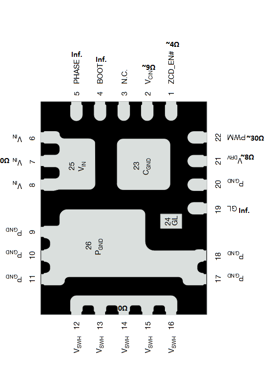

                  To avoid confusion, measure resistance on all pins of PU602 and report back.

                    #29
                    Re: Dell Precision 3510 completely dead
                    Here, measured everything with the ground (except the GND pins)

                                • Spider1211
                                  • Oct 2019
                                  • 532
                                  • Mauritius
                                  #36
                                  What voltage did you apply when finding the short and where did you apply it? You most likely burnt out the short .
                                  What is the resistance value of VSWH?
                                  VSWH goes to +VCC_CORE which is CPU core voltage and therefore having a low resistance is normal.
                                  If you remove PL603 and PL604, you should only read low resistance on pin 1 and 2. Pin 3 and 4 should read open circuit.
                                  • Andreasbest
                                    • Aug 2014
                                    • 1196
                                    • Hellas ( Greece )
                                    #37
                                    Ι applied 1v 1A & 2v 1A, not sure when the short burnt, i noticed it right after 2v 1a.
                                    Vswh resistance to ground is 3.5Ω
                                    Just removed both PL. I'll sent measurements in a few mins

                                    • Andreasbest
                                      • Aug 2014
                                      • 1196
                                      • Hellas ( Greece )
                                      #38
                                      pin1 4.3Ω
                                      pin2 0.5Ω
                                      pin3 NC
                                      pin4 inf.
                                      pin5 inf.
                                      (all measurements before the SMD)
                                      • Spider1211
                                        • Oct 2019
                                        • 532
                                        • Mauritius
                                        #39
                                        This should be fine.
                                        pin1 4.3Ω
                                        pin2 0.5Ω
                                        pin3 NC
                                        pin4 inf.
                                        pin5 inf.
                                        Where were those measurements taken? PU602/PU603? What do you mean by 'before SMD'?
                                        Pin 1 and 2 does not look good. Pin 2 (assuming you meant VCIN of PU602/603) is indicating a short on +5V_RUN and pin 1 (ZCD_EN#) could be due to a faulty PU601. Try removing PU601 and measure again.
                                        I was referring to pin 1,2,3 and 4 of PL603/604 by the way.

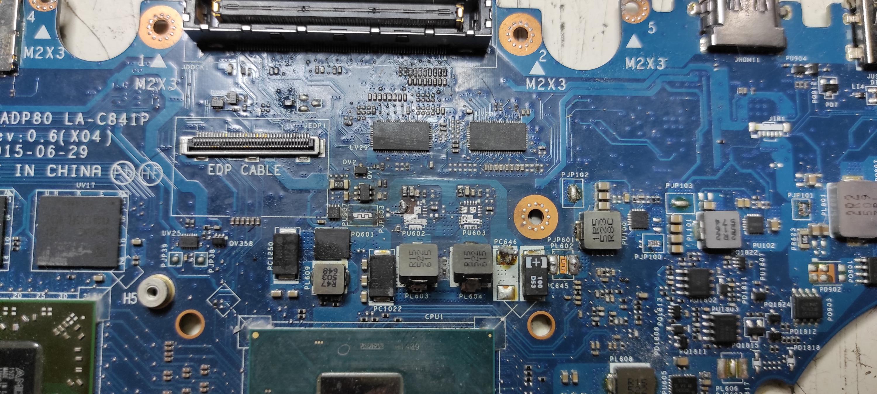

                                          measurements taken on PU602, one probe on the side towards MB (not side towards burnt PU602) and the other on GND.
                                          For some strange reason i can't find PU601 (please check attachment)
                                          PL603 and PL604 have only 2 pins.
