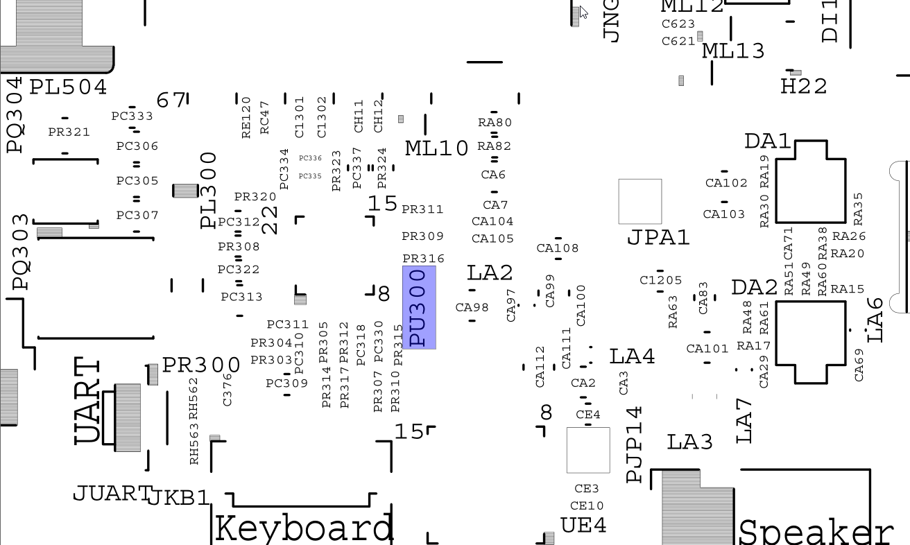

La-c881p
  • riki_22
    replied
    Re: La-c881p
    Originally posted by riki_22
    PQ305 in Ohms is OL in D-S-G
    PR320 where can i find it?
    what do you think if i try to replace
    - PU300 BQ24777
    - PD300 SDMK0340L
    - PQ303 SIR472DP
    - PQ304 SI7716ADN
    Leave a comment:
  • riki_22
    replied
    Re: La-c881p
    Originally posted by Sephir0th
    PQ305 is Open when Battery and Adapter is present, which isn't the correct behaviour Afaik.
    Did you checked PQ305 in Ohms Mode between D-S-G before?
    Actually my primary suspect is either PQ305 or PU300. to be Bad. But Check internal Résistance of PR320 before.
    PQ305 in Ohms is OL in D-S-G
    PR320 where can i find it?
    Last edited by riki_22; 05-25-2021, 10:33 AM.
    Leave a comment:
  • piernov
    replied
    Re: La-c881p
    Originally posted by Sephir0th
    PQ305 is Open when Battery and Adapter is present, which isn't the correct behaviour Afaik.
    No that's expected.
    Leave a comment:
  • Sephir0th
    replied
    Re: La-c881p
    PQ305 is Open when Battery and Adapter is present, which isn't the correct behaviour Afaik.
    Did you checked PQ305 in Ohms Mode between D-S-G before?
    Actually my primary suspect is either PQ305 or PU300. to be Bad. But Check internal Résistance of PR320 before.
    Last edited by Sephir0th; 05-25-2021, 09:21 AM.
    Leave a comment:
  • riki_22
    replied
    Re: La-c881p
    Originally posted by Sephir0th
    I know what you mean, but i had a similar Case before and i was able to solve it (tbh with additional Help from here) with this complete measurement. Funny Part: it was Bad Schottky.
    However you can continue to find the correct replacement for PD300 and May Check the suspected Mosfets again. Also Check all Diodes around the Controller.
    And If this all will still Not work, then i See No other way than have a much deeper Look Into the Circuit.
    battery+adapter
    PIN1 19,6V
    PIN2 19,6V
    PIN3 19,3V
    PIN4 25V
    PIN5 3,2V
    PIN6 2,8V
    PIN7 0V
    PIN8 0v
    PIN9 0v
    PIN10 0v
    PIN11 3,3v
    PIN12 3,3V
    PIN13 0,04V
    PIN14 0V
    PIN15 0V
    PIN16 5,3V
    PIN17 7,8V
    PIN18 0V
    PIN19 7,8V
    PIN20 7,8V
    PIN21 5,3V
    PIN22 0V
    PIN23 0,3V
    PIN24 5,3V
    PIN25 8,8V
    PIN26 8,3V
    PIN27 6,7V
    PIN28 19,6V
    I also made the measurements of pq303 and pq305 and also of pu300 what do you think now?
    Last edited by riki_22; 05-25-2021, 02:49 AM.
    Leave a comment:
  • riki_22
    replied
    Re: La-c881p
    Originally posted by Sephir0th
    1) I'm still Not convinced that PQ303 is fine and i still don't know anything about the condition of PQ305.
    2) Clock and Data Voltages are a Bit lower when Adapter is present. But can't say this could be an issue. Also the 1.5V at BATPRES# seems a Bit too Low for me.
    3) REGN measures usually more or less exactly 6V
    4) Never saw ILIM Voltage above 1.X Volt, but couldn't mean anything.
    PQ303 with adapter
    D 19.6V
    S 3.2V
    G 3.6V
    PQ303 with Battery
    D 7.4V
    S 7.5V
    G 7.4V
    PQ303 battery and adapter
    D 19.6V
    S 7.5V
    G 8V
    PQ305 Battery and adapter
    D 7.4V
    S 7.5V
    G 0.005V
    PQ305 with Battery
    D 7.5V
    S 7.5V
    G 0.3V
    PQ305 with adapter
    D 2.5V
    S 3.2V
    G 3.2V
    Leave a comment:
  • Sephir0th
    replied
    Re: La-c881p
    1) I'm still Not convinced that PQ303 is fine and i still don't know anything about the condition of PQ305.
    2) Clock and Data Voltages are a Bit lower when Adapter is present. But can't say this could be an issue. Also the 1.5V at BATPRES# seems a Bit too Low for me.
    3) REGN measures usually more or less exactly 6V
    4) Never saw ILIM Voltage above 1.X Volt, but couldn't mean anything.
    Last edited by Sephir0th; 05-24-2021, 11:44 AM.
    Leave a comment:
  • riki_22
    replied
    Re: La-c881p
    Only adapter
    PIN1 19,6V
    PIN2 19,6V
    PIN3 19,3V
    PIN4 25V
    PIN5 3,2V
    PIN6 2,8V
    PIN7 0V
    PIN8 0v
    PIN9 0v
    PIN10 0v
    PIN11 1,5v
    PIN12 1,5V
    PIN13 0,18V
    PIN14 0V
    PIN15 1,5V
    PIN16 5,3V
    PIN17 0V
    PIN18 3,2V
    PIN19 3,2V
    PIN20 3,2V
    PIN21 5,3V
    PIN22 0V
    PIN23 0,35V
    PIN24 5,3V
    PIN25 5,8V
    PIN26 3,6V
    PIN27 3,2V
    PIN28 19,6V
    Only Battery
    PIN1 7,1V
    PIN2 7,1V
    PIN3 0V
    PIN4 0V
    PIN5 0V
    PIN6 0V
    PIN7 0V
    PIN8 0,18v
    PIN9 0,04v
    PIN10 1v
    PIN11 2,8v
    PIN12 2,8v
    PIN13 0v
    PIN14 0v
    PIN15 0v
    PIN16 5,3v
    PIN17 7,5v
    PIN18 0,32v
    PIN19 7,5v
    PIN20 7,5v
    PIN21 5,3v
    PIN22 0v
    PIN23 0v
    PIN24 5,3v
    PIN25 7,2v
    PIN26 7,3v
    PIN27 7,4v
    PIN28 6,9v
    what do you think about it?
    Last edited by piernov; 05-24-2021, 10:32 AM. Reason: double post
    Leave a comment:
  • Sephir0th
    replied
    Re: La-c881p
    I know what you mean, but i had a similar Case before and i was able to solve it (tbh with additional Help from here) with this complete measurement. Funny Part: it was Bad Schottky.
    However you can continue to find the correct replacement for PD300 and May Check the suspected Mosfets again. Also Check all Diodes around the Controller.
    And If this all will still Not work, then i See No other way than have a much deeper Look Into the Circuit.
    Last edited by Sephir0th; 05-24-2021, 08:55 AM.
    Leave a comment:
  • riki_22
    replied
    Re: La-c881p
    Originally posted by Sephir0th
    Right, PR303 and PR304 are Just Pads, No component there. but i don't think the issue is there. Never Heard about a failed Current Resistor.
    I believe we need a complete measurement of PU300 Résistance to GND, and Voltage (Only Battery/Only Adapter/both present) to See what is going on there.
    A complete D-S-G Résistance measurement of PQ305 could be also helpful
    making all these measurements will take me time, I just wanted to remind you that instead of pd300 I didn't put anything, and I wanted to clarify that I tried to make the bridge and in pd300 it turns on but as soon as I insert the battery the power supply is shorted, so according to me I have to find the right component to install in pd300. i have already tried RB501V-40 but with this it does not turn on.
    Leave a comment:
  • riki_22
    replied
    Re: La-c881p
    Originally posted by mon2
    Pl300 p1 3.12 and P2 3.12
    Are these readings correct ?
    PL300 (P1) should be the same voltage value AFTER PR300. Confirm it.
    sorry friend
    I had inverted the measurements between pl 300 and pl301.
    with certainty the correct measurements are:
    in pl301 p1 3.2V and p2 3.2V
    in pl300 p1 19.6V and p2 19.6V
    Leave a comment:
  • mon2
    replied
    Re: La-c881p
    Originally posted by riki_22
    i checked the voltage at the end of pr300 and they are the same as the power supply input, i can't find pr303 and pr304 to verify what you say
    Pl300 p1 3.12 and P2 3.12
    Are these readings correct ?
    PL300 (P1) should be the same voltage value AFTER PR300. Confirm it.
    Also, see attached for the resistor locations.
    Last edited by mon2; 05-24-2021, 07:38 AM.
    Leave a comment:
  • Sephir0th
    replied
    Re: La-c881p
    Right, PR303 and PR304 are Just Pads, No component there. but i don't think the issue is there. Never Heard about a failed Current Resistor.
    I believe we need a complete measurement of PU300 Résistance to GND, and Voltage (Only Battery/Only Adapter/both present) to See what is going on there.
    A complete D-S-G Résistance measurement of PQ305 could be also helpful
    Last edited by Sephir0th; 05-24-2021, 07:35 AM.
    Leave a comment:
  • riki_22
    replied
    Re: La-c881p
    Originally posted by mon2
    You have a fault at pr300, current sense resistor. Review the voltage before and after this component. It must be very close to the adapter in voltage. This part may need to be replaced.
    Consider to carefully remove pr303 and pr304 then check the voltage through the current sense resistor again. Does the voltage reading match the adapter voltage? If not, pr300 is damaged.
    See and review attached partial schematic.
    @ 1 - voltage must match the adapter DCIN value.
    @ 4 - voltage should be very close to the adapter DCIN value. From your post, this voltage @ 4 is 3v12 ?? If yes, then the charger IC is noting a very large voltage drop and shutting this component down. That is, approx 19VIN is dropping to 3v12 which is too much of a load for this switching IC to enable.
    You can remove the above mentioned resistors and then check again @1 and @ 4.
    Also inspect this SMD current sense resistor for damage. Power all down and check the resistance from @1 and @4 points.
    i checked the voltage at the end of pr300 and they are the same as the power supply input, i can't find pr303 and pr304 to verify what you say
    Leave a comment:
  • mon2
    replied
    Re: La-c881p
    You have a fault at pr300, current sense resistor. Review the voltage before and after this component. It must be very close to the adapter in voltage. This part may need to be replaced.
    Consider to carefully remove pr303 and pr304 then check the voltage through the current sense resistor again. Does the voltage reading match the adapter voltage? If not, pr300 is damaged.
    See and review attached partial schematic.
    @ 1 - voltage must match the adapter DCIN value.
    @ 4 - voltage should be very close to the adapter DCIN value. From your post, this voltage @ 4 is 3v12 ?? If yes, then the charger IC is noting a very large voltage drop and shutting this component down. That is, approx 19VIN is dropping to 3v12 which is too much of a load for this switching IC to enable.
    You can remove the above mentioned resistors and then check again @1 and @ 4.
    Also inspect this SMD current sense resistor for damage. Power all down and check the resistance from @1 and @4 points.
    Last edited by mon2; 05-24-2021, 07:20 AM.
    Leave a comment:
  • riki_22
    replied
    Re: La-c881p
    Originally posted by piernov
    Voltage from battery goes through PQ305 & PQ303 body diode to reach VCC pin of charger IC.
    PD300 should be replaced first, not much point troubleshooting further if parts are missing.
    You need a Schottky diode of at least 30V reverse voltage and 30mA forward current and the same package. So yes RB501V-40 should be good instead of SDMK0340L
    Note that it's possible there is a secondary problem and PD300 will burn again, so keep a few aside in case. It's also possible it's the only problem and replacing it will solve it.
    Hi i Just try the RB501-V40 but mainboard not Power with Adapter what measurements can i take to find the problem?
    rb501-v40 for me is not good because it does not turn on even with the battery alone
    Last edited by riki_22; 05-24-2021, 07:01 AM.
    Leave a comment:
  • riki_22
    replied
    Re: La-c881p
    Originally posted by mon2
    Remove battery. Connect adapter.
    1) voltage on pin 6 (acdet; pu300) ?
    2) voltage on pin 17 (pu300) ?
    3) voltage on pin 1, pl300? Pin 2, pl300?
    4) pl301, pin 1? Pin 2?
    5) confirm the nearby diodes are ok (power removed, meter in diode mode). Should conduct in one direction, block in the other).
    6) pin 15 voltage of pu300 with adapter only?
    Pu300 with Adapter
    P6 3.2v
    P17 0v
    P15 1.72v
    Pl301 p1 3.12 and P2 3.12
    Pl300 p1 19.6 and P2 19.6
    The diode work ok not shortly
    Last edited by riki_22; 05-24-2021, 07:36 AM.
    Leave a comment:
  • piernov
    replied
    Re: La-c881p
    Voltage from battery goes through PQ305 & PQ303 body diode to reach VCC pin of charger IC.
    PD300 should be replaced first, not much point troubleshooting further if parts are missing.
    You need a Schottky diode of at least 30V reverse voltage and 30mA forward current and the same package. So yes RB501V-40 should be good instead of SDMK0340L
    Note that it's possible there is a secondary problem and PD300 will burn again, so keep a few aside in case. It's also possible it's the only problem and replacing it will solve it.
    Last edited by piernov; 05-24-2021, 06:39 AM.
    Leave a comment:
  • riki_22
    replied
    Re: La-c881p
    Originally posted by Sephir0th
    Voltages of PQ303 D - G - S when Only Adapter and Only Battery is present?
    Only Adapter in PQ303 D 19.6V S 3.2V G 3.6V
    Only Battery in PQ303 D 7.06V S 7.44V G 7.33V
    Leave a comment:
  • mon2
    replied
    Re: La-c881p
    Remove battery. Connect adapter.
    1) voltage on pin 6 (acdet; pu300) ?
    2) voltage on pin 17 (pu300) ?
    3) voltage on pin 1, pl300? Pin 2, pl300?
    4) pl301, pin 1? Pin 2?
    5) confirm the nearby diodes are ok (power removed, meter in diode mode). Should conduct in one direction, block in the other).
    6) pin 15 voltage of pu300 with adapter only?
    Leave a comment:
    by sam_sam_sam
    03-31-2024, 02:12 PM
  • hillbillybubba
    XPS 13 9360 - Is it possible to directly charge the battery, at the connector, with adjustable power supply?
    by hillbillybubba
    I see the positive and negative wires on the connector, but will it even allow a charge without the other connectors doing whatever communication it is that they do?
    I'm well-versed in battery charging, just not laptop batteries. (I'm a lithium battery reseller)
    Laptop became unresponsive while in storage, battery was in great health the last time I cut it off, but now it's reading zero volts at the connector.
    01-24-2025, 11:01 AM
    by sam_sam_sam
    07-01-2024, 06:34 AM
    DELL XPS 9350 Notebook 13 Specification for Upgrade or Repair
    This specification for the DELL XPS 9350 Notebook can be useful for upgrading or repairing a laptop that is not working. As a community we are working through our specifications to add valuable data like the 9350 boardview and 9350 schematic. Our users have donated over 1 million documents which are being added to the site. This page will be updated soon with additional information. Alternatively you can request additional help from our users directly on the relevant badcaps forum. Please note that we offer no warranties that any specification, datasheet, or download for DELL XPS 9350 Notebook...
    09-06-2024, 07:11 AM
