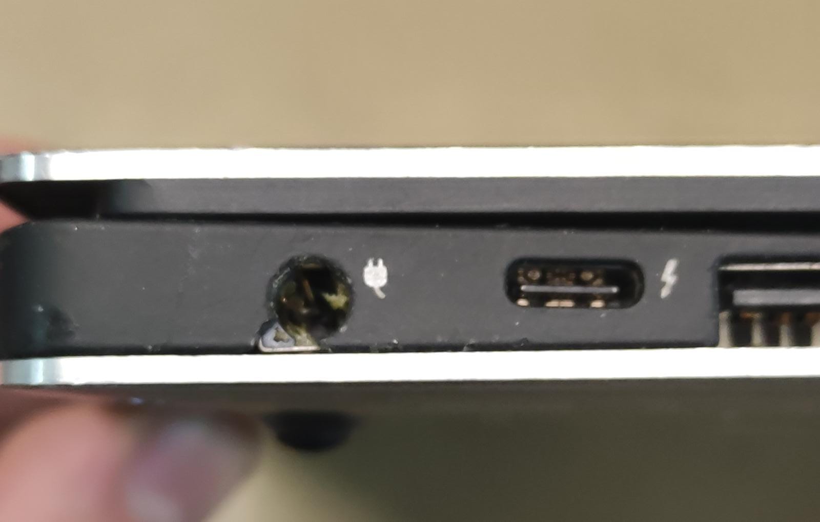

    Hello everybody,
    problem on xps 13 9350 with battery turns on but does not recharge and only with power supply does not turn on.
    i found pd300 burnt.
    because I found the broken connector with the pins that made contact. Removed PD300 E
    fixed the connector
    but i can't solve
    Please help me
    P.S. for me it is a power supply control circuit problem

    I am attaching photos

      This is of course an issue around the charging controller.
      But you replaced PD300 with the correct part, right? Confirm this first!
      Then continue with Voltage measurements at PR300 and PR313 with only Adapter present. Sahre the values. Also check PU300, Pin5 and Pin6 voltage?

        I don't have a double diode to put on the PD300, but if I don't insert the battery nothing really should happen. I still made the measurements PR313 3.2V
        PR300 19.6V
        PU300 P5 3.2V and P6 2.8V
        can you advise me where to get a pd300 i have many donor motherboards

                                        Voltage from battery goes through PQ305 & PQ303 body diode to reach VCC pin of charger IC.
                                        PD300 should be replaced first, not much point troubleshooting further if parts are missing.
                                        You need a Schottky diode of at least 30V reverse voltage and 30mA forward current and the same package. So yes RB501V-40 should be good instead of SDMK0340L
                                        Note that it's possible there is a secondary problem and PD300 will burn again, so keep a few aside in case. It's also possible it's the only problem and replacing it will solve it.
