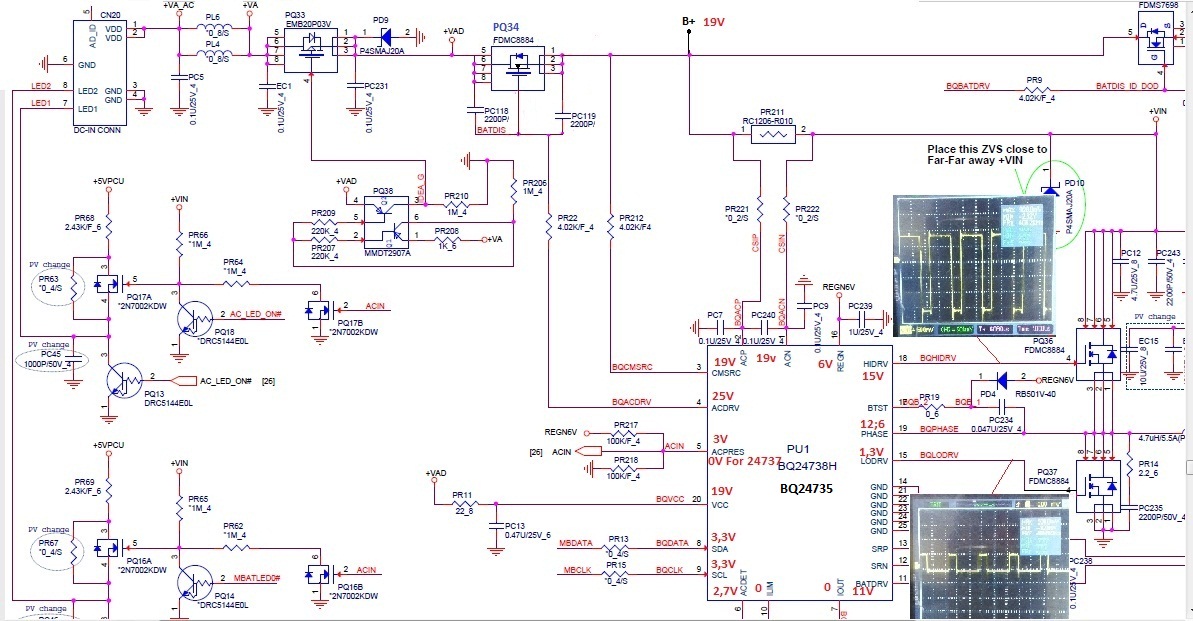

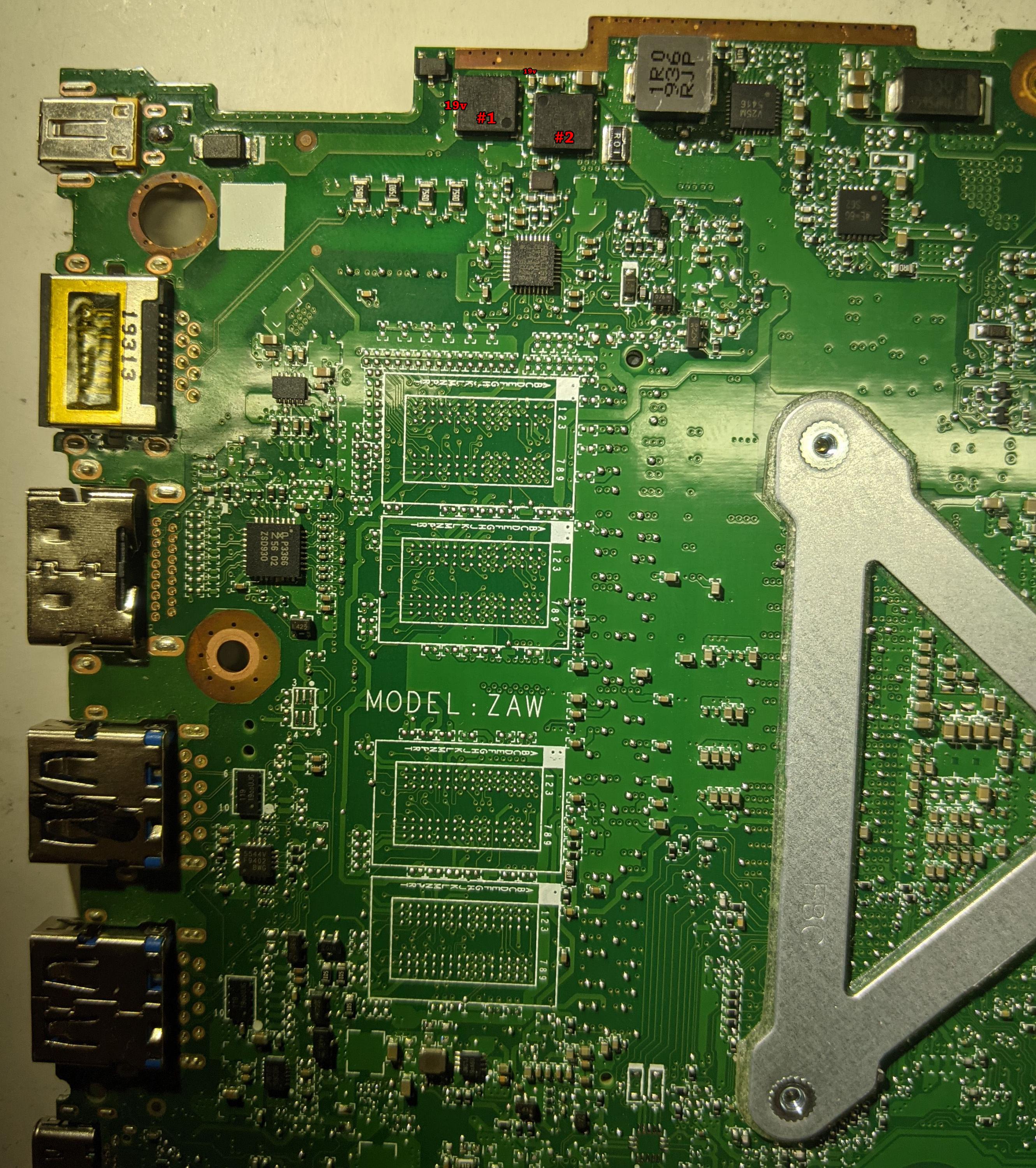

    Acer A515 motherboard, part number DA0ZAWMB8G. Someone tripped over the charging cord and broke the DC jack. Jack has been repaired, but system still doesn't detect charger.
    19V is present on charger pin and drain of #1 mosfet but there is no voltage on the gate and source. There is 19v on a small cap near gate. If battery is plugged in, #2 mosfet measures 10V on drain, nothing on gate.
    Mosfets are AON6414A. Datasheet https://datasheetspdf.com/pdf-file/7...ors/AON6414A/1
    Measuring in diode mode I don't find any short to ground on any of the surrounding caps.
    See attached image.

    measure on the shutresistor (its the one with R01) if there is short to ground

      diagram and sample measurements will help. In order to trigger the N-mosfet at the entrance, it must be 25v at the gate. Check the voltages of the charging chip.

        No short to ground on R01

          Thanks for the schematic. Unfortunately me and schematics = I tracked down the boardview as well but compared to the Mac board views it's so minimal and disorganized it wasn't much help.
          What charging chip are you referring to Sametbey?

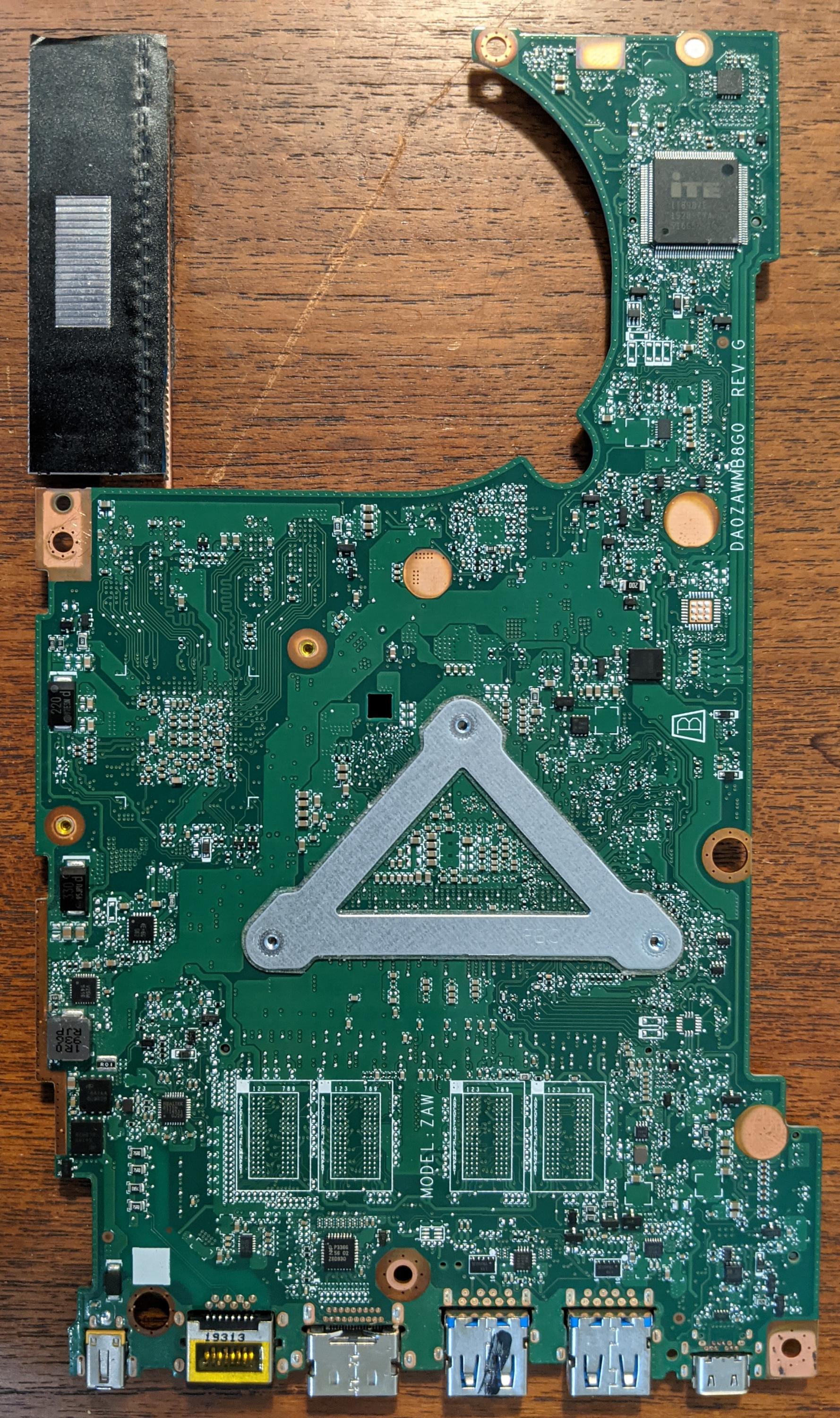

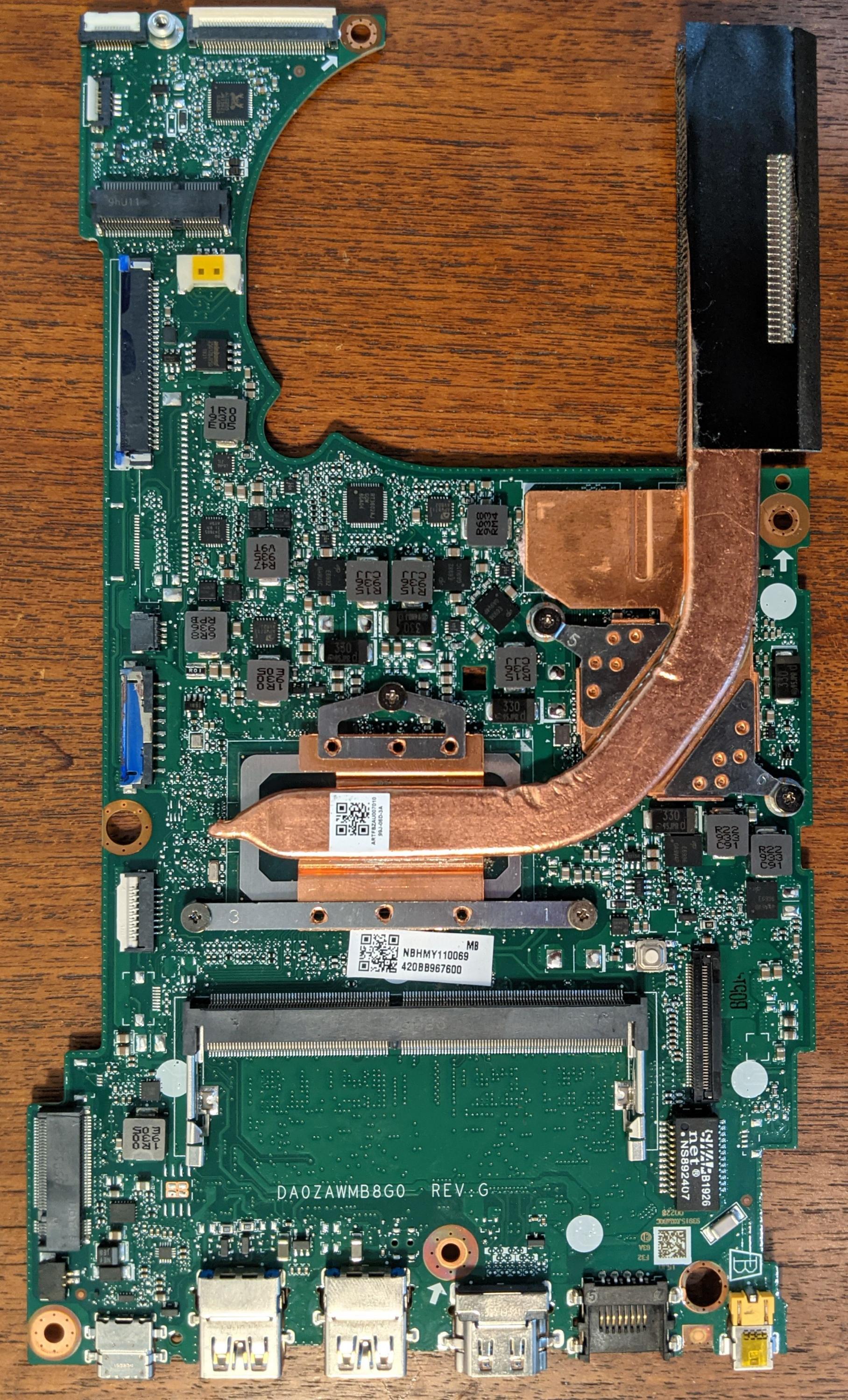

            Here are some full size photos showing the entire board top and bottom.

              Charging IC is a small black square chip and will have "BQ735" written on it like this: https://www.leakymosfet.com/products...735-735-qfn-20
              Find the IC on the board and measure voltage on the following pins and report back:
              1. Pin 20 (Vcc)
              2. Pin 6 (ACDET)
              3. Pin 5 (ACOK)

                You have a broken power connector. It has 3 contacts. ++19 volts /GND and AD_ID. The AD_ID pin is not triggered in the connector. It should short to GND.

                  Your motherboard is a quanta ZAW , i posted the schematic and boardview -

                      No chip labeled BQ735, but I did locate BQ24780S
                      https://cdn.badcaps-static.com/pdfs/...272e9b220d.pdf
                      According to that, VCC is pin 28, ACDET pin 6, and ACOK pin 5.
                      VCC = 19.16V
                      ACDET = 0V
                      ACOK = 0V

                        I was referring to the initial attached schematic. Per new schematic provided by SMDFlea, charger IC is indeed BQ24780s.
                        ACDET should be 2.6V. Check if you have continuity (Ideally from ID pin in charger port) between pin3 (ADP_ID) of adapter input (PJ2) and pin2 of PQ17 . Also measure voltage on pin2 of PQ17 and report back.
                        Since you mentioned tripping over the cable, pretty sure the ADP_ID pin is the issue here.

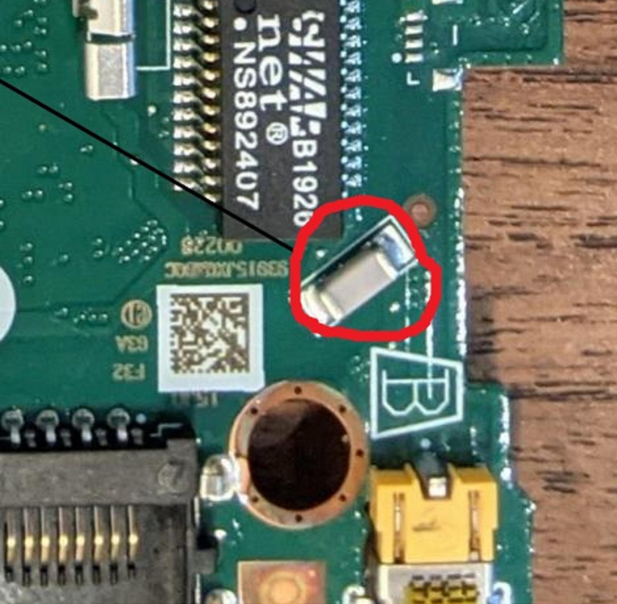

                          I have this board and it's dead. i'm wondering if this large chip near the charging port that circled red in the pic is a fuse. it has no continuity and is shorted to ground on one side

                            No. That is a bulk ceramic capacitor. One side is expected to be to ground.
                            Often, fuses that are surface mounted (like this part) are white in color for the body of the component.
                            For your repair attempt, start with where the logic board is powered. Then check that the power supply is making it from the external power adapter -> to the power connector -> to the mosfets that will enable / disable to charge up the local battery, etc.

                                    it wasn't detecting the charger. I removed pq9 to solve the issue
